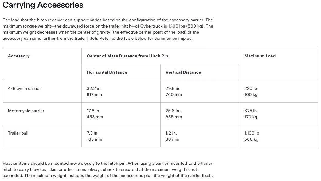

MY experience with weight distributing hitches is that they push the ball location back another 5" behind the standard ball location without weight distribution. Tesla provides an 1,100-pound hitch weight ONLY at 7" from center of hitch pin to center of ball. When I put my weight distributing hitch on my CT, it is 12" from pin to center of the ball. That change DRAMATICALLY reduces the weight rating and increases the leverage factor by a lot. This added "distance" leverage is why Tesla limits the weight of bicycles on a bike carrier to only 220 pounds. I prefer weight distribution too, and used it for years with y 9,500-lb boat trailer, but am afraid to do so with this truck.

However, the spring arms of a weight distribution hitch counter that added torque.
Not necessarily. Many of us set up the weight distributing hitch to eliminate sway, level cornering and reduce impact from bounces, but for neutral effect on tongue weight (no pressure up or down) when pulling straight - so the added 5" of distance rearward from the hitch pin is an actual reduction in the 1,100 maximum hitch weight at the ball - probably reduces it into the range of 700 pounds based on this Tesla owners manual chart and related graphic.
Pushing the center of downward weight back 10.5 inches reduce the hitch rating from 1,100 pounds to 375 pounds, so it seems to me that pushing it back five inches would split the difference, hence somewhere between 700 and 750 pounds max tongue weight rating.
Tesla Cybertruck Cybertruck Trailer Hitch/Casting Failure @10,400 lbs *VERTICAL LOAD* Screenshot 2025-03-17 at 2.13.15 PM
Tesla Cybertruck Cybertruck Trailer Hitch/Casting Failure @10,400 lbs *VERTICAL LOAD* Screenshot 2025-03-17 at 2.13.40 PM
