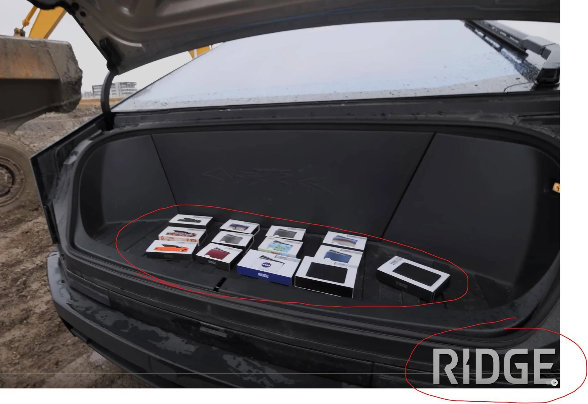

edit: ah, I seem to have found the sponsor of this "scientific test"

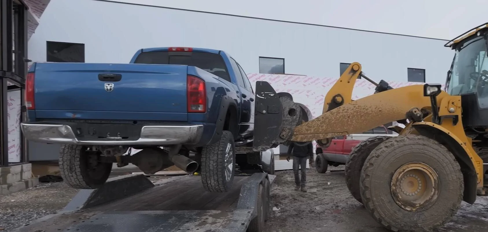

"Where the Cyber truck broke, the Dodge is not not breaking"
Homeboy, this is how you had to get the Dodge to the test bench:
