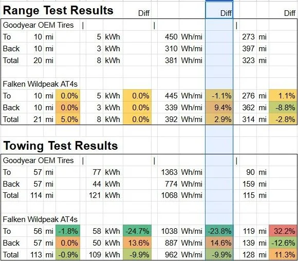

So I recently swapped out the stock Goodyear tires for the more aggressive Falken Wildpeak AT4’s. I was initially worried about the potential range loss since the Falken’s are bigger “beefier” tires. I wanted these tires as I plan to do a lot more off-roading and overlanding with my Cybertruck.
Here are the range test results along with a YouTube video breaking everything. Hope this helps anyone who is looking to get different tires. Thanks
Threw that into a spreadsheet with some conditional formatting.
The towing with the longer distance is more statistically valid but all is rough.

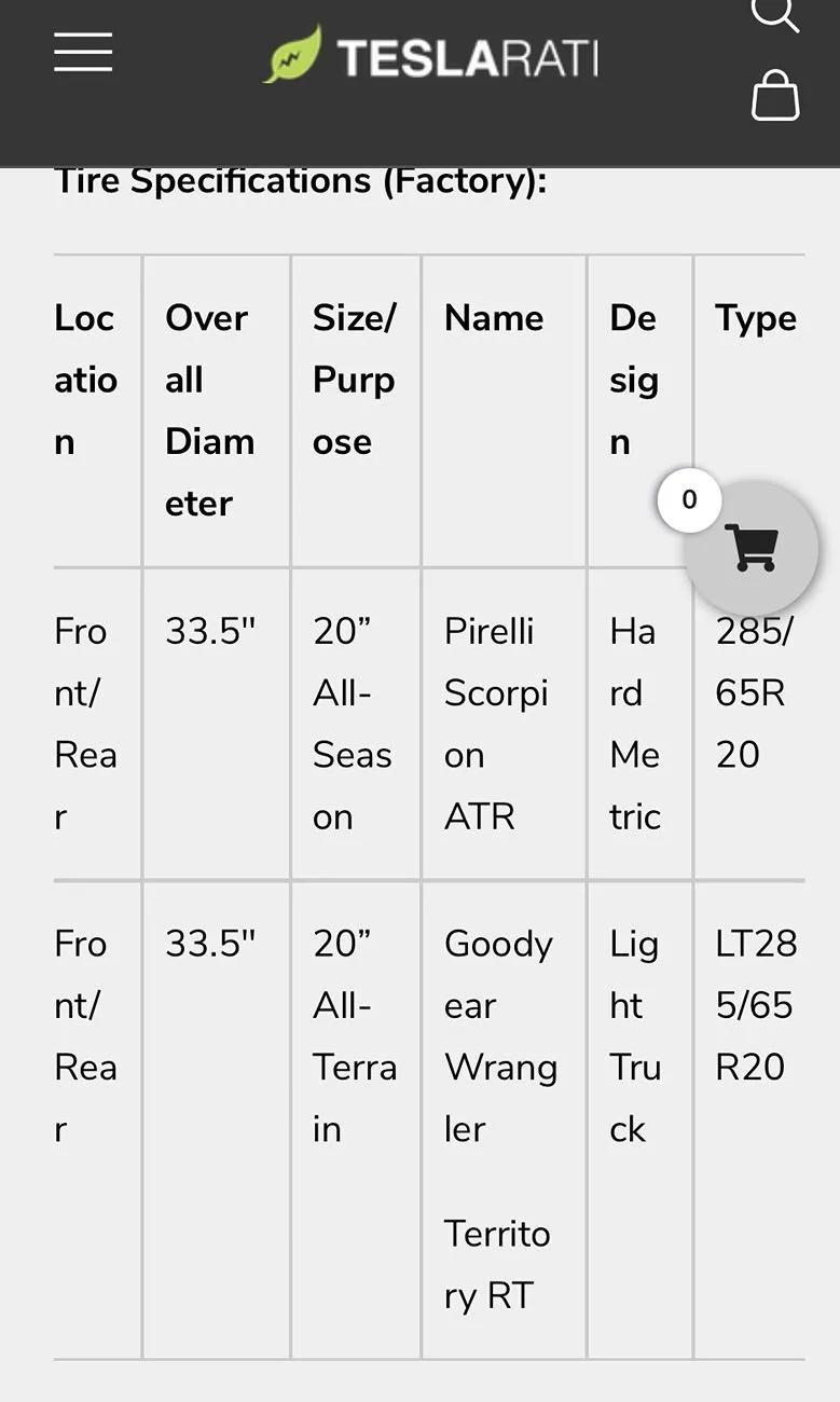

See that’s exactly what I said when they said mine comes with 35” tires and looked up there specs and it says 33.5 but allot of people say the tires are really 34.5. One of the sponsers here offers 295 only with a 18” wheel but offers the 285 in a 20”
Wheel. A guy here has the Nitto 35x12.5/22. And they look great IMO

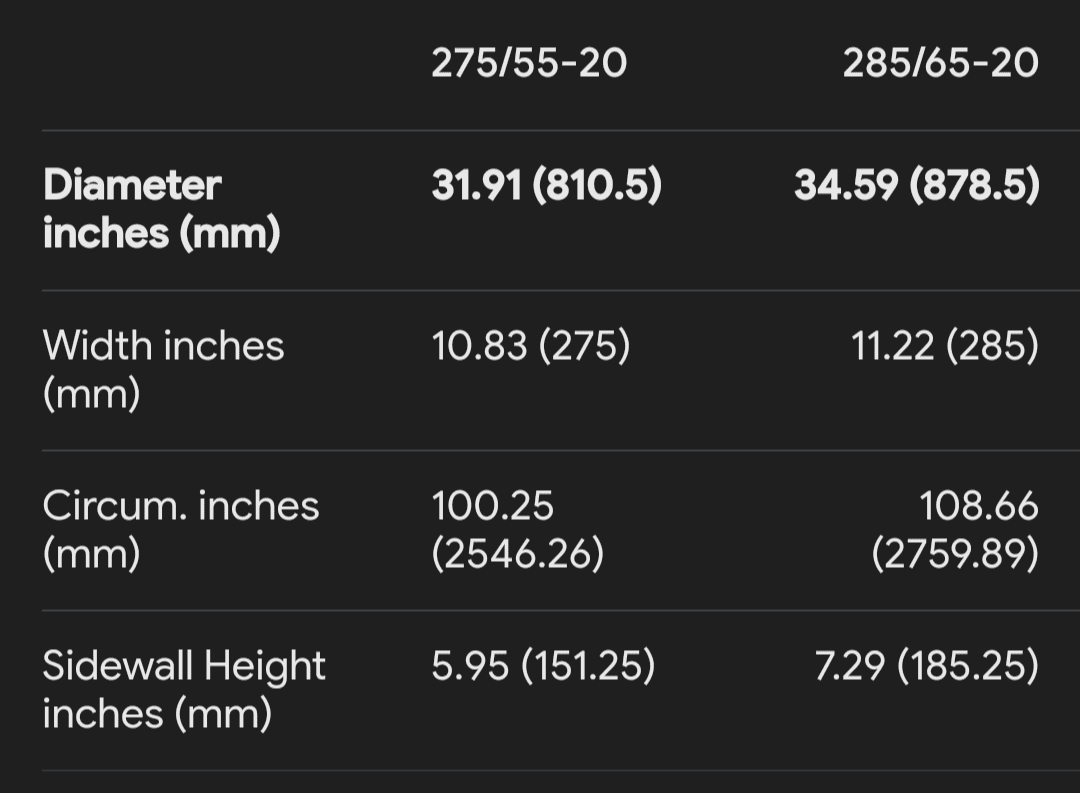

I'm confused, the OEM tires are 285/65r20, that's 2(285*.65)/25.4+20=34.59"
Are you folks saying the tires don't actually measure out to this when new?

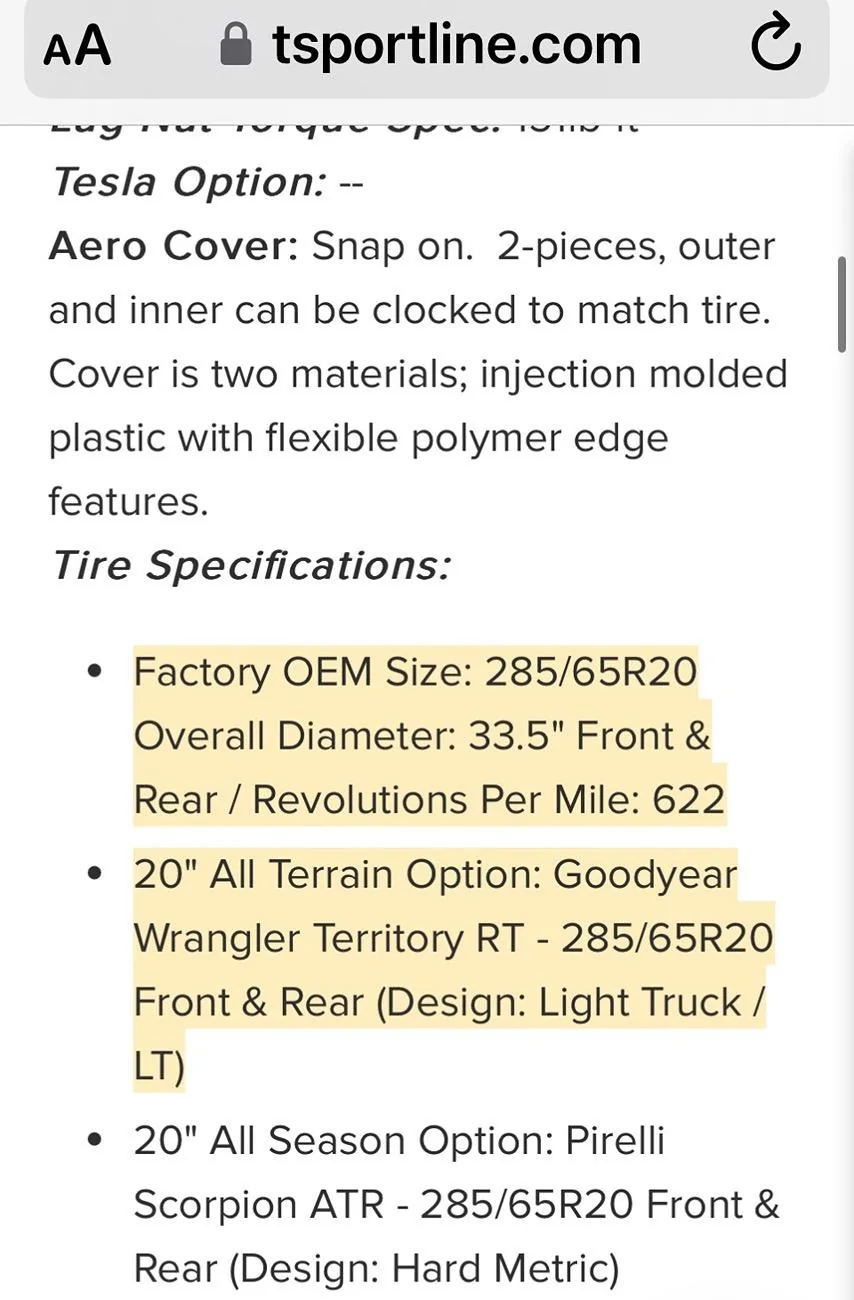

This is what T sportsline says

They need to hire folks that can math ? maybe I can get a job with them?
63360 in/mile ÷ (622 revolutions/mile • π) = wheel diameter in inches
622 revolutions per mile is 32.43". Which doesn't agree with their 33.5" either...
As for 285/65r20. I don't have to do the math, here's a Google chart for total diameter. It also agrees with my math ?‍♂
Tesla Cybertruck Falken Wildpeak AT4 Range Test Results Screenshot_20240907-205020
Either tsportline is just wrong, or Goodyear made the wrong AT tire for all the CTs since Tesla and Goodyear are pretty sure it's a 285/65r20 tire :LOL:

In fairness to Tsportsline this is a graph that’s associated with the cyber truck but yeah it’s super confusing to me ?
