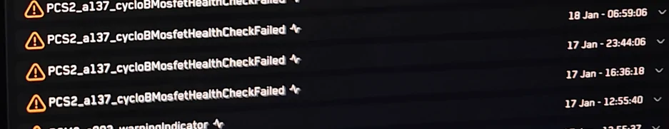

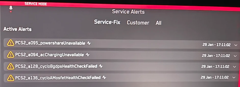

1/17/26 - PCS2_a137 alert. Only charging at 24A on mobile charger.
Service appointment made for 2/4/26.
1/29/26 - PCS2_a094_acCharingUnavailable
1/30/26 - Dropped CT off at service center.
2/6/26 - Service completed! Charging normally now. G-version

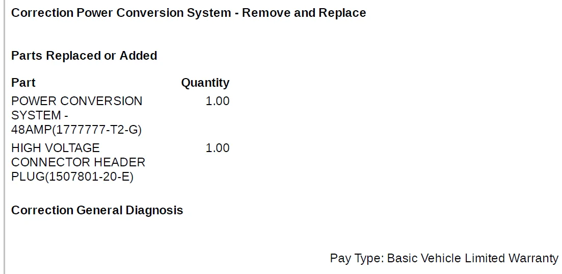

So I posted earlier about a problem I was having going from 24amp charging from my Wall Connector to 48amp charging. The CT would not allow 48amp charging from the WC to the CT.
I notified service and on FEB 20 they replaced:
FERRITE ROUND CABLE FOR HARNESS(2134590-00-A)
POWER CONVERSION SYSTEM -48AMP(1777777-T2-G)
I can now charge @ 48amp from my WC.
Pay Type: Basic Vehicle Limited Warranty
2024 CT born 08/21 delivered 09/11/2024
VIN 031XXX
Error occured: 16,677 mi
Current mileage as of Apr 14, 2026: 17,546 mi

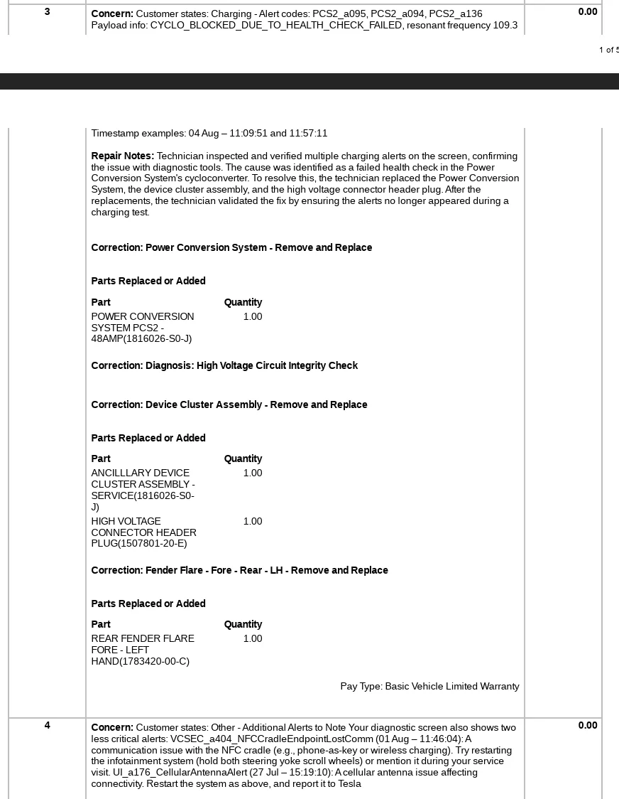

Here is my invoice for my PCS2 replacement. Not sure what version I got. This was done in Aug 2025. VIN: 14xxx 2024 FS AWD CT
capture a message in the app Tesla service telling you what they installed. Looks like Rev J but first time I am seeing J.
Mine shows Rev -G:
POWER CONVERSION PCS 1.00
May 27, 2024
4,697
5,714
Mine shows Rev -G:
I think that's a copy paste error. The same number (1816026-S0-J) is listed under Ancillary Device Cluster which is what that part number links to in Tesla's parts catalog.
PCS number in EPC is still -G.
