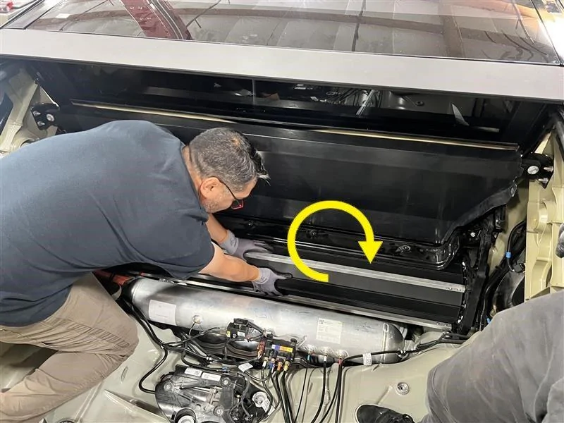

does opening the aero flap give you any additional access to see down there? I don't have mine yet to check, but from the Basecamp videos I've seen, it looks like it might.
I think i know what you mean by the aero flap, but that is when the cover is open i think, where it would possibly be helpful. But i cannot open it as it will damage one or both the iPad/tonneau cover.

Can you send me that video? I’m not sure what you mean.
Check this out, but now that I see it again, it seems that the cover might need to be in the open position to access anything (this seems to be step 1 in the service manual for anything with the cover also)

it CAN be opened. Looking at the service manual is key. The service center should be able to get in there, though someone will have to crawl into the vault to do it…
Tesla Cybertruck Kid dropped iPad down tonneau cover slit. 1713719645247-qm
I’m sure there’s also a way to just remove the tonneau cover by sliding it out over the tailgate. They must be able to do this to replace it or fix any damage.

Thanks, which part of the service manual did you see this?
And we cannot open the cover unfortunately so right, it’s going to either be impossible, or a nightmare.

I wonder if you remove the bed floor if that gives full access to that well.

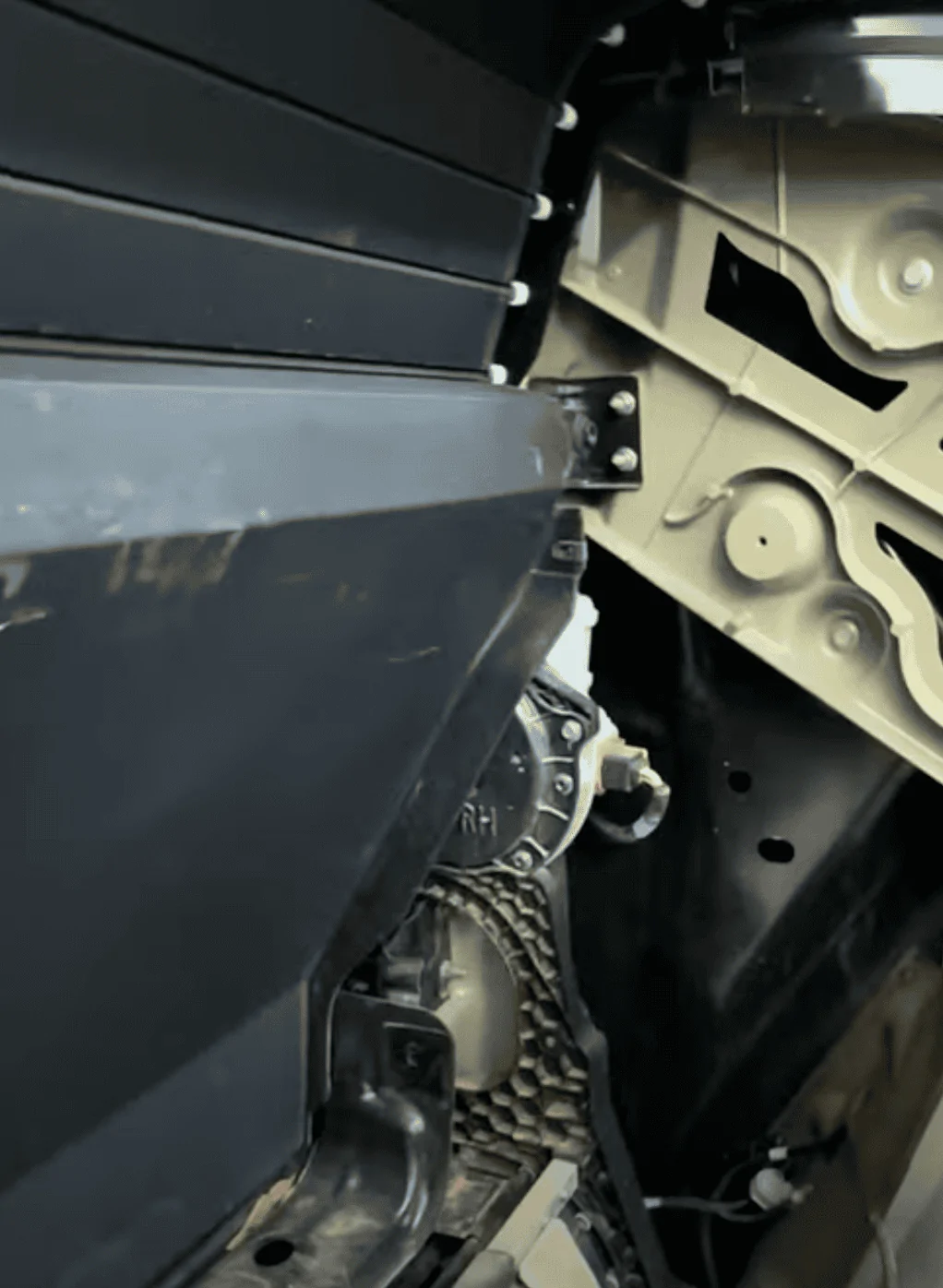

A YouTuber has been doing Cybertruck disassembly videos, including this one where he removed the bed sidewall, and you can see the tonneau mechanism:
Tesla Cybertruck Kid dropped iPad down tonneau cover slit. Screenshot 2024-04-21 at 2.09.08 PM
The honeycomb area at the bottom is where the tonneau coils up, so that would be "down" in pretty much any image.
Looks like the iPad stopped at the bottom bend, so its not too far below the lip. It can be fished out, but I doubt grabbers or magnets will be strong enough, you'll need tape or something sticky.
