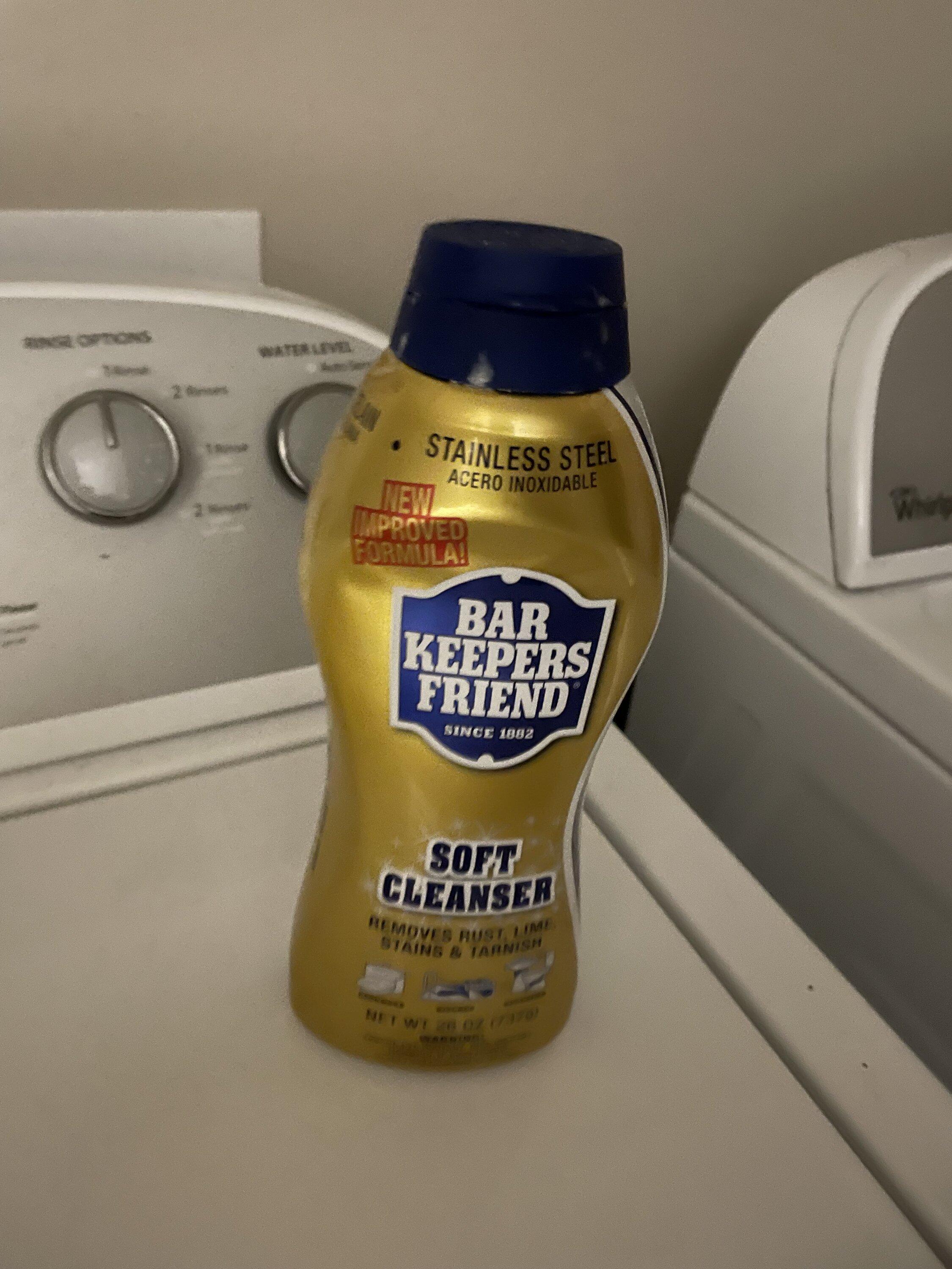

OP: Just a piece of advice: You should follow the instructions on the BKF package:
Soft Cleanser
How to use BKF Soft Cleanser
  • Shake well before using.
  • Squeeze BKF onto wet surface or damp sponge.
  • Rub onto soiled surface.
  • Rinse thoroughly within one minute of application.
  • Wipe surface dry.
A Word of Caution about BKF
Because our Soft Cleanser is acidic and contains polishing compounds, BKF may etch or dull delicate surfaces. Before applying to fiberglass, plastics, anodized aluminum or brushed metal surfaces, such as appliance exteriors, test in a small, hidden area first.
https://www.barkeepersfriend.com.au/how-to-use/
I wouldn’t use Windex to wash the acidic BKF away. I know there’s been a YouTuber who doesn’t even own a Cybertruck recommending that, but I wouldn’t do that to my DeLorean. I would want to neutralize the acid in the BKF right away which is what the rinsing ( with water) does. That’s how I use it. I don’t use Windex on the car either, because the Florida DeLorean Club found that with continued use, it leaves a film buildup ( especially in the heat of summer), but to each their own.
I guess we’ll see what an application of an acidic substance followed by a product that contains ammonia does to stainless. Maybe there’s nothing to worry about, but what’s the long term impact?
https://whatsinsidescjohnson.com/us/en/brands/windex/windex-original-glass-cleaner
Also, the black/ brown stain on the cloth is metal oxidation that the BKF removed.
