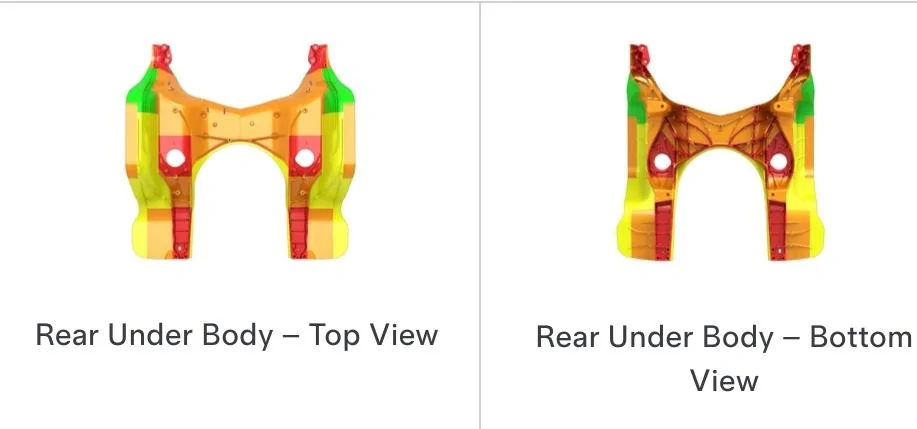

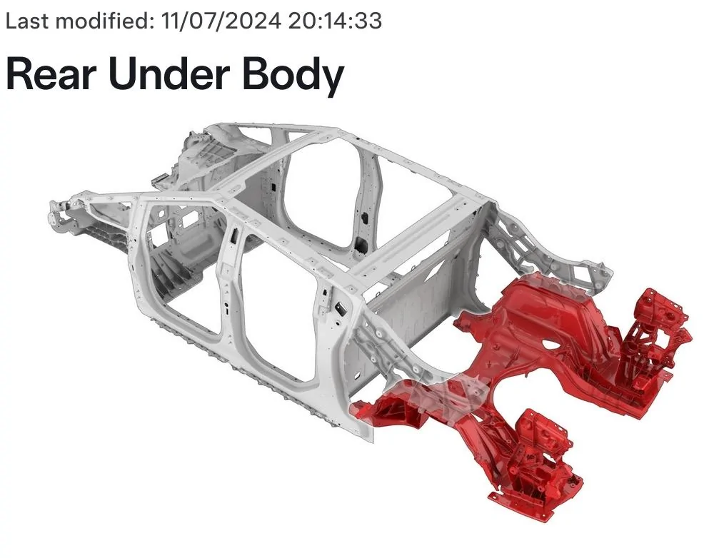

I heard aluminum is difficult to weld though... and the weld point will not have the same strength as the rest of the forged material?
It's cast, not forged, but you are correct that it changes the material properties. That's part of why Tesla has a guide on what repairs can be done where:
Tesla Cybertruck New WhistlinDiesel: Cybertruck vs. F-150 Frame & Hitch Video SmartSelect_20240823_110530_Firefox
https://service.tesla.com/docs/Cybe...UID-A839FDF1-F60E-44E5-ADFB-5B7A220C945C.html
And they have a procedure to swap the whole rear under body (rear frame only procedure is incomplete)
Tesla Cybertruck New WhistlinDiesel: Cybertruck vs. F-150 Frame & Hitch Video SmartSelect_20240823_110345_Firefox
https://service.tesla.com/docs/Cybe...UID-B0B31EF5-A87A-4AAD-AC35-B4B268807556.html
Thanks @mongo ! Learned something new today
My next question is the wtf broke?
From your images the rear under body does not have an aluminum cross beam at the rear. In Dieselgate part 1, it looks like the rear hitch snapped off half of a rear aluminum cross beam
Apologies that I don't have a screen capture or a frame-by-frame video analysis
In Dieselgate part 2, dude says that Tesla couldn't repair the snapped aluminum section... but in your diagram they actually could (if they had a spare whole rear underbody casting)?
