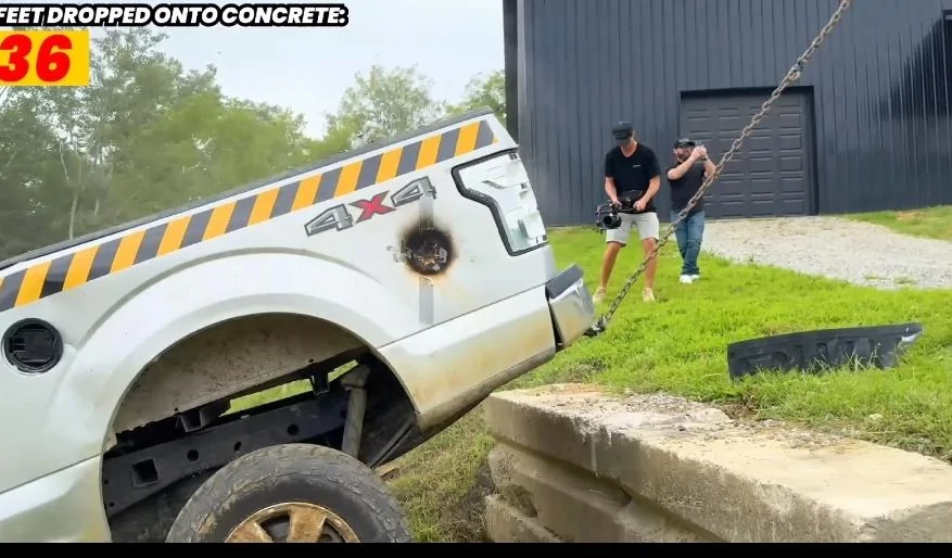

The video (mostly*) debunked the poor argument that a steel F-150 chassis would snap if dropped on its hitch. However, that's an irrelevant strawmanish topic to the events the Cybertruck experienced.
He admits they dropped it on the hitch/ rear frame
He continues saying it snapped in half. The trailer receiver section broke off, not half the frame. It's not clear if the receiver is a critical cross vehicle structural component.

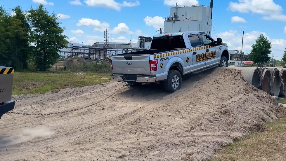

He tries to hand wave the F-150 braking on extraction which is when the frame broke. Note: a 11,000 pound trailer with maximum braking will only exert around 8k pounds of load. The F-150 with nose in the dip could have exerted more, plus the shock load of the chain would be multiples of the F-150 mass.
Note the F-150 is braking before entering the drip, chain is slack, and the pull angle requires a near perpendicular motion of the F-150 front tires:
Tesla Cybertruck New WhistlinDiesel: Cybertruck vs. F-150 Frame & Hitch Video SmartSelect_20240823_091335_Firefox
The Cybertruck still pulls it up the culvert before breaking.
*Ways the video did not compare apples to apples:
F-150 dropped a shorter distance, (but rear wheels didn't hit )
The F-150 had a ball mount in the receiver vs hitting the frame
Biggie: The drop was using an excavator instead of free fall and it was supported by the chain all the way down.
Tesla Cybertruck New WhistlinDiesel: Cybertruck vs. F-150 Frame & Hitch Video SmartSelect_20240823_093832_Studio
The impact angle was different
Other test: Dragging a concrete block is less force

This test is a classic apples-to-oranges comparison which proves nothing.
Did they weigh each vehicle before doing these torture tests? I'm guessing the F-150 weighs close to 5000 lbs with 2200 lbs distributed to the rear axle. The CT weighs 6669 lbs with 3,364 lb on the rear axle, a difference of 1000 lbs or more. When the Cybertruck fell from the concrete pipes, it struck the concrete slab with a far greater force than what the F-150 experienced.
If the falling distance was 3 feet onto a hard concrete surface, that extra 1000 lbs of mass would produce over 30,000 lbs of additional shear force on the Cybertruck's casting on impact compared to what the F-150 frame was subjected to. You can do the math if you don't believe it.
So, drawing conclusions about the durability of these two vehicles based on this sophomoric demostration is completely bogus.
The Ford still wouldn't break, even putting another 1k lbs in the bed. It would bend first.
