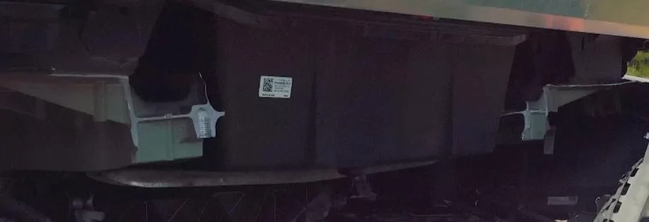

My next question is the wtf broke?
From your images the rear under body does not have an aluminum cross beam at the rear. In Dieselgate part 1, it looks like the rear hitch snapped off half of a rear aluminum cross beam
Apologies that I don't have a screen capture or a frame-by-frame video analysis
In Dieselgate part 2, dude says that Tesla couldn't repair the snapped aluminum section... but in your diagram they actually could (if they had a spare whole rear underbody casting)?
The frame sheared where the hitch receiver attaches. Block hit probably fractured the castings making the top a hinge, then the tow overloaded that connection (after pulling the F-150).

Yeah, they might not be able to fix that casting (technically not repairable), but they can replace the entire piece.

I was attempting to link what WD said to reality. The truck is fixable, even if that casting is not.
Tesla's collision guidelines are there to ensure safety of repaired vehicles.

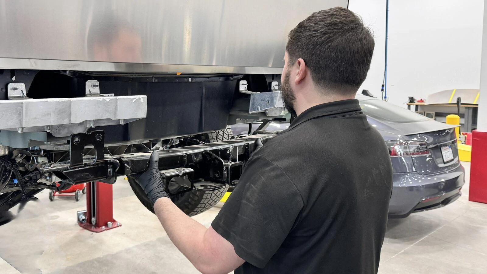

Thanks @mongo ! Learned something new today
Have a look at this video, you will have a much better idea where the frame snapped. You can clearly see the hitch mounting hole at the 18 minutes mark. The frame rail section's procedure is still in development (and parts can't be order yet) but if it ever becomes available, it will be a much simplier fix then replacing the complete rear under body, which can be done too.
*Parts catalogue item #6 and frame rail procedure
