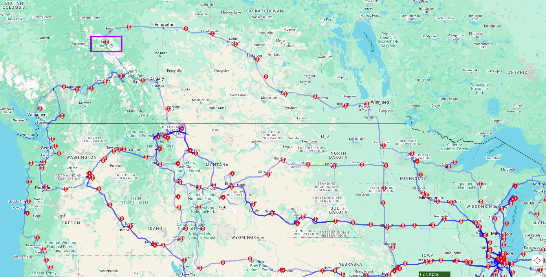

Part of my Lifetime map (TeslaFI)
Tesla Cybertruck Overland Trip to Alaska - Follow For Updates Lifetime map BC Canada

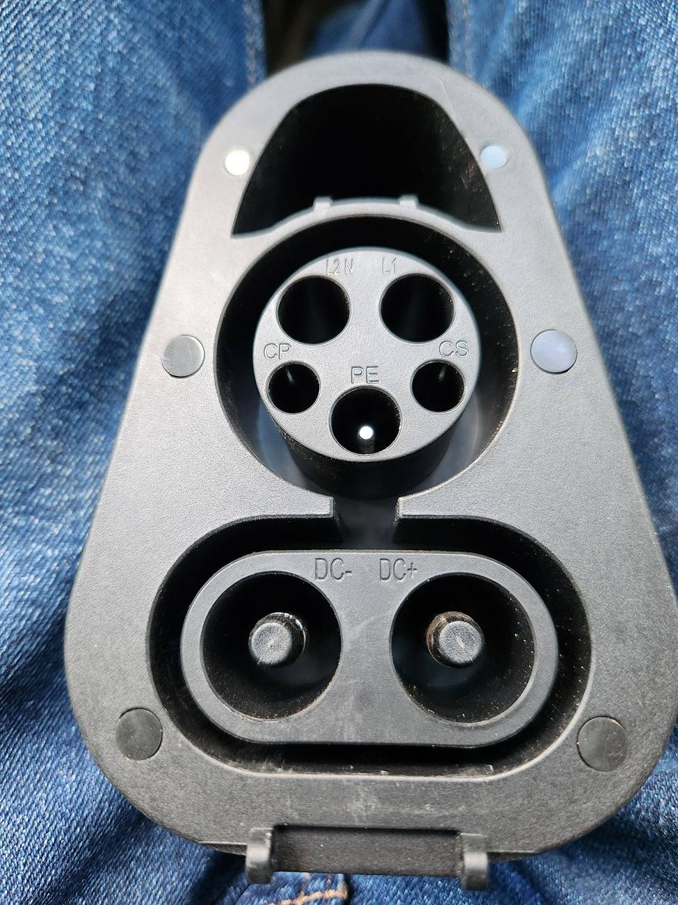

It's also true that the A2Z is only designed for DC charging. Their adapter will accept a combo connector, but the J1772 terminals are missing. That's why the flap over the DC terminals is not present. My Hansshow Cybertruck adapter wouldn't accept the Flo connector, as I've said, but I don't see why the latch opening on the adapter couldn't be enlarged with a file to remedy the problem. I'd need to find a CCS charging station to test it out. What other CCS chargers use the REMA connector?
I had some discussion with another Canadian owner. They discovered that some CCS plugs don't properly depress the button seen taped down in the photo. When taped, it works for them at locations that otherwise would not previously.
Tesla Cybertruck Overland Trip to Alaska - Follow For Updates 1000016065
My adapter does not have the button:
Tesla Cybertruck Overland Trip to Alaska - Follow For Updates 1000016064
Mine also is missing the power pins for the J1772 portion off the adapter. The taped one has those pins. So I'm guessing that the button somehow switches between Level 2 and DC fast charge.
If you have the button, maybe see if taping it down will let you charge. Just be aware that the button might need to be released to allow Level 2 functionality.

I remember reading somewhere that the little button is a UL required safety feature on the combo adapter. When pushed in, it signals that the DC pins are not exposed. If that's the case, taping the button down wouldn't prevent Level 2 charging.
In my opinion, there's nothing to be gained by buying a combo adapter. Tesla provides a J1772 adapter with every car purchase. Tesla's own CCS1 adapter lacks the AC pins. I should have bought a Cybertruck adapter specifically for CCS1 charging like the A2Z ($130 on Amazon). I'm reluctant to do so because I'm not convinced that it will take the REMA connector (e.g., Flo) freely. Buying a S/3/X/Y adapter (e.g., LaTough for $95 with coupon on Amazon), and plugging it into my EVject adapter, is guaranteed to work with REMA connectors due to the larger latch opening on these adapters.
