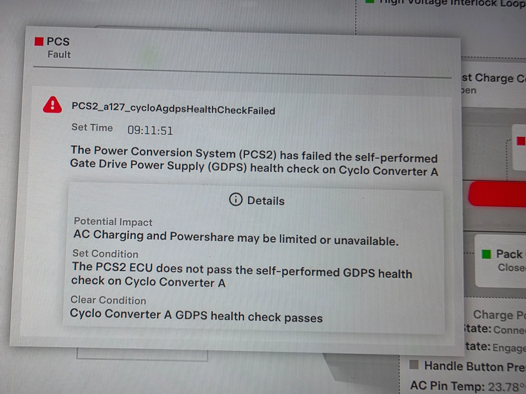

Late to the thread here, but as of last night 2/15/2026, my FS CT from May 2024 has only started charging up to 24amps max. Seems like a very common issue for everyone on here, and typically goes down to 24amps before fully failing? DC charging is fully fine still? If fully fails can you not even drive?
Thanks!

yes affects AC charging also, typically non of us hawk over the AC charging rate, making sure we get 48 amps
you notice it more with DC charging as we all want the highest speed when mobile
regardless, take screen shots of the AC reduced rate
push them politely/hard for the PCS replacement
good luck
