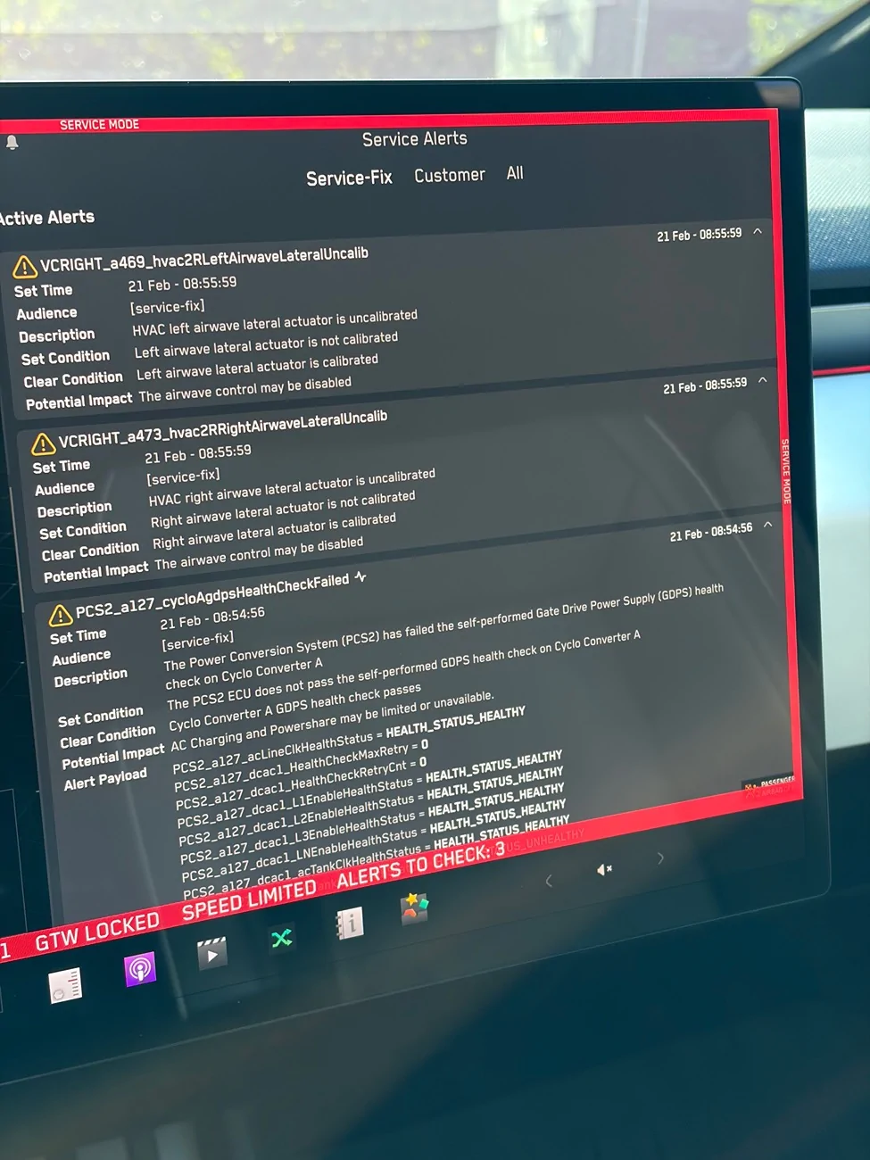

Add me to the list, haha!!
FS AWD, 05/24 delivery, 11xxx, 35k
Just plugged in the wall connector and it went to 24A/24A (normally I’m at 40A/40A). Haven’t checked Service Mode yet, but we all know what’s up, haha!!
Submitted a service ticket. Added non-auto close tonneau and loose rear PWS speaker to the service request, too.
ETA: ‘PCS Blues’ confirmed, haha!!
Tesla Cybertruck PCS Failure - Can’t charge at all IMG_6775
