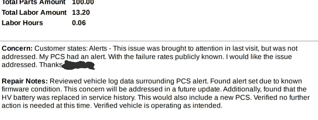

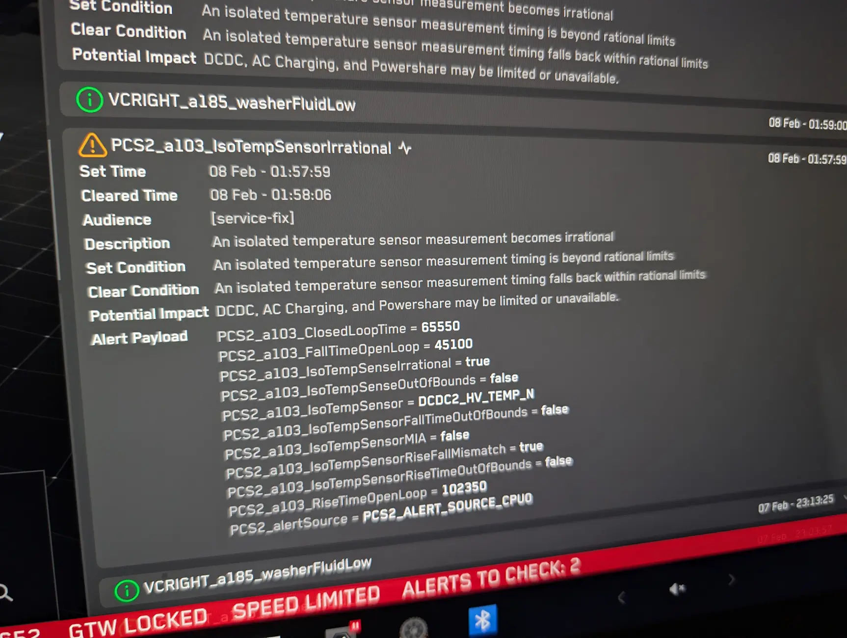

So I took mine in for a rotation, HEPA, and some wind noise. A previous service visit where the wind noise wasn't fixed, and the alert was not addressed. So I had an over temp alert, and this was the result. So the typical future update blah blah....
