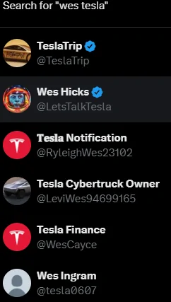

Everyone with this issue and out of warranty can DM Wes on X, be sure to give your VIN and details of frustration
don’t tell him I said to do this ;)
hahah the warranty is one thing but... i'm planning a starbase trip later this year... imagine being down in the boonies and not being able to charge.... with a car full of people that are new to teslas.
