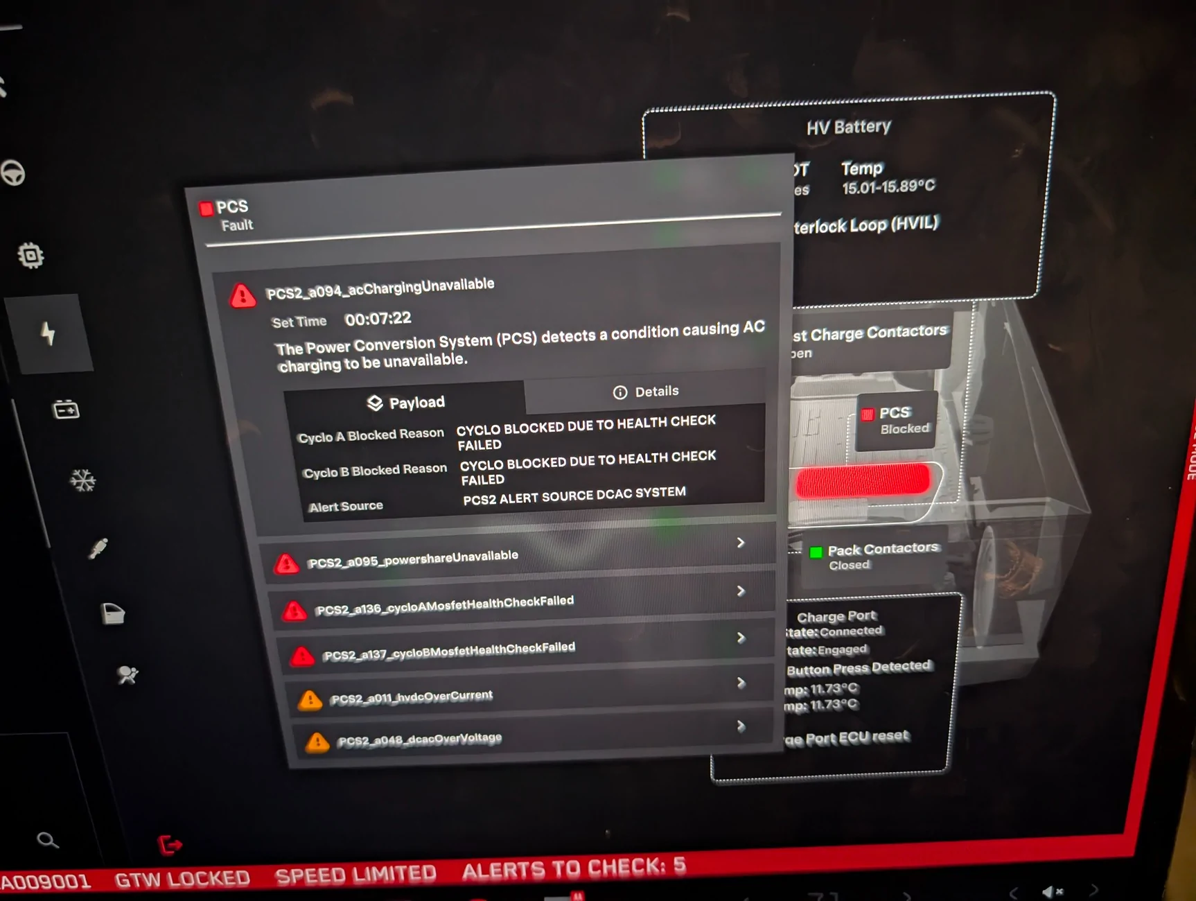

Just had this happen to me last night when I got home and plugged in!

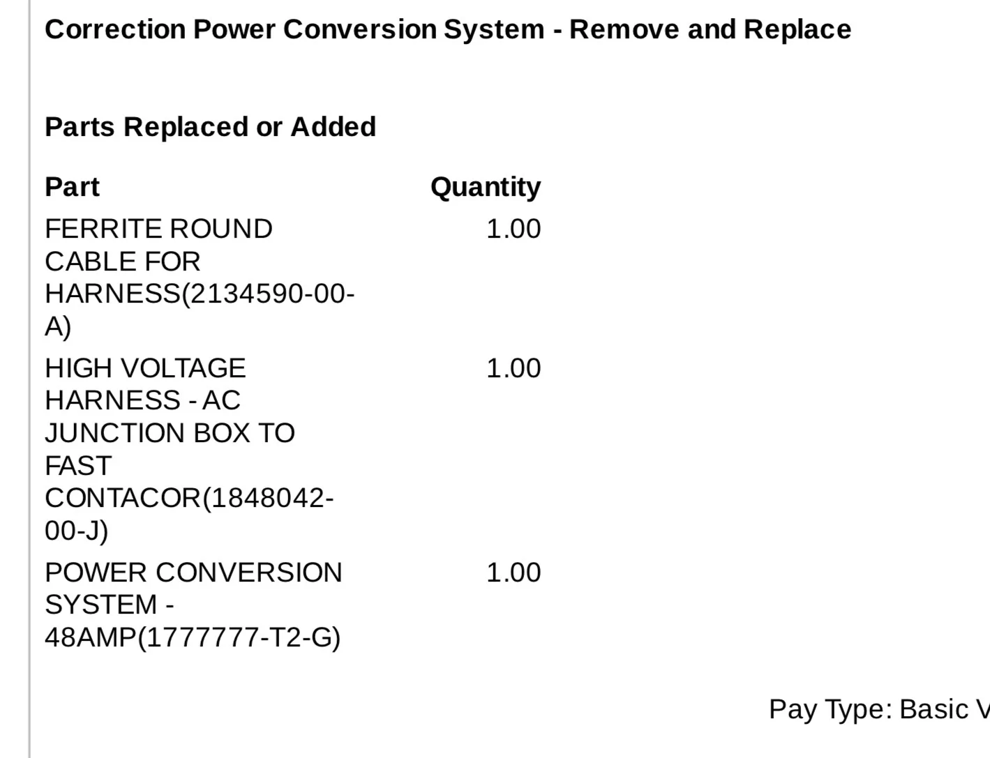

Anybody know what wire that ferrite
Got mine replaced today. SC did it in one day. Dropped off at 7am, picked up at 4pm.
Anybody know what wire(s) that ferrite is placed around? That could be diagnostic for what is possibly causing the failure. Ferrites are used for filtering. Often for decreasing transient spikes.

How do we pull error codes from the service menu to see if there’s any PCS issues proactively. I know how to get into the service menu, but where do I go from there to look for codes specific to the PCS. I only supercharge exclusively so I don’t have any Evidence of even early PCS failure since I don’t level 2 charge.
also, someone mentioned that the PCS is covered on the 2026 cyber trucks?
I don’t believe that’s correct. All the warranty changes for 2026 with the new power system warranty exclude cyber truck so there’s no change to the PCS coverage as far as I understand please correct me if I’m wrong.
May 27, 2024
4,727
5,782
Alerts tab
Or lightning tab then tap the PCS

Just had mine replaced. Foundation Beast VIN 27xxx with 29k miles. Randomly noticed charging at 24/24 at home vs. 48/48. Checked service mode and there it was. Mine was for unhealthy DC tank.
Made service appointment in app and it was two weeks out. The next morning they messaged me and moved the appointment up to next day. Dropped it off on a Thursday morning and picked it up fixed on a Friday afternoon.
Basically, Tesla got me in two days after I requested service, gave me a loaner, and fixed it in a day after drop off for free. YMMV, but I think I’ve got a killer service team nearby.

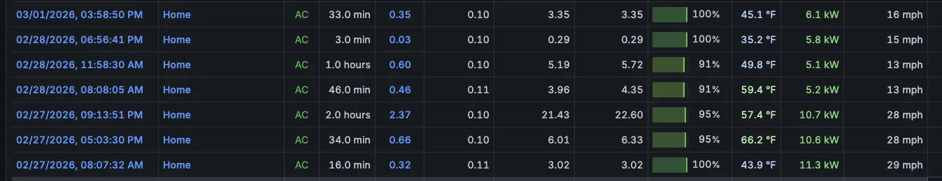

Small update on my truck, after scheduling in the app on saturday morning for the first available time which was April 6th, I texted in app this morning asking them to take a look and see if I could get in earlier. They messaged back within a few minutes letting me know to drop it off today and they'd have a loaner waiting.
Parts should be in tomorrow morning and they think the work will be done tomorrow or wednesday.
Side note (I wish I had setup some sort of automation to detect this) I looked back at my charging history on Teslamate (I charge almost exclusively at home) and noticed that on February 28th my charge rate had dropped from the normal 48v (~11 kW) down to 24v (~5.5 kW). That would have been a great indicator that things were going south.
