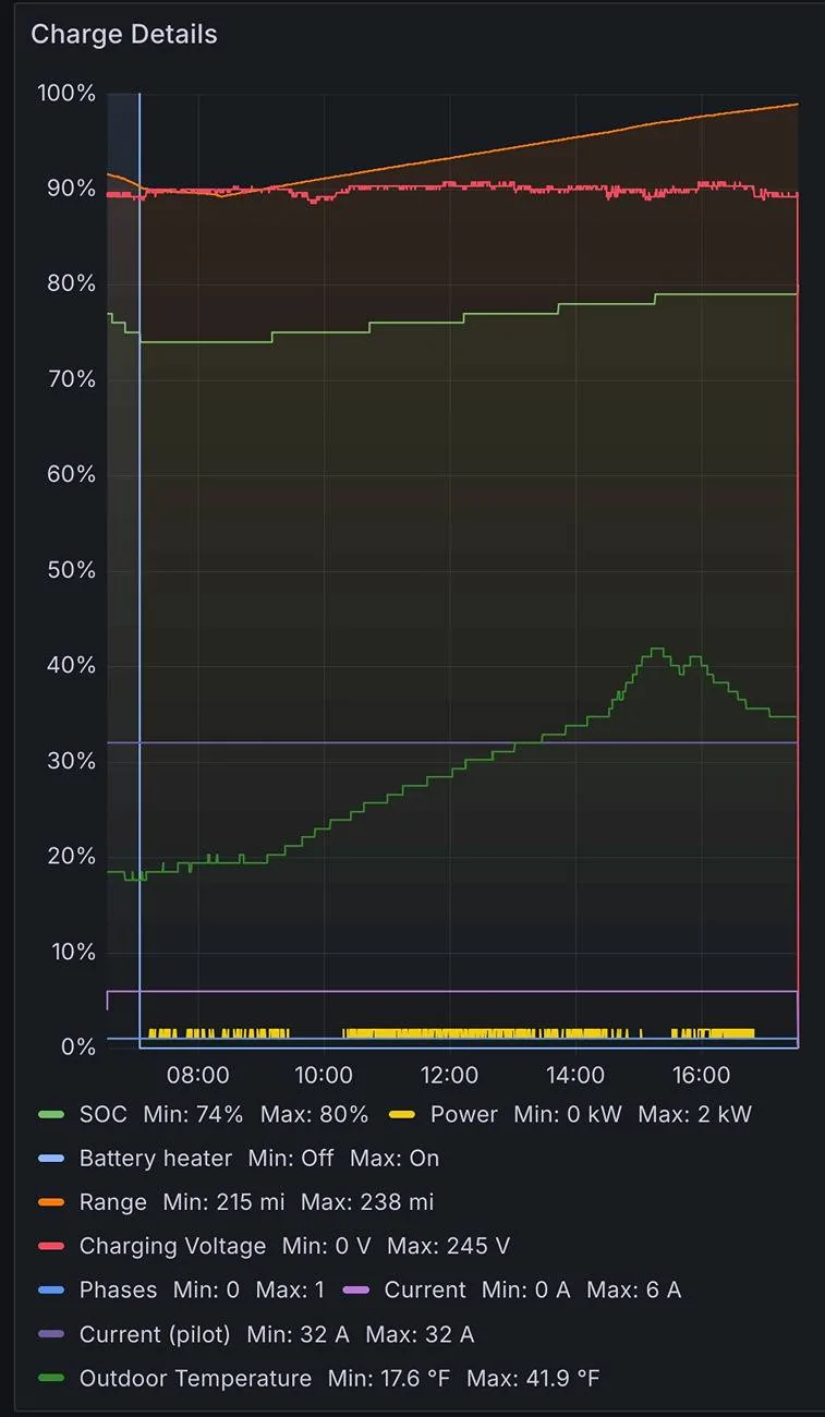

On 240V with 6A current limit.
Started climate control this morning at 6:30am with 75% (73% displayed plus 2% blue)
Truck turned on charging automatically.
Ran climate until 8:22 am, truck was at 74% (72% +2%) inflection point.
Left it charging
At 5:30pm it was at 79% and calculating end of charge so I bumped the limit down to 79 to end the session
Tesla Cybertruck Poor Level 1 charging efficiency SmartSelect_20250211_173225_Firefox
High inefficiency due to climate control:
Tesla Cybertruck Poor Level 1 charging efficiency SmartSelect_20250211_173242_Firefox
