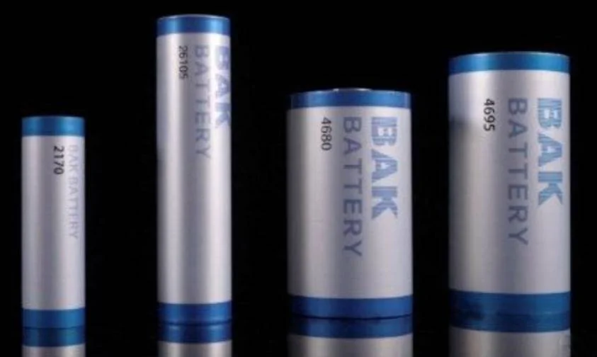

ASIDE:
You can put in longer cells and still have clearance. 110mm cells (30 mm longer) would give the 40% range boost of the extender.
Companies (LGES) are making the other larger size of 4695.
4695s would only give you 20% (x1.2) better which is not close to a RE.
An interesting world in the CUV category tho (TMY, future R2, Mach-E, EV6, Blazer/Equinox, etc x 7).
We are in for some interesting times with batteries.
"LGES said on Thursday that it will provide Rivian with its advanced 4695 cylindrical cells for over five years, with a capacity totaling 67 gigawatt-hours. The new cell type has a diameter of 46 millimeters and is 95 mm tall, the battery maker said in a press release. It will feature six times the capacity of the existing 2170 cylindrical cells. "​
