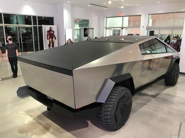

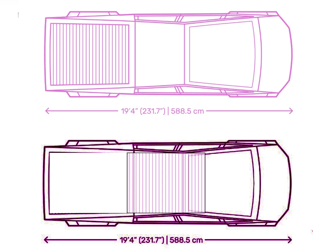

I didn’t quite catch that this was to be a single sliding panel. That is physically impossible unless they change the roof line. The vault is wider than the peak of the roof where the sliding cover would go. The only way it could happen is if it were in multiple pieces which stack.
10,719
26,998
The single piece slider ends up sticking out about 18” and is about 8 inches too wide. Only way this works is if you make the opening to the vault smaller. I’d be ok with a smaller vault, but not with a vault which has overhanging sides and a huge lip in the front. The current lip is limiting enough.
Agree with you. Once we get into stackable sections, they just become wider slats in the rolling cover.

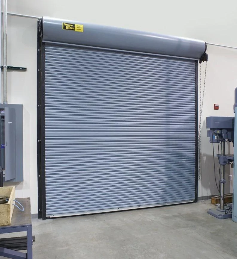

The Cybertruck rolling tonneau cover is basically an adaptation of a commercial garage door that rolls up into a canister. It’s nothing groundbreaking but it has never been adapted for use on a personal vehicle as far as I know.

Most rolling covers work by pushing/pulling the cover from the spool.
The motor is spinning the spool.
The tracking sides of the cover must be continuous all the way to the spool even if there is a windowed section in the cover.
If the rolling cover is underneath the Cybertruck the cover ( or cover base structure) will need to be 12 ft long. Also, just like with a window in a building structural wall if you put and opening in rolling cover you will need a frame to transfer the pull/push forces around the opening.

Really if its solid it should function like a giant glass sunroof and slide up over the exterior of the cab roof. It could be a giant glass solar panel, which would probably get slightly more output that the rolling slats will get. And it seems like keeping it outside of the vehicle would solve a lot of engineering issues. It wouldn't look as cool driving around with it open when needed but you could at least still be using the solar feature. with the rolling cover the solar wont function when its rolled into the truck.
10,719
26,998
What do you do with the 18+ inches of panel which is sticking up in the air above the peak of the roof? Does that just act as a big parachute when you are driving?
Also, since it’s wider then the roof near the peak, how does it slide open?
This feels like we’re trying to fit 8 gallons of horseshit into a 5 gallon bucket.

I’d love to see all of that. It just needs to actually be possible. .
So far want you’ve shown requires Time Lord technology to accomplish.
If your 9 gallon bucket actually obeys the laws of physics maybe we can discuss it?
What you have suggested so far is not actually possible.
Are you widening the roof?
Shrinking the bed length?
Making the opening above the bed skinnier?
Making the truck impossible to drive when the roof is open?
Some combination of the above?
Most likely whatever you cook up is going to have to do one of the above and would make a considerable number of people unhappy. But without you picking what actually needs to happen we can only guess which you think is the most reasonable compromise.
