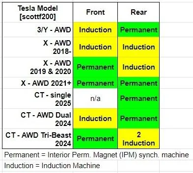

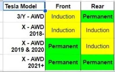

FYI, Tesla has had combinations already. See the chart I put together.
One aspect: It does appear that permanent versions allow them to regen down to 0 MPH. My 2017 Model X with two inductions does not (regens to like 3 MPH).

Updated my chart for the CT

This is pretty much the best answer.. the engineer I spoke with said that to get the best efficiency having induction in the rear was the best scenario with also being cheaper to manufacturer. I wonder if the semi will eventually do this vs having the clutch system they currently have.
