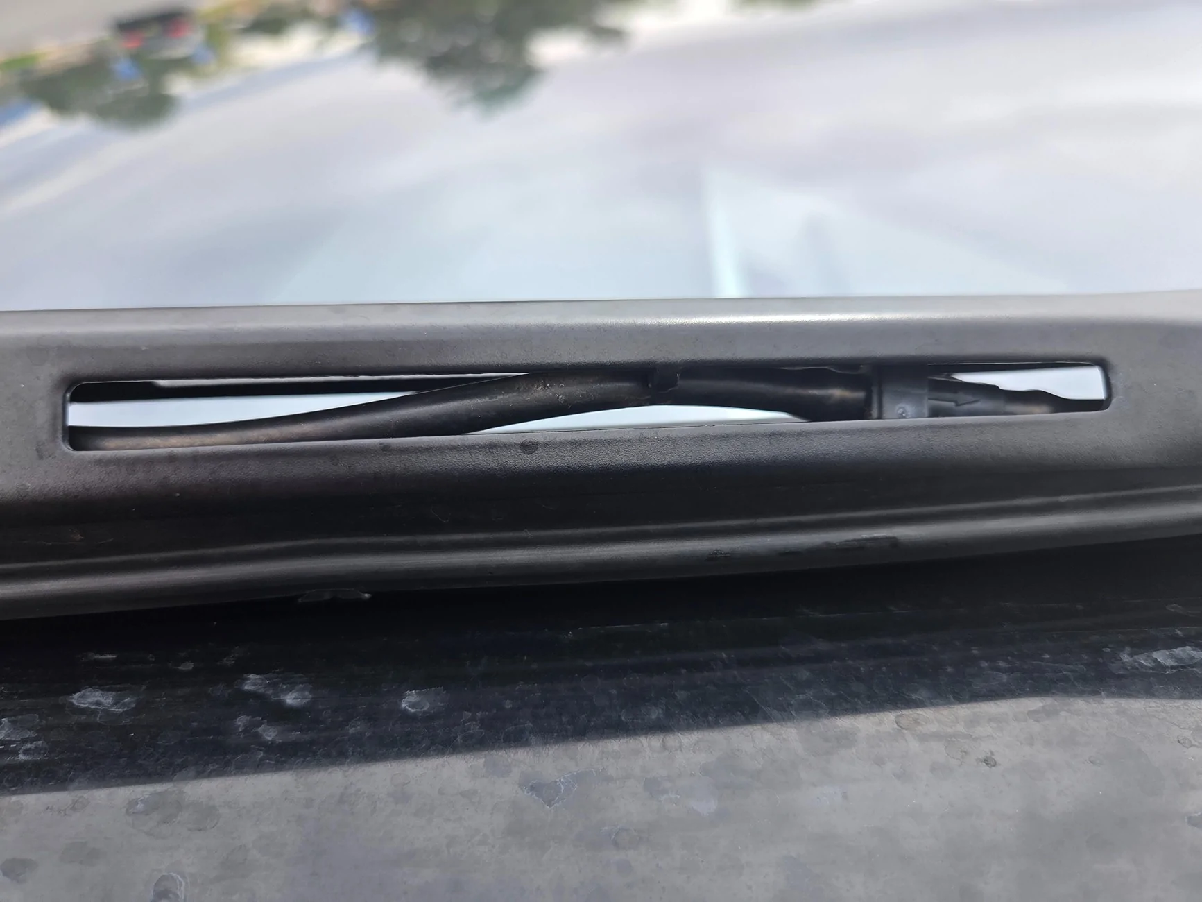

Folks, I may have figured it out. Check your fluid hose inside the big wiper blade. Mine was loose, and one little black clip was broken. The air flow comes across the vents in the wiper assembly, and the angle matters.... hence the left right difference. Make sure the hose can't catch the air stream, and is well tucked up inside.

Whenit is cold outside, the hose is harder, and makes more noise than when it is softer.

one of my clips for that hose is broken. i wonder if they sell them? its a poor design maybe ill try some tie wraps to secure it better to test the theory

Try this. At 70 mph, push the wiper button once. When the blade is down, you can really hear the air turbulence. You might also see te fluid hose fluttering, just a tiny bit, in the air stream. Google "windshield wiper fluid hose loose in Cybertruck". Turns out this has been noticed before. My hose is like snake, and I think the air can catch it.

Another great test would be to temporarily remove the whole wiper arm. If the noise is gone, the problem would be pinned down.

i have another idea for a test. tape over the slots instead. that should block the wind well enough to see if the noise stops. it has not been cold enough here so i cant try it yet.
