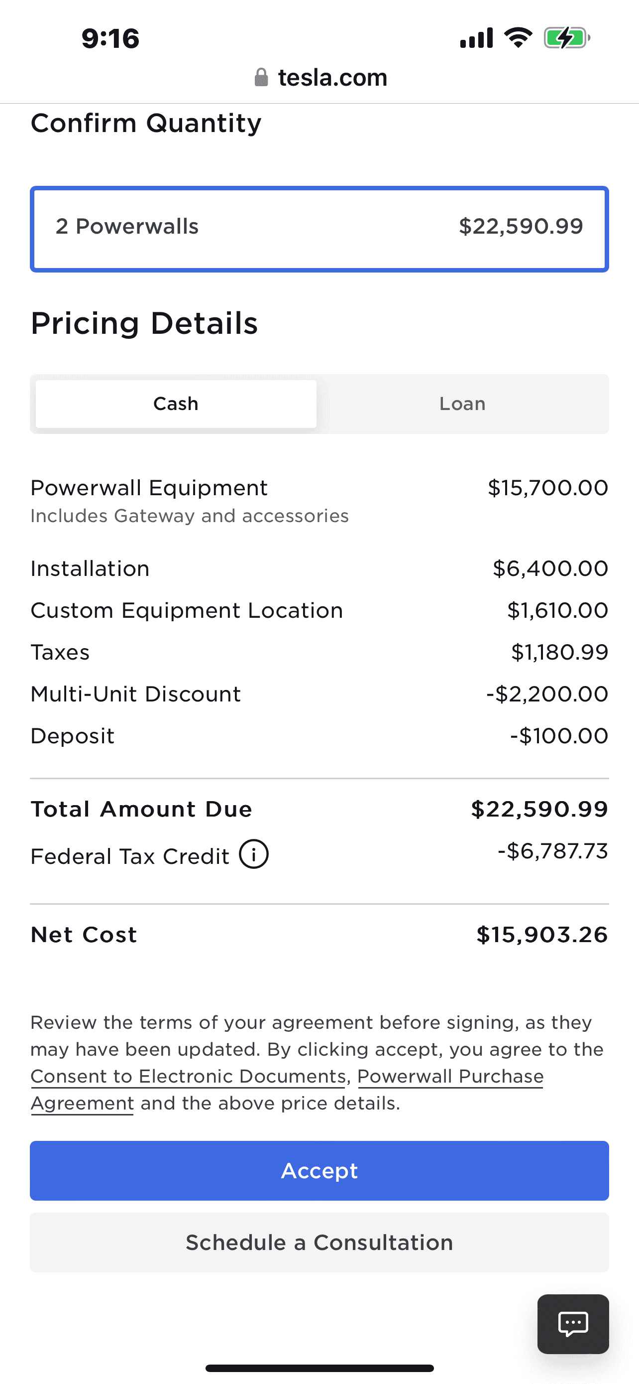

POWERWALL AND CT POWERSHARE DUPLICITY:
I had started going down the path on a Powerwall quote just prior to my Cybertruck Order (12/28/23, with Q1-24 delivery)..but with my Foundation Series order and now coming with PowerShare capabilities and included components (Gateway, PowerShare connection, etc) it seems like the Powerwall quote I just received has some duplicity in that I am paying for the same components needed and overlap on installation!?
any ideas? I have been trying to get answer from my Powerwall rep but nothing yet.
Here is Powerwall quote:
Tesla Cybertruck ⚡️ PowerShare Install, Specs, Details confirmed! No load shifting (for now) IMG_6531
I would wait to order the powerwall. The installer for my PowerShare also is a Tesla PowerWall installer and he said most of the labor is the same, so it would make sense to do them at the same time to save money. Once they come out for your PowerShare, maybe you can tell them you want to do PowerWall at the same time and they can do it that way?
