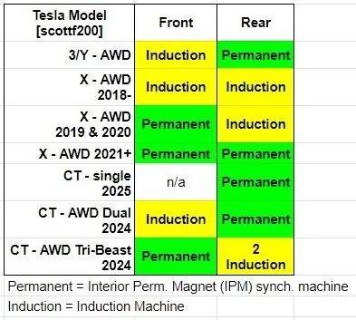

Because there are independent motors in the rear on the AWD Tri-beast did/can Tesla use 'regen braking' instead of the physical brakes for the logical "traction control"?
I also didn't know if the type of motor played a factor in any of this?
[oddly in contrast to the Tri-beast, the S/X plaid use permanent on the two rears per the manual]
Tesla Cybertruck 0-60 of ct dual fs vs model x dual Induction and Permanent CT
