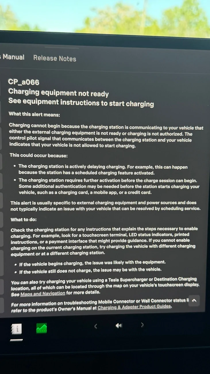

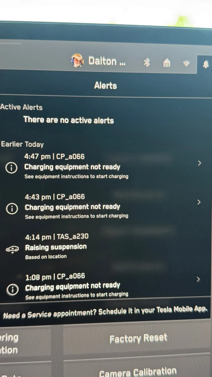

It certainly seems like I have just joined the club. Although I don’t know that I’m getting the right warning. CP_a066? I don’t know that that’s been what I’ve seen reported. Only charging at 24A instead of my 48A. Just started this afternoon.

It certainly seems like I have just joined the club. Although I don’t know that I’m getting the right warning. CP_a066. Only charging at 24A instead of my 48A. Just started this afternoon.
Yea that it, mine is weird also and service center guys having issues giving me the free supercharging update so much so that they pushed my appointment up to this Monday. When connecting my home charger it’s blue for 1-2 seconds and flips red. App says error, screen says equipment not providing power. In service mode those alerts say HVBATT error unplug and retry. Service says it’s pcs. Fun times I’ll be glad to get it fixed. 70k miles so I’ll be footing the 1k bill for the pcs. Not happy about that but what ever.
