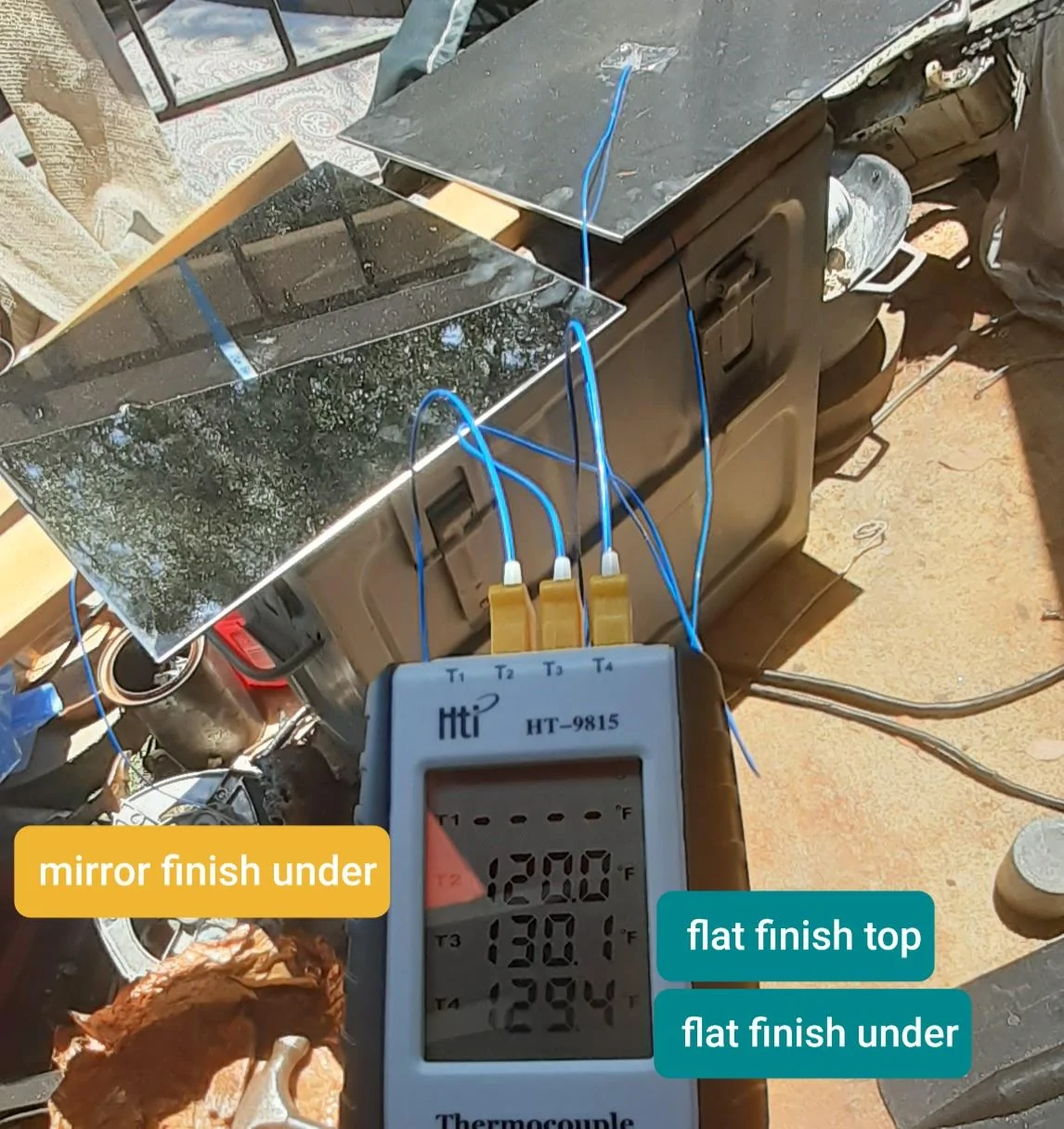

2and test with better thermometer and thermocouples
Tests takin about 2PM plates been in sun outside all day. mirrored and flat finishes about 77f ambient temp very slight breeze probes taped directly to the steel. Thermometer says +- 1 degree
Flat/brushed: 130.1F on top facing sun.
129.4f on back side
Mirrored: 120.0f on back side.
Not shown but top temp was basically the same.
nearly identical to the 1st test, mirrored finish is 10 degrees cooler thAn the brushed type finish
