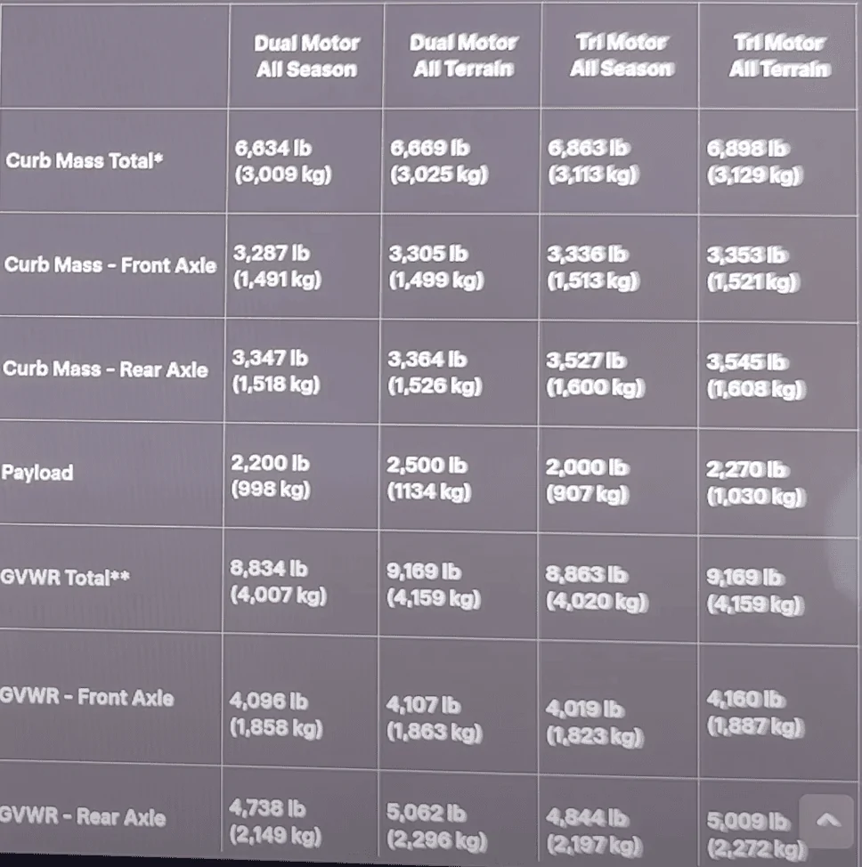

I spent some cycles converting that screen capture of CT weights to a Gsheet so I could do some simple math to show the differences of
- tires: AS (all seasons) vs AT (all terrain)
- powertrains: Tri vs Dual
[Note: I did use an OCR tool but then had to do a fair number of cleanup edits. I double checked the numbers but let me know if something is amiss]

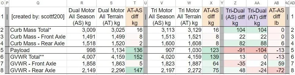

Chart below is in: kg
Tesla Cybertruck Curb Mass | Payload | GVWR table w/diff AS-vs-AT & Tri-vs-Dual 6EYUG6M

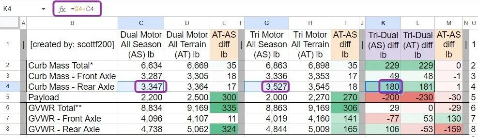

I think the below highlights indicate that the Tri-beast extra motor+gearbox is ~180.5 lbs [AVG(K4,L4)]

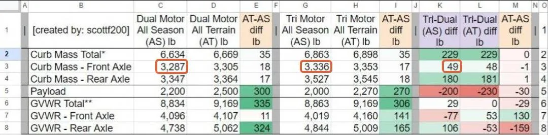

It looks like Tesla might have accidently swapped the Front Axle Curb Mass of the Dual Motor and the Tri Motor. I say that because permanent magnet motors are generally lighter than AC induction motors.
You will also notice the GVWR for the front axles is higher on the Dual Motor vs. the Tri Motor. I think this is correct but it also kind of re-enforces that the Curb Mass figures for the front axles were accidently swapped.

Why would the Tri-Beast front axle be 49 lbs [AVG(K3,L3)] heavier than the Dual Motor?
