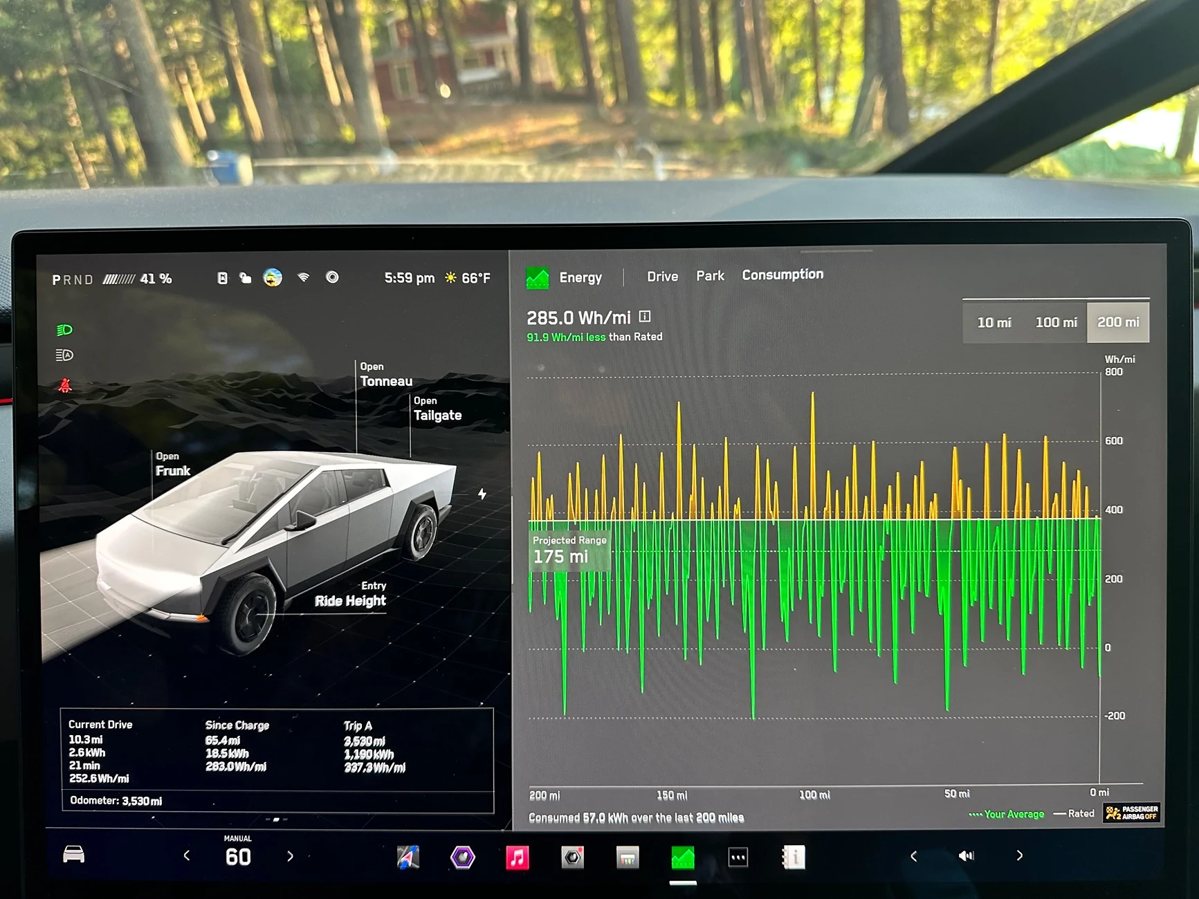

Can someone please help me understand this? 370 wh/mi is awesome efficiency but this doesn’t add up to a 122kwh battery. At 405wh/mile a 122kwh battery should give the stated range of 300 miles. At 370 wh/mile it should be a lot more. Battery seems to be a lot smaller than 122kwh. Thanks
So, you went from 97% down to 9%, for 237.1mi, and the battery used, 87.8kWh works out to ~72% of your battery used. The difference is ~16%.
And the Energy Park display should show 16% used. Did you look to see what that display showed? Would be nice to get confirmation that your battery size is correct.
yes, points to an approx 122KWH pack, which is what we been saying
72% x 1.39 is 100%, 1.39x87.8KWH is 122KWH
