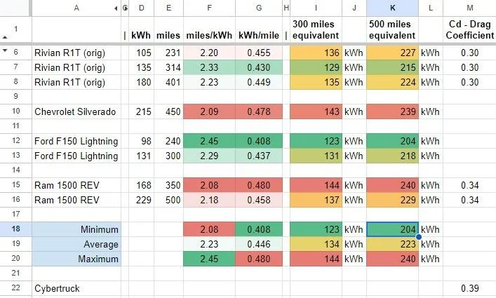

Absolutely zero proof of that.
Elon said he hoped to get Cd of 0.30 for the CT.
Zero proof of what exactly? My post didn’t claim proof of anything but even put the word “assume” in quotes and did some number crunching for fun to game out possibilities.
I like the chart you shared but exactly are you trying to get at? Pack size? Efficiency? I’m just trying to understand what you meant.
Sorry.
The chart is to start to do some real world comparisons. Why did you assume such numbers that were way better than the competition? The Cd so far has not been proven to be better. My point about what Rivian was able to accomplish to get Cd was that you don't need a triangle.
My point about towing still stands. The triangle CT areo wouldn't seem to help with towing something that causes so much drags itself. Still we may be surprised. The Tesla motors are efficient and I've done some towing in my X. It did better than expected losing like 1/3 or 2/5 instead of the common 1/2.
You're forgetting Cybertruck will likely come in at ~1,000 lbs less than the R1T. You're also not using the right figures:
R1T Quad 328mi (135kWh) = 2.43 mi/kWh
F-150 Lightning ER 4WD 320mi (131kWh) = 2.44 mi/kWh
