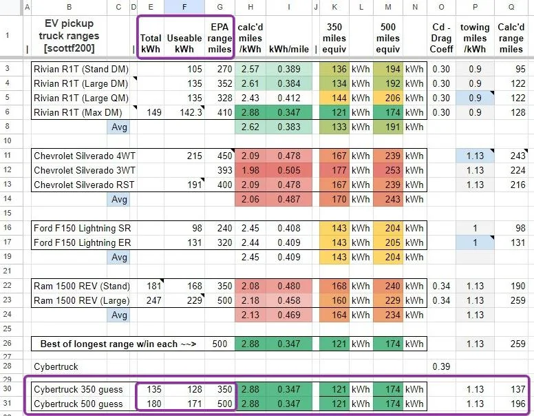

As we wait for 'real world' figures or EPA and so on, are you thinking any particular battery pack size and if so what's your rough in of consumption?
Could the TRI/QUAD run a 175 kWh pack and deliver a hypothetical 3.1 miles/kWh?
It would SMASH the competition if it this was the case.
Edit: On reflection, and reading Elon notes beyond 2019, l might be too heavy handed on that pack size. Something about carrying around batteries and a ~330 mile range. A salute to the environ_mental CT.
I think with the Rivians Cd of 0.30 and efficient motors proven with recent data that Tesla will have a hard time beating them by any significant amount.
I just added a couple rows using the "best" numbers for competitors to see how it worked out. Usable is 95% of total kWh.
