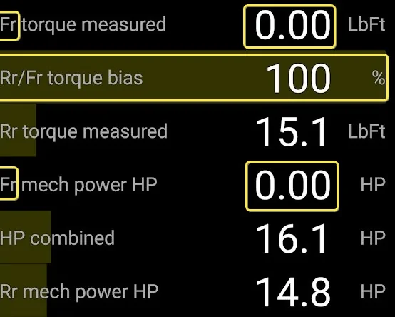

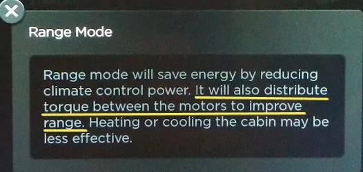

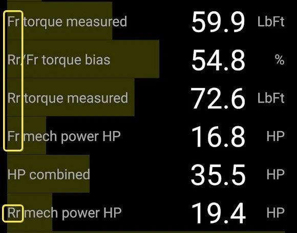

with R1T the tire wear in conserve mode is caused by all the power going to front tires, if you do gentle starts tires are fine, I use conserve mode on trips and all purpose (power goes to both axles) locally
On my 2017 Model X, I have 'range mode' that biases the rear over the front and I use it for road trips. Not sure what is going on with the Rivan, but I do not seem to have excess tire wear on front vs rear.
Note that any acceleration and the front immediately "kicks in."
Tesla Cybertruck GM vs Cybertruck battery size & $ hmgfcwo-jpg
Testing using ScanMyTesla software connected to canbus.
With range mode

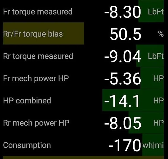

Tesla Cybertruck GM vs Cybertruck battery size & $ bu347v4-jpg
Tesla Cybertruck GM vs Cybertruck battery size & $ 3im2vut-jpg
Regen uses both still.
