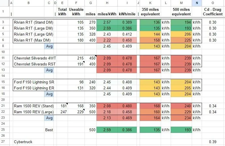

I'll add EPA (or equiv) info the chart when CT numbers are aout. Real world the 1000 lb weight is insignificant.
That is people choosing a CT or comparing to other BEV pickups for their hauling they need to know that even if the CT is 1000 lbs lighter that is not what is getting them real world mileage.
Oh heck. I saw that and forgot to correct it. The Rivian numbers are very good overall.
As we wait for 'real world' figures or EPA and so on, are you thinking any particular battery pack size and if so what's your rough in of consumption?
Could the TRI/QUAD run a 175 kWh pack and deliver a hypothetical 3.1 miles/kWh?
It would SMASH the competition if it this was the case.
Edit: On reflection, and reading Elon notes beyond 2019, l might be too heavy handed on that pack size. Something about carrying around batteries and a ~330 mile range. A salute to the environ_mental CT.
