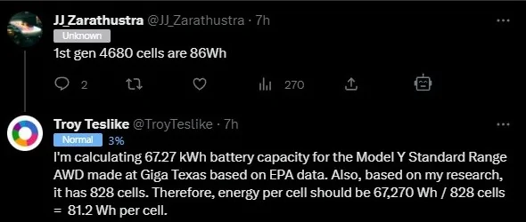

As always, Troy with wrong info

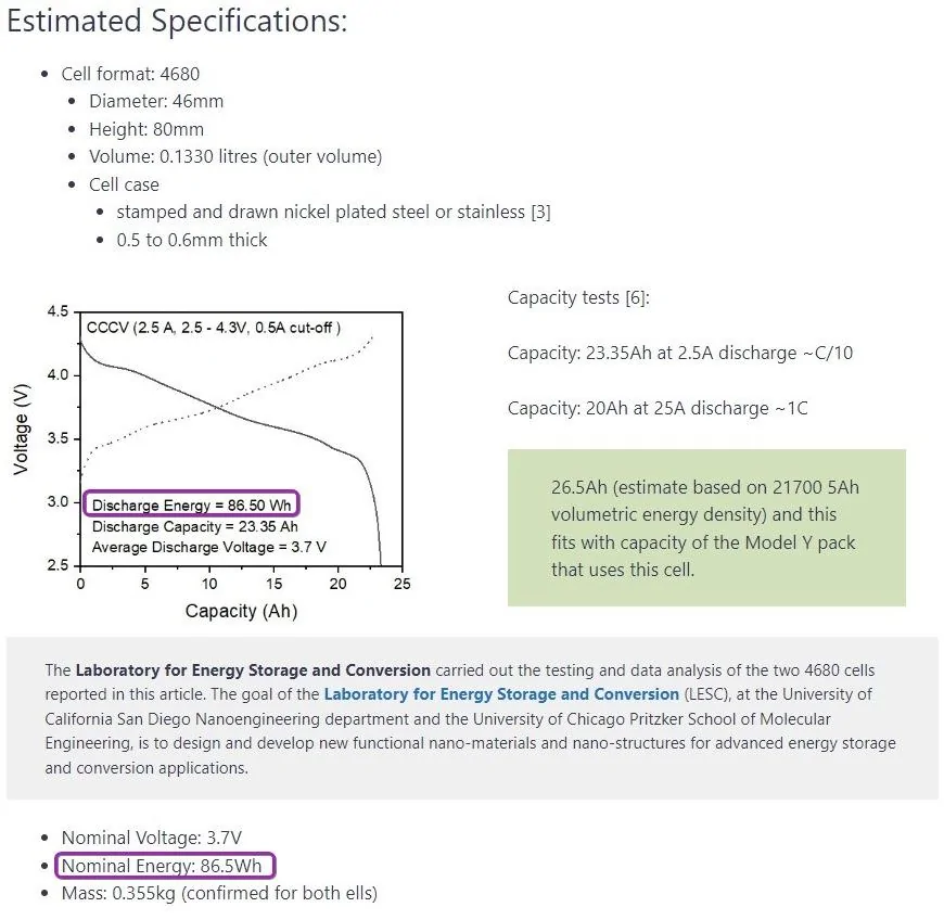

Current 4680s are 86.5 Wh, making the 10% increase be 95 Wh
I'm on the team double stack of 4680s for sure, copying my latest speculation from somewhere else, and this is was before the earnings call, so numbers are better than this
Thanks for those details.
Title: Tesla 4680 Cell - November 18, 2022
Via: https://www.batterydesign.net/tesla-4680-cell/
Tesla Cybertruck Cybertruck Range Prediction + Cell Calculation + More [Sources] 2GXktw1

Again, Troy confusing things
One is usable energy, another is gross capacity, there is a bottom buffer
When we talk about pack size it should be the gross capacity
When we talk about "Cybertruck Range Prediction" tho that is based on usable energy.
