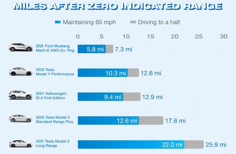

Edmunds put Tesla’s claim to the test and tested three Tesla vehicles, as well as two vehicles from other manufacturers, to see how many miles they would get after the displayed range hits zero.
Here are the results:
Tesla Cybertruck Cybertruck Range Prediction + Cell Calculation + More [Sources] Screen-Shot-2021-03-25-at-12.40.43-PM

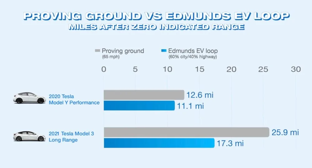

That test was at 65 mph, but they also performed the test with a cycle closer to the EPA test cycle:
Tesla Cybertruck Cybertruck Range Prediction + Cell Calculation + More [Sources] Screen-Shot-2021-03-25-at-12.43.53-PM
Edmunds says that Tesla engineers told them that “the buffer cannot be defined exactly to a number every time — it will change based on external conditions, driving profile, etc.”
When adding those buffer results, only two of Tesla’s vehicles actually hit their EPA estimated range.
They concluded:
Our answer to Tesla’s dismay with our initial results is that, yes, two of the automaker’s vehicles can match the EPA’s range estimates in the Edmunds EV range test. But that’s only under specific circumstances and by driving each vehicle past zero indicated miles of range.

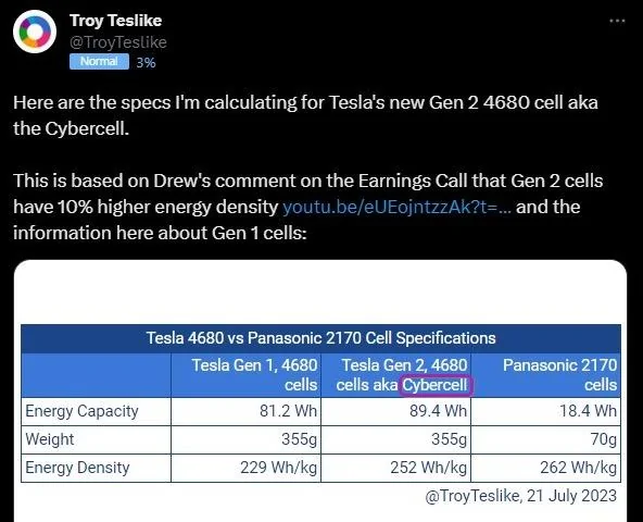

Just saw this nice comparison table.
NOTE: that the Pan.2170 has higher Energy Density than the Gen2 4680 Cybercell.
19:47 into this from above text:
This may be a big part of why no 500 mile at launch.
Tesla is still making baby steps as a battery company.
