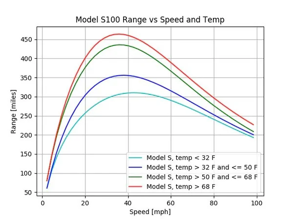

Besides everything listed above, some other things:
-Ideal ambient temperature. Studies show that EV range is maximized between an ambient temperature of around 80F. There is a small drop off at higher temperatures due to excess climate control. Your vehicle range will be much worse in cold weather due to the temperature dependence of the electrochemical properties of the battery (your battery performs worse in low temperatures). It gets even worse at very low temperatures because the vehicle has to compensate to keep the battery warm
-Most critical-speed. Based upon my experience in my model 3, there’s a huge difference in range between any speed below 60mph. I’ve gone 60-65mph on trips to avoid charging, even when highway speed is 70mph. Yeah, everyone on the highway is going to hate you and going slow drives me crazy. FSD will help this tremendously. For short trips (<300 miles) you can reasonably do without charging, it makes more sense to maximize range and go slow. For long trips, it is better to go 70mph and charge more frequently because you spend less time charging than the time you save from preserving range. Furthermore, on a long trip, you will have to stop anyways to eat and use the bathroom. I just always make sure to hold it until I can get to a SC and eat near the SC stop.

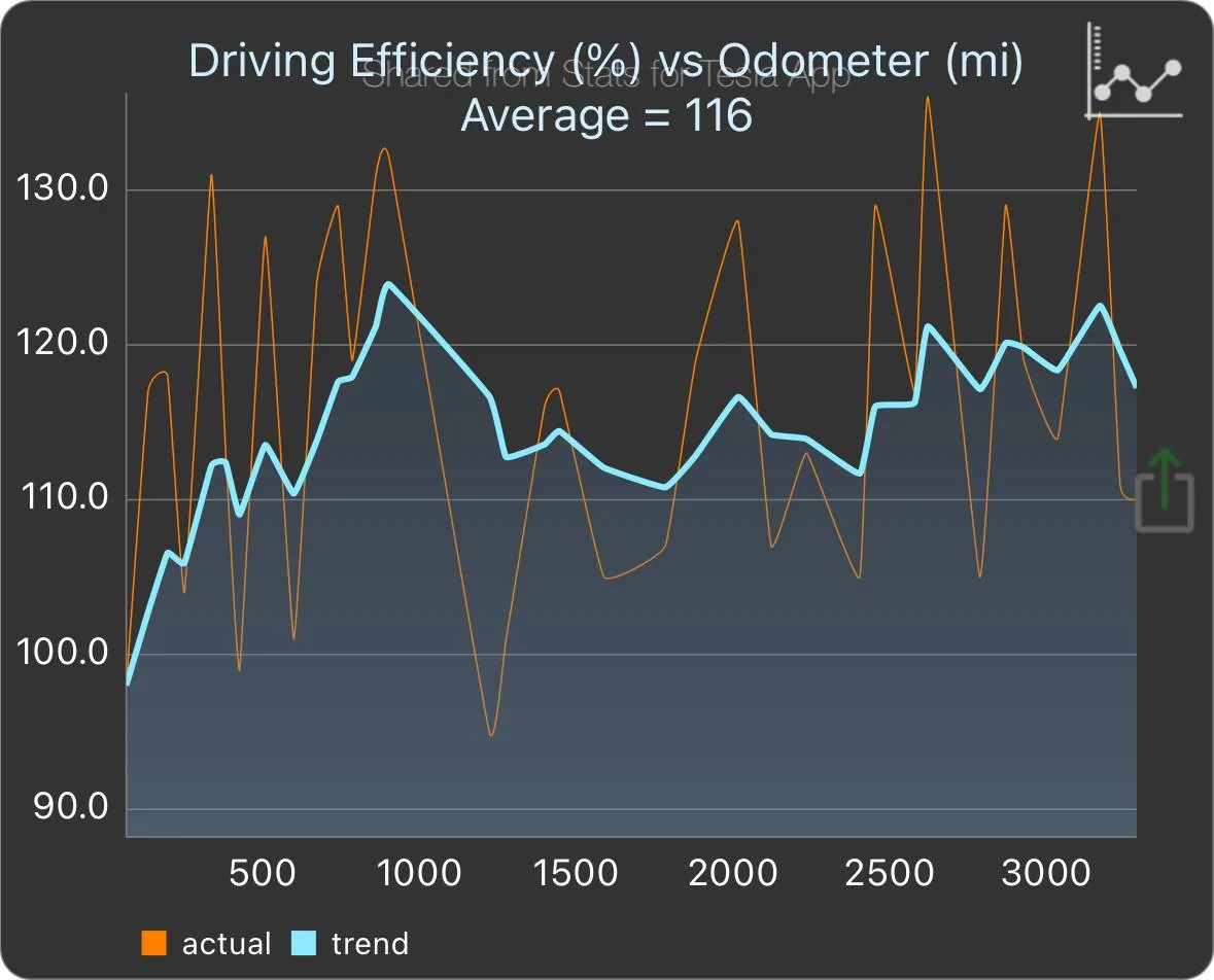

I'm at 8,000 miles and my lifetime is 399wh/mile. Pretty good I think.
FYI: Tires at about 52-55psi, temps constant around 80-85F.
