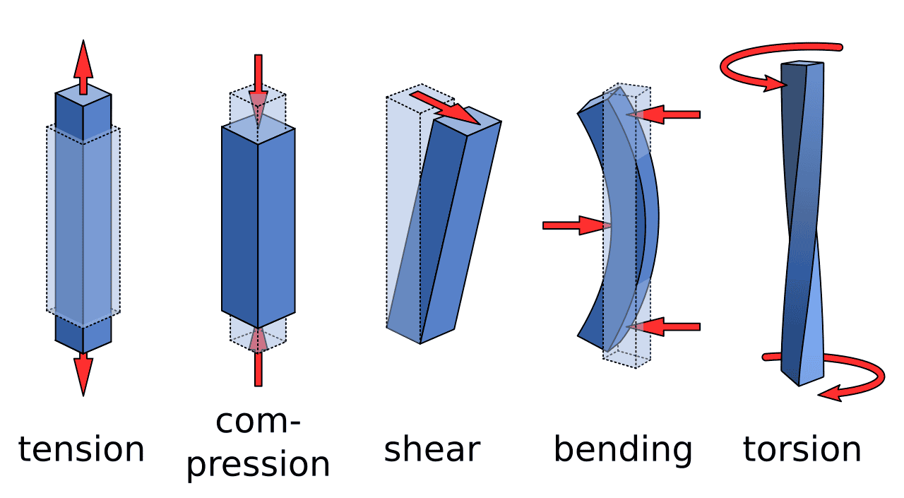

This all depends on the specific load paths and how forces are being applied to it.
Tesla Cybertruck No Exoskeleton 1280px-Different-types-of-mechanical-stress_EN.sv
To measure force we use Newtons which is expressed as 1 kgms2 or the force required to accelerate 1kg 1 meter per second per second. Now pressure is the amount of force (N) applied perpendicular to a surface over a unit of area. Now if you halve the area you double the force and vice versa.
For example; although they use dissimilar materials like aluminium for the cast and steel for the cabin frame, compression loads are fairly easily transferred through to the next element simply ensuring that wherever they touch there is enough material and surface area at the interface point to transfer the force without it failing. Just like you standing on pavement, the force of gravity is being transferred through the soles of your shoes. Think of your shoes as the contact patch of your car tyres.
Now for tension loads you essentially have to create a structure that stops the separation of the two different surfaces at the interface point. The same rule for surface area and force applies. If you use a fastener like a nut and bolt the inside ends of the nut and the bolt effectively work as opposing surfaces to the primary mating surfaces explained above. Washer's increase the surface area of the force over a greater area leading to better distribution of the forces.
There are other forces that can be applied to the interface point as well, like shear forces, that like a "shear" try to slide the surfaces of the interface point over each other, by applying a force parallel to the interface surface. This is like trying to slide your shoe on the ground whilst supporting your mass. Here the tension of a nut and bolt creates skin friction on the interface point area, and as such can distribute more shear load than the bolt itself, for example when it is not tightened properly. Just like you putting all your weight on one foot will make that shoe harder to slide on the pavement.
There is also torsional forces that can be applied to a interface point, but on a larger frame structure like the CT these frame sized torsional forces become more like shear force on each of the different interface points that connect the cast to the cabin frame. For example a single tow hook does not experience a torsional force until it reaches the end of it's pivot range and contacts the side of the tow ball. Likewise a torsional force on the rear cast will express itself as a shear force at the attachment points to the cabin frame. Imagine the direction of the force on each of the individual corners of the torsional element in the diagram above.
Bending force is another element, but not really that relevant to the connection interface between cabin and casts, although depending on how many points you have and how distributed the forces are, they could create bending forces over the plane of interfaces.

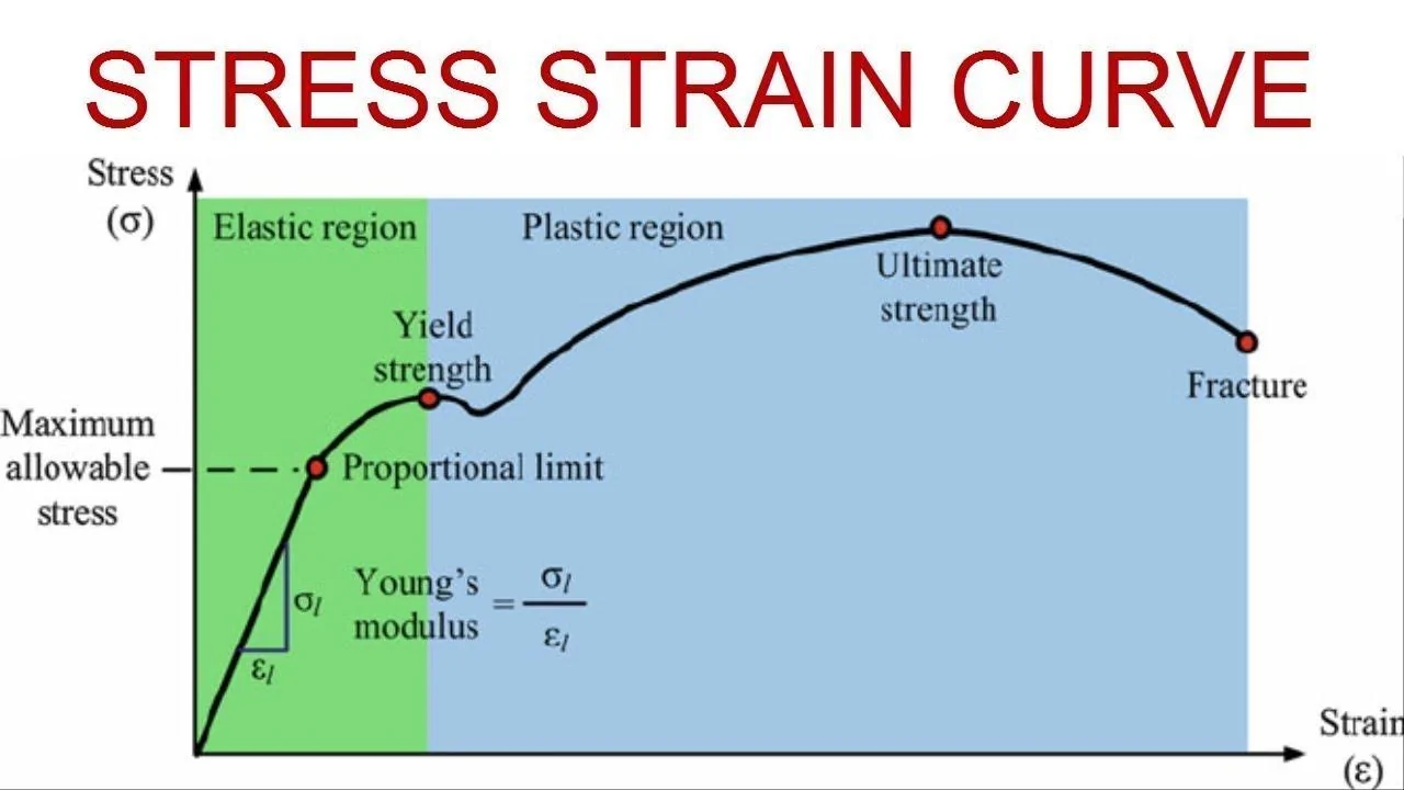

With that out of the way, the next considerations that need to be made is what are the material properties being used. Simply, all materials have something called "elasticity" that define how they respond to external forces. For example on a piece of rubber you can exert a tension force to elongate it, your can also compress it, twist it and bend it with relative ease, like in the diagram.
If the rubber returns to it's normal original state after experiencing these forces then you can consider it operating within it's "elastic deformation" range. If you however use even more force and it shows a change in it's shape or properties, like extending a rubber band to far and it discolours and does not bounce back to it's original shape, you call this "plastic deformation". This continues up until the fracture point where it breaks and becomes two parts, and along the way you will have the yield strength and ultimate strength points which form important material parameters for your design.
Tesla Cybertruck No Exoskeleton maxresdefault
In nearly all instances you want to keep your forces within the elastic range for normal operation, but for crash impact forces, you actually want to get the structure to the plastic region and even fracture points in order to "absorb" as much of the impact force and decelerate the vehicle in the smoothest most uniform way possible. A piece of foam for example, or air cushion type deceleration is ideal, as it dissipates force over an area and through time by compressing over a distance, resulting in less peak forces that are the most deadly and damaging.
