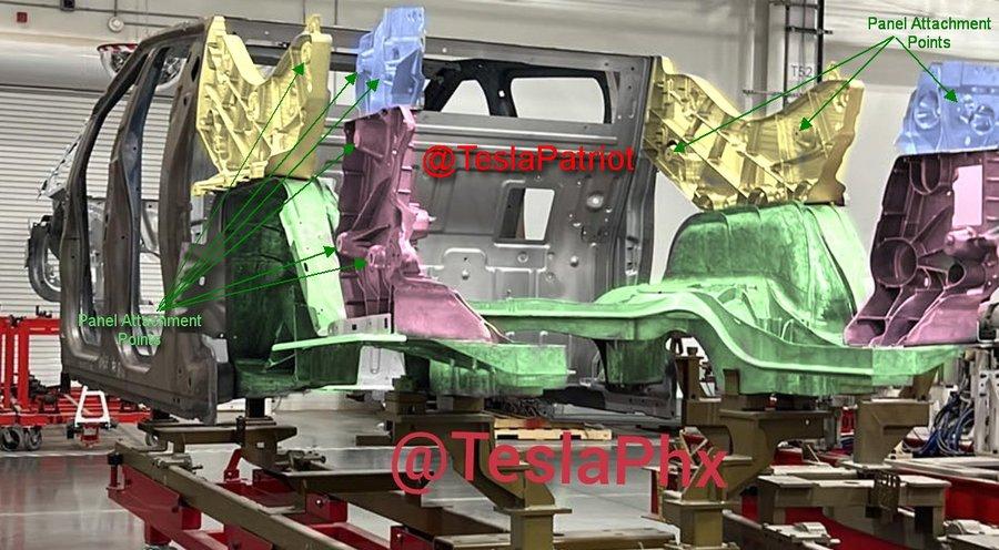

a 4-week old follow up with Cory at Monroe, where he more or less backpedaled his prior “not an exoskeleton” comments to instead drill into how a unibody is essentially an exoskeleton, and that the CT’s most exoskeleton-like qualities will be at the rear end

Not really interested in the word “exoskeleton”, but instead the substantive descriptions Musk made about what he meant by that term - and the degree to which the production CT makes good on those descriptions.
" [T]he functionality I’m going to describe is within a space that is less than the most popular pickup truck in the United States, the F150... [W]e’re able to achieve much greater capability in the same dimensions, same weight ... [due to a] fundamental design change, we moved the mass to the outside. We created an [BLEEP BLEEP].
So normally the way that a truck is designed, you have a body on frame, you have a bed on frame and the body and the bed don’t do anything useful. They’re carried like cargo, like a sack of potatoes....
The key to creating an effective monoplane was a stressed skin design. You move the stress to the outside skin. Allows you to do things that you can’t do with a body on frame. So we’re able to make the skin out of thick, ultra hard stainless steel."
On a strict read of the above: the [BLEEP BLEEP] is [a complete] fundamental design change, that moved [all] the mass to the outside, has [no] 'body on frame' elements, has [no] 'bed on frame' elements, and [all] the stress is moved to the outside.
On a lenient read of the above: the [BLEEP BLEEP] [includes] a fundamental design change, thta moved [some] of the mass to the outside, has [some] 'body on frame' elements, has [some] 'bed on frame' elements, and [some] of the stress is moved to the outside.
In this whole thread, I'm only pointing out that the lenient read continues to be displayed in the BIW photos. The strict read was propagated by some, whose followers now say Tesla reversed course. That the lenient read is still viable, may just go to show that the strict read was never the correct in the first place.
