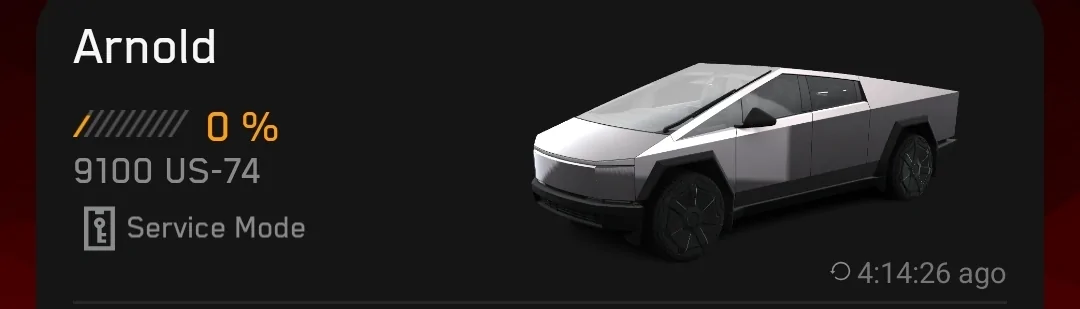

Am I being pedantic, or is long periods of SOC at 0% bad?
SoC at 0% is not zero volts. There’s still quite a bit of power in the tank at 0%.
Lithium cells are very happy at low SoC, but very sad if completely discharged.

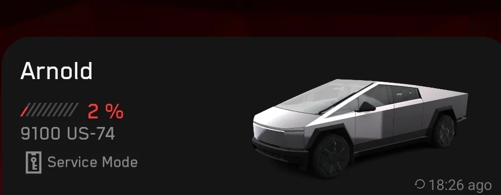

It's dropping rapidly it seems all by itself
