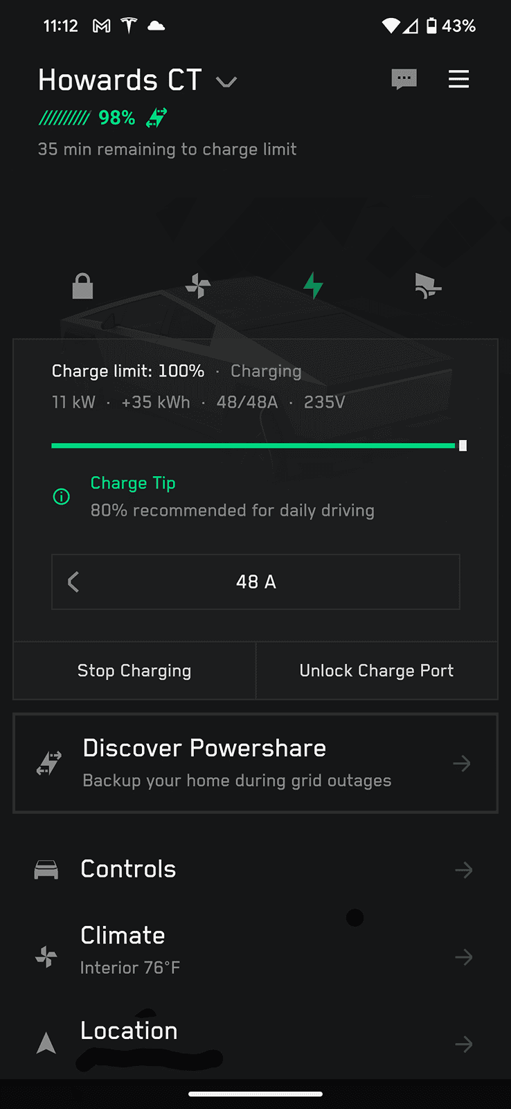

Powershare just showed up! I needed full 100% charge as I am going to a friend's house and they have no 220 plugs. I was just checking to see how it was doing and notice Discover Powershare.
Tesla Cybertruck PowerShare Rolling Out! (Updated Images) 1000002261

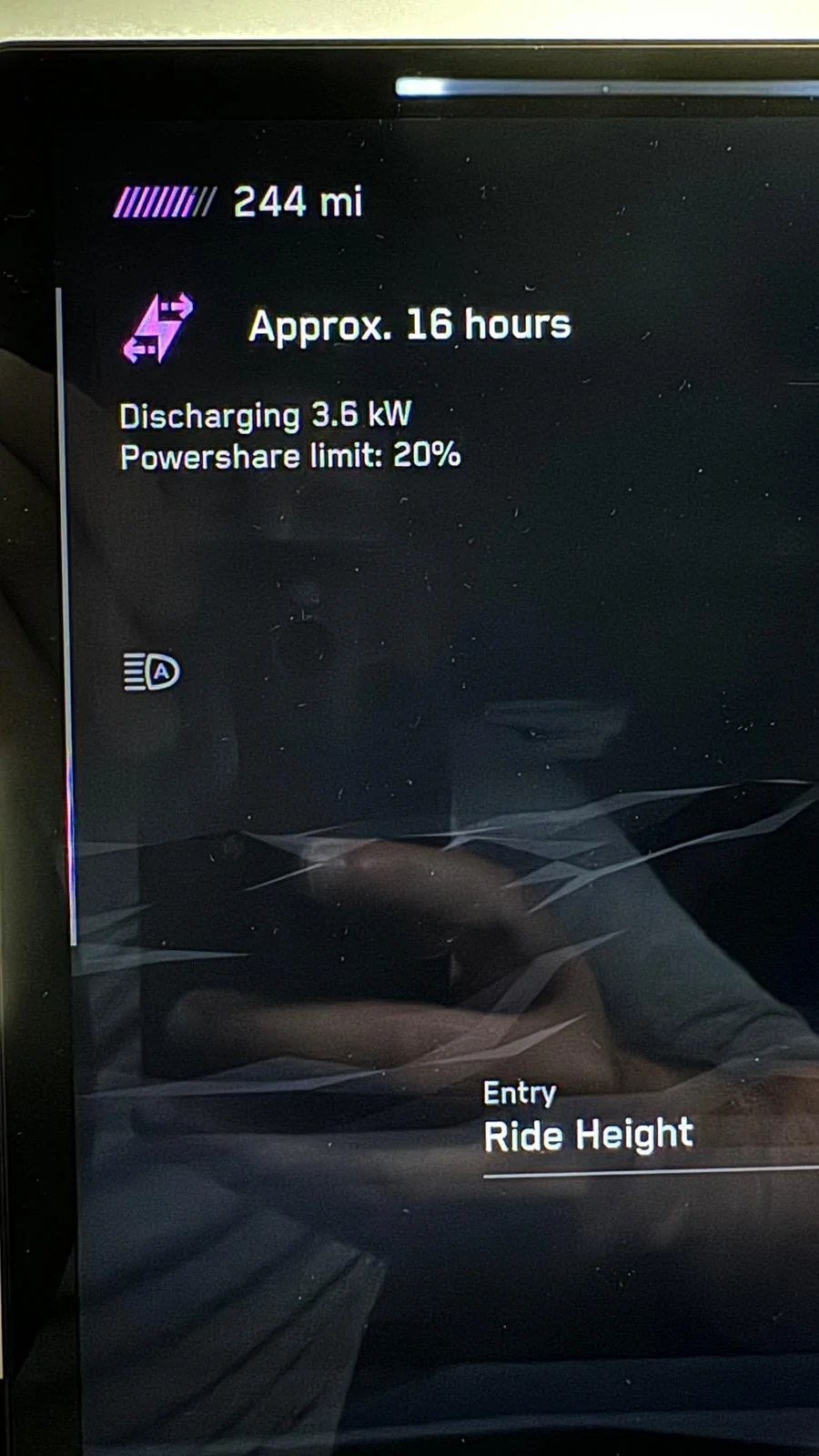

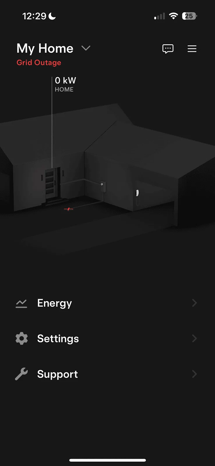

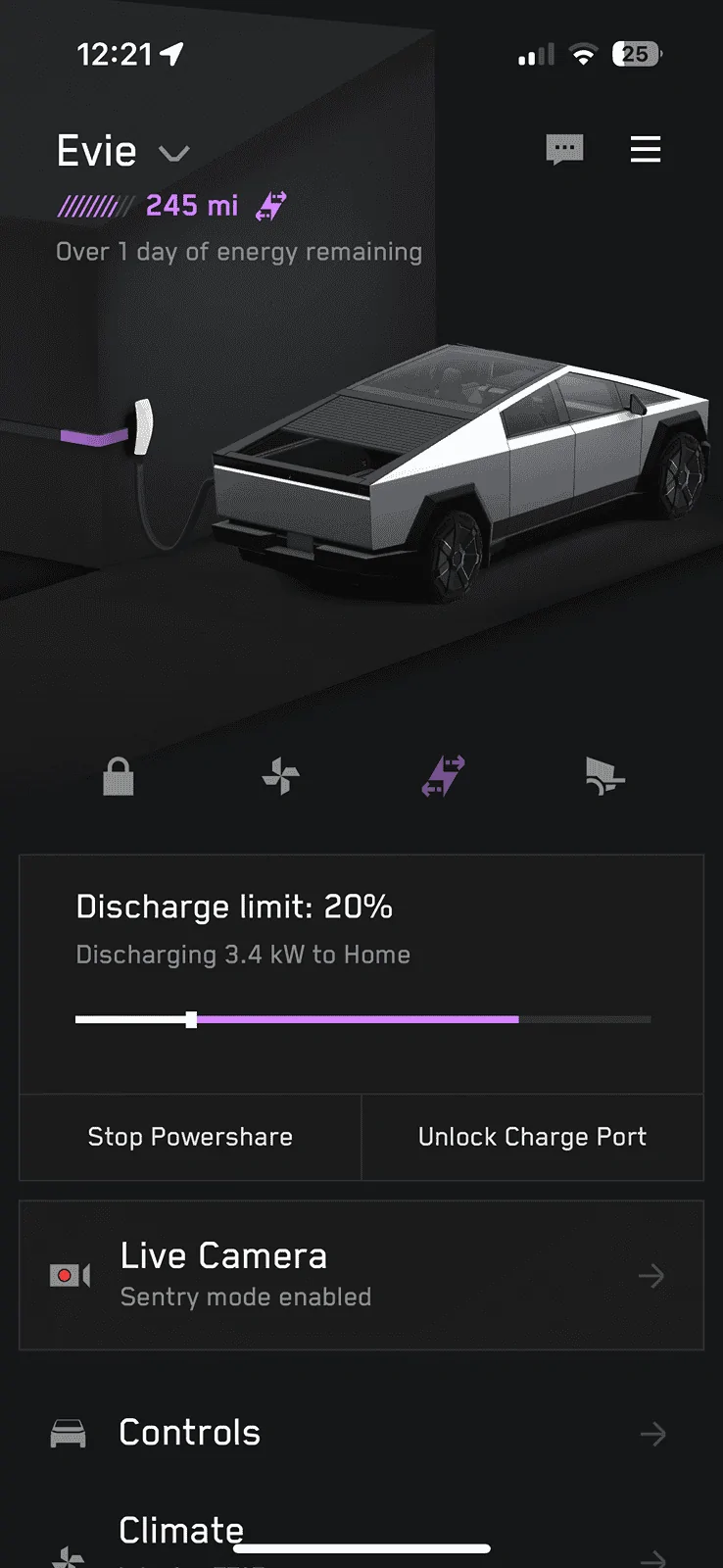

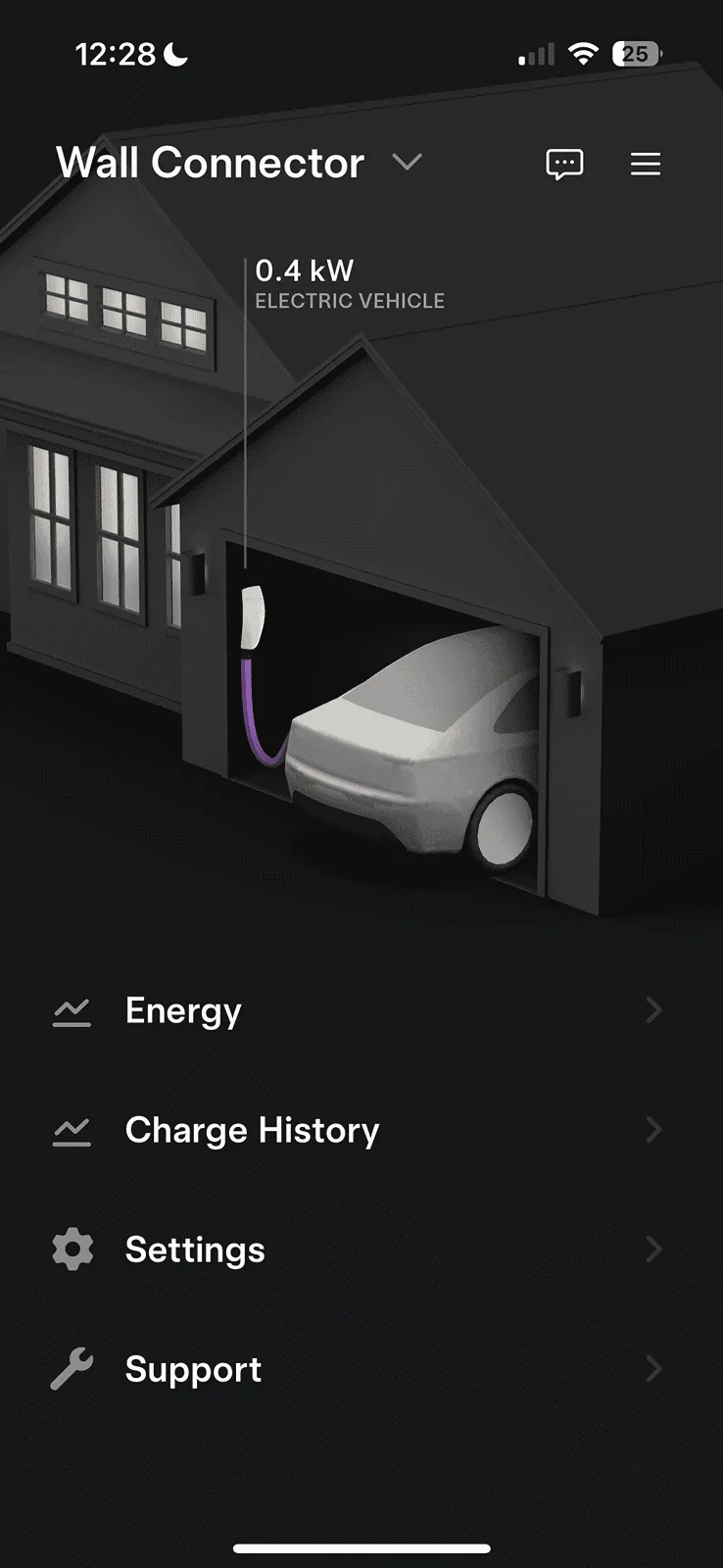

Here is an update with PowerShare working and powering my house! Sorry it took me so long to get these up!
Images captioned below, but first a few observations.
  • The truck was awake when I tripped the breaker in the gateway, so it started delivering power within 5-7 seconds. It was quick and started providing power right away! But it’s not seamless, expect to reset clocks on things!
  • When the grid power comes back on the app tells you that power is restored and the gateway will switch back to grid power within 5 minutes. I was told this was to avoid multiple quick grid failures and it switching on and off. (Screenshot below)
  • When the gateway switches back to the grid this was NOT seamless either (slightly disappointing). So don’t reset your clocks until back on the grid, or you will have to do it again
  • For things you want to have constant power, I will be using small UPS power supplies to keep them running for a few minutes while the switches on/off take place. (Like my modem and router)
  • I let the truck power my house for about 15 minutes. During that time, the energy usage varied from 0.4kW to 3.5kW. This was late at night with most things off and AC kicking on at times. Other than not being instant, it worked really well overall.
App showing power output and energy remaining. This fluctuates as usage goes up and down
Tesla Cybertruck PowerShare Rolling Out! (Updated Images) IMG_8949
Truck screen showing energy output and time left

Wall connector screen showing purple and power output to house.
Tesla Cybertruck PowerShare Rolling Out! (Updated Images) IMG_8956
Gateway screen showing the outage. Doesn’t show energy usage on PowerShare. This screen usually shows grid usage
Tesla Cybertruck PowerShare Rolling Out! (Updated Images) IMG_8957

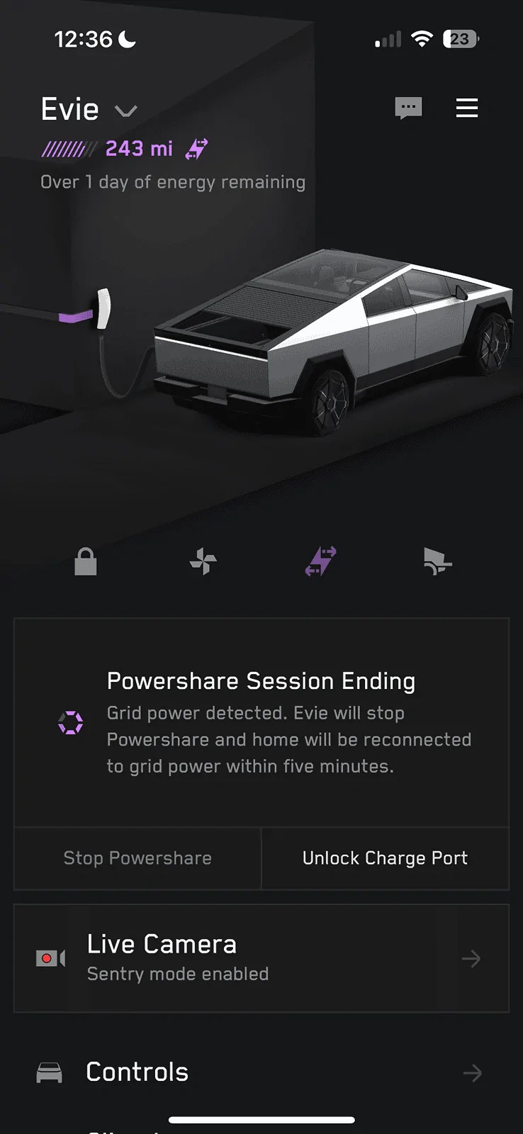

App screen showing “PowerShare Session Ending” message when grid power was restored. The little purple circle blinks to indicate when it will switch over. I think it’s just an indicator for a 5min. timer.
Tesla Cybertruck PowerShare Rolling Out! (Updated Images) IMG_8964
