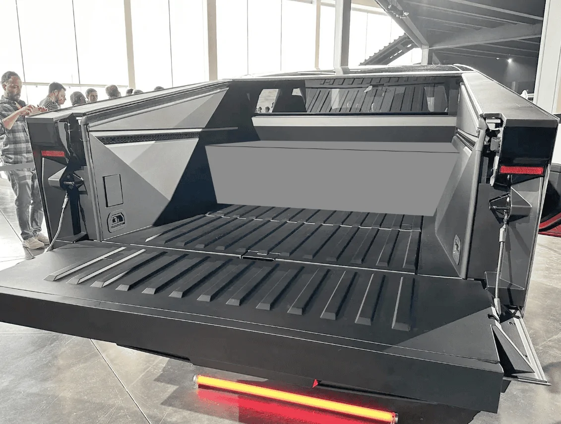

Looks like the top of the extender is finished like the bed floor, and there is quite a bit of space above it before you reach the bed cover. So you don’t truly lose 1/3 of the bed, you just lose 1/3 of a consistent flat bed floor.
Seems like either you have a certain view of what is “quite a bit” of space, or you’re not quite understanding the geometry of the bed
the bed floor to the top of the rear window is 28”, while the tailgate end of the bed is 19.8” high. The tonneau track and tonneau etc eats up 1.5” off the topmost height.
So ~26.5” headroom max at rear window, with ~18” headroom at the tailgate
Tesla Cybertruck Range Extender Battery Pack increases range to 470+ miles and costs $16K 🔋 D9DA11EC-B790-48C6-941D-7AD0E9A066D5
the extender comes up to the L-track, so is about 16-17” off the bed floor
that means that at the rear window, there is ~9.5” above the extender, at the rearward lip of the eave about 8.5” over the extender, and at the rearmost edge of the extender ~7”
basically, over the extender, there is a wedge-shaped void that’s is
51” wide X ~30” deep with a height running from 9.5” at its high side ~9.5” tall and low side around ~7” tall
Sthere space there? Yes.
Is there “quite a bit”?
I mean, there’s space for this tent:
Tesla Cybertruck Range Extender Battery Pack increases range to 470+ miles and costs $16K 🔋 1A22D4B8-0D68-4B5E-B24A-14D618DB4E27
meanwhile, folks shouldn’t be fooled by Musk’s off-hand comment that it only takes up 1/3 of the bed, as being about the depth it reaches into the bed
to your point, I believe he was at best referencing taking up 1/3 of the VOLUME of the bed
that extender reaches back into the bed closer to 1/2 than it does 1/3
I expect it’s right at about 35” back from the 6’ mark at bed floor, so leaving ~38” between the extender and the tailgate
Those are just volume and dimension stats.
in terms of utility, I think it reduces the bed’s utility by half to 2/3rds depending on use case

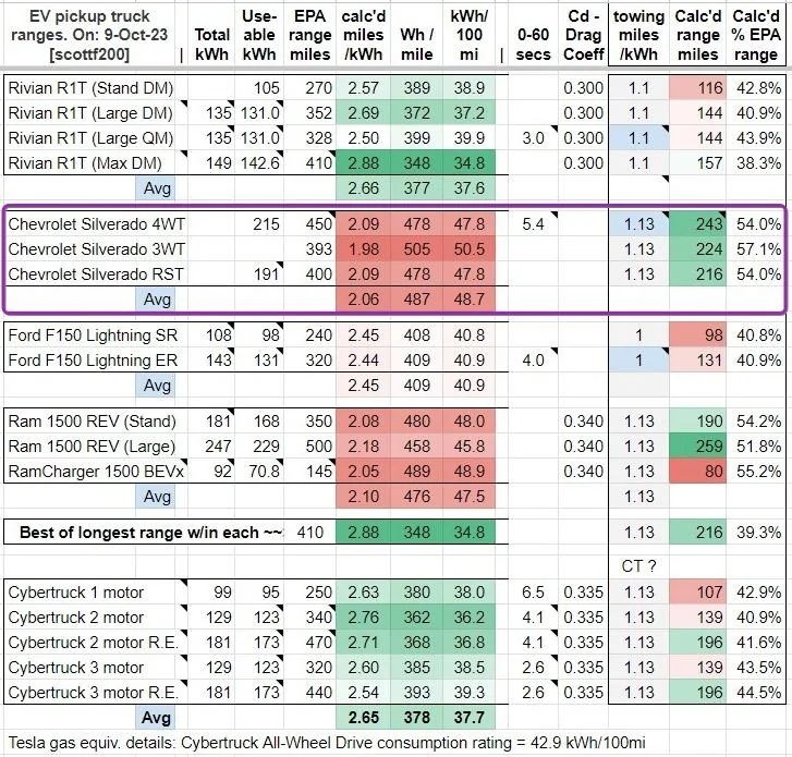

The Cybertruck has larger 4680 cells. I do not know if Tesla could stick more in the main pack. Maybe the 4680 cells are not as energy dense as Tesla had hoped. Maybe it’s a manufacturing yield issue, but something happened in the Cybertruck development that caused Tesla to settle for this inelegant and stupid solution. I need the entire bed and I need at least 400-450 miles of range. Have a Silverado EV reservation.
I followed the Silverado EV and watched a several youtube videos from their showcases that let people tow/drive them. There have been some good interviews with engineers as well.
I think it will do well if they can produce them as they meet the spec's they claim.
Not sure if you've seen other threads here with videos and discussions (example):
https://www.cybertruckownersclub.com/forum/threads/silverado-ev-tows-over-230-miles.9336/
Here is my spreadsheet that I've continually updated as I've gathered more details.
Tesla Cybertruck Range Extender Battery Pack increases range to 470+ miles and costs $16K 🔋 qwF4BLs

That Rivian Max miles/kWh doesn't make sense.
