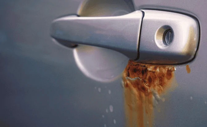

No more of this:
Tesla Cybertruck This may be Cybertruck's 2B stainless steel. Updated Scratch and Sniff* test. 1637871710913
Oh, wait, there won't be door handles!

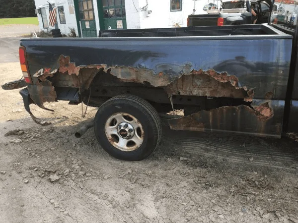

How about this:
Tesla Cybertruck This may be Cybertruck's 2B stainless steel. Updated Scratch and Sniff* test. 1637872009127

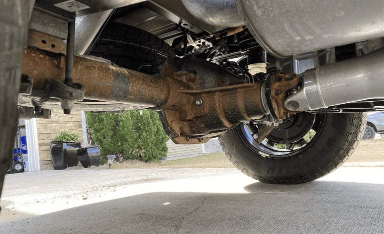

Of course it's not limited to trucks from Dodge:
Tesla Cybertruck This may be Cybertruck's 2B stainless steel. Updated Scratch and Sniff* test. 1637872134076

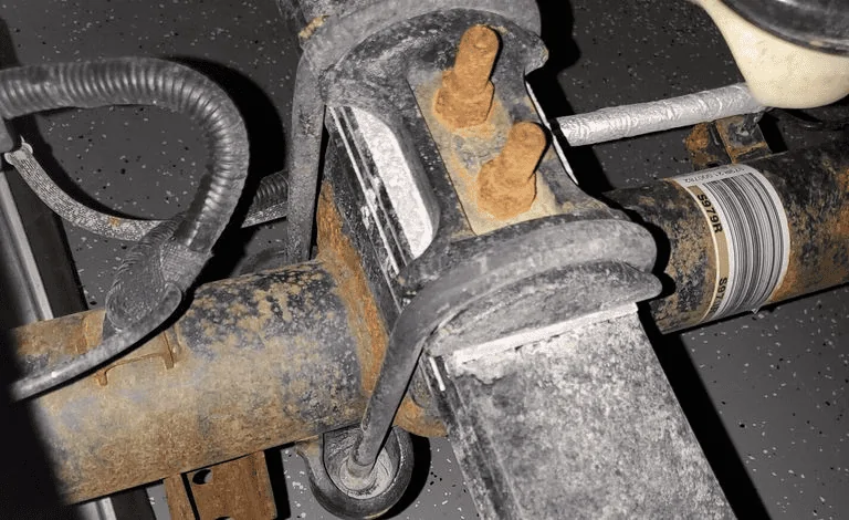

And it's not limited to older trucks either, a lot has to do with how much materials engineering went into the design and the quality of coatings used. Here's a 2021 Ford that is not getting a good start in life. This is how these trucks looked when delivered new!
Tesla Cybertruck This may be Cybertruck's 2B stainless steel. Updated Scratch and Sniff* test. 1637872384735
and:
Tesla Cybertruck This may be Cybertruck's 2B stainless steel. Updated Scratch and Sniff* test. 1637872443408
This is what happens when you cut costs at the owners expense. Ford's answer to this? Release a statement saying, "While some F-150 underbody steel components may show signs of surface rust, this will have no impact on part performance or life."
While I'll be the first to admit that a little surface rust is no big deal, look at those bolts! That's how the 2021 F-150 was delivered, brand new! Not a good beginning to your $45,000 brand new truck.

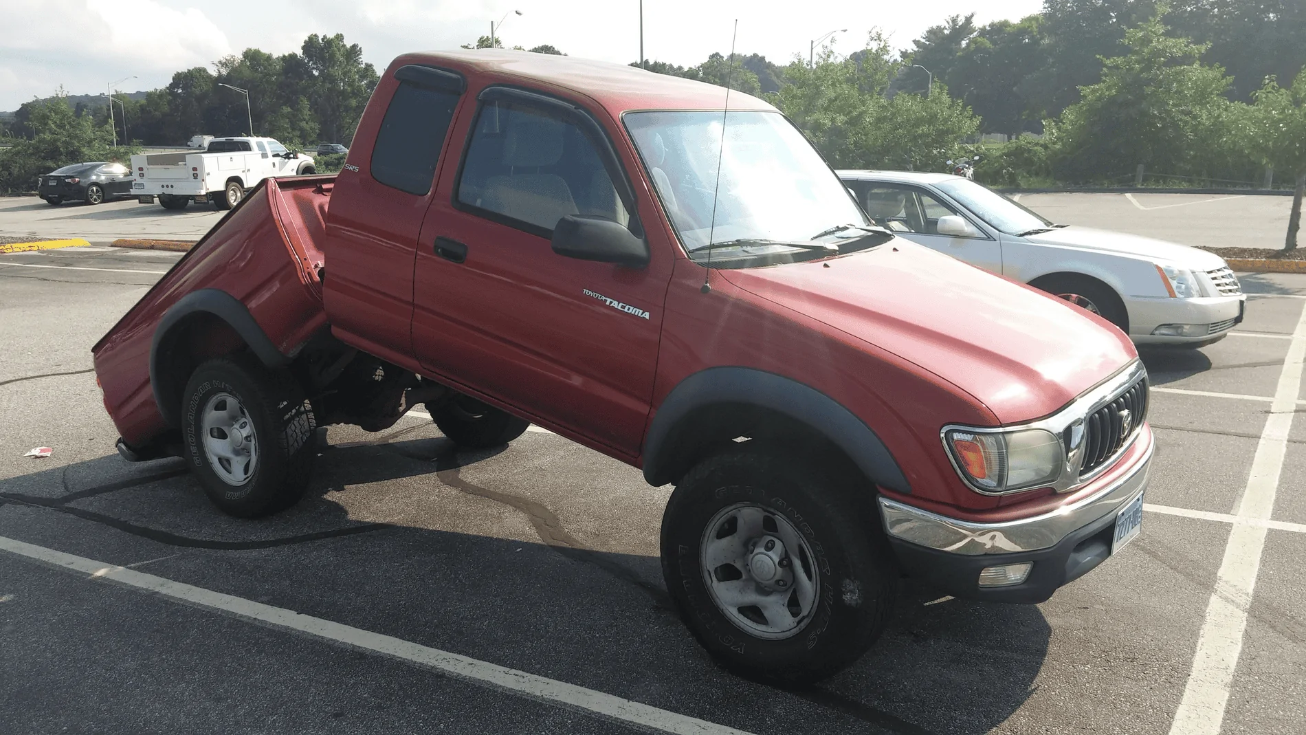

Think "Toyota quality" prevents rusted frames? Think again:
Tesla Cybertruck This may be Cybertruck's 2B stainless steel. Updated Scratch and Sniff* test. 1637872874536

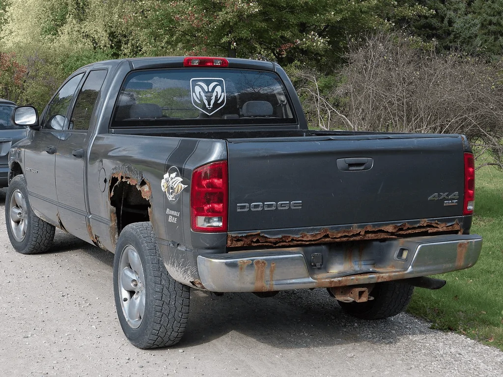

No more of this:
How about this:

No more of this:
How about this:
