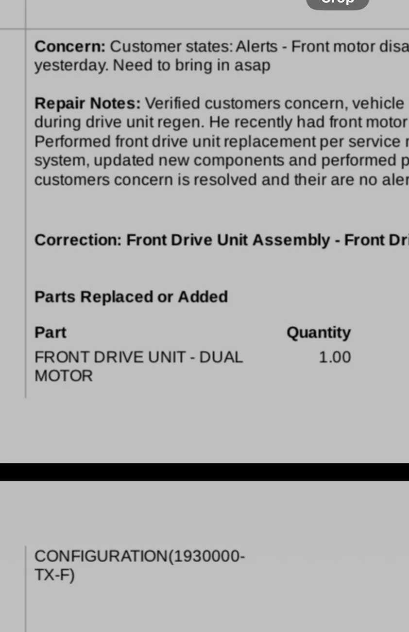

Not to be a party pooper but I had mine replaced with the exact same part number in november. It did not fix the sound for me.
Did you get rev -F or -G?

If the G version works I'm going to go ask them to change it out again. Does anyone know if the G version is the cure? F sure wasn't

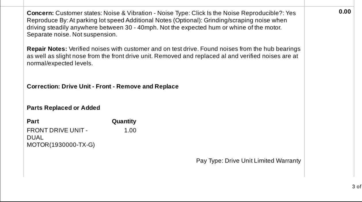

I posted in another thread, but I'll post here too. I had this exact same issue since day 1 (AWD - 53,XXX VIN - 11/24 inventory) when I drove it home. My closest service center wouldn't help. I was persistent as I got to the point I wanted to sell it despite loving every other thing about it, so took it to the next closest service center. They agreed it wasn't right. Replaced the hubs, didn't help. Replaced the FDU (revision G if that matters) and now it's soooooooo quiet. Just like my other Tesla's and I couldn't be happier. I guess just need to find a SC that cares.
Hammy60, has the noise retuned at all on yours? Others have stated the noise came back after 1,000 miles or that the front drive unit part ending with F did not resolve their issue.
I’m taking mine in for service in a couple weeks and was going to reference your post. Maybe FDU part # 1930000-TX-G is the winner here?

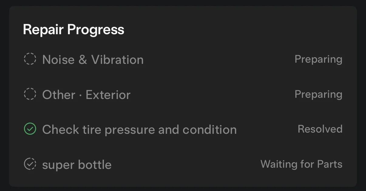

Did you get the G motor installed? Any update?
They pushed my pickup date a couple times. Last time they pushed it, they added a “super bottle” to the service ticket. I’m guessing they mean the bottle for the super manifold; couldn’t find “super bottle” in the EPC. So far, it’s ‘waiting for parts.’
Damn
