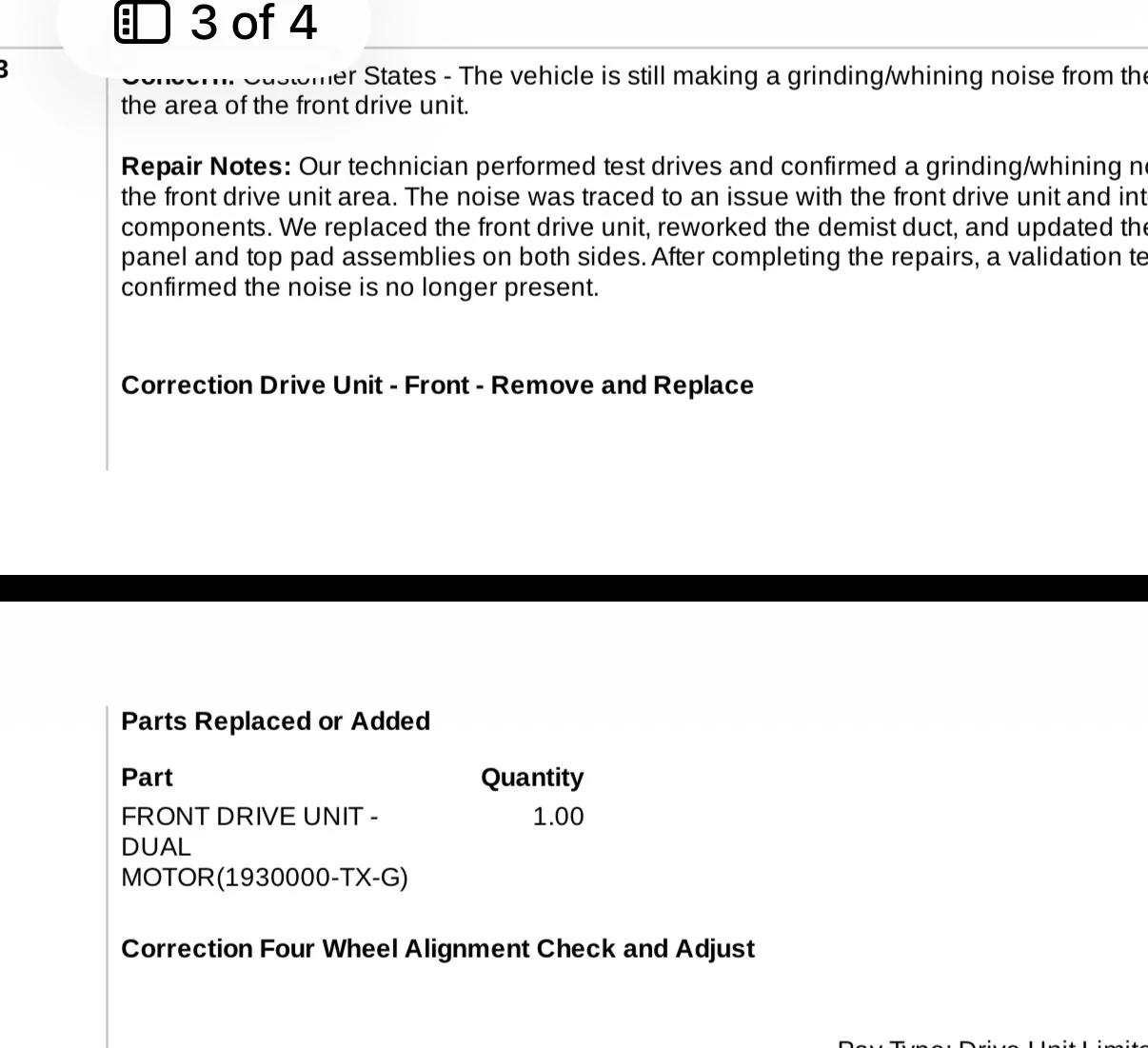

Would you mind sharing a screenshot of your invoice? I have a service appointment tomorrow and see they have the F version listed on the estimate to replace. When I brought up that this didn’t work for others and suggested the G version they told me that part isn’t currently available.
Sif
Sean
Mar 4, 2025
Virginia
2024 Cybertruck
Tesla Cybertruck Wind, Bearing, or Coolant Noise? IMG_1568
Let me know if this is all you need!
I see you had the FDU replaced twice. Was the first time the F or G version?
What day was it they put the G version in?
