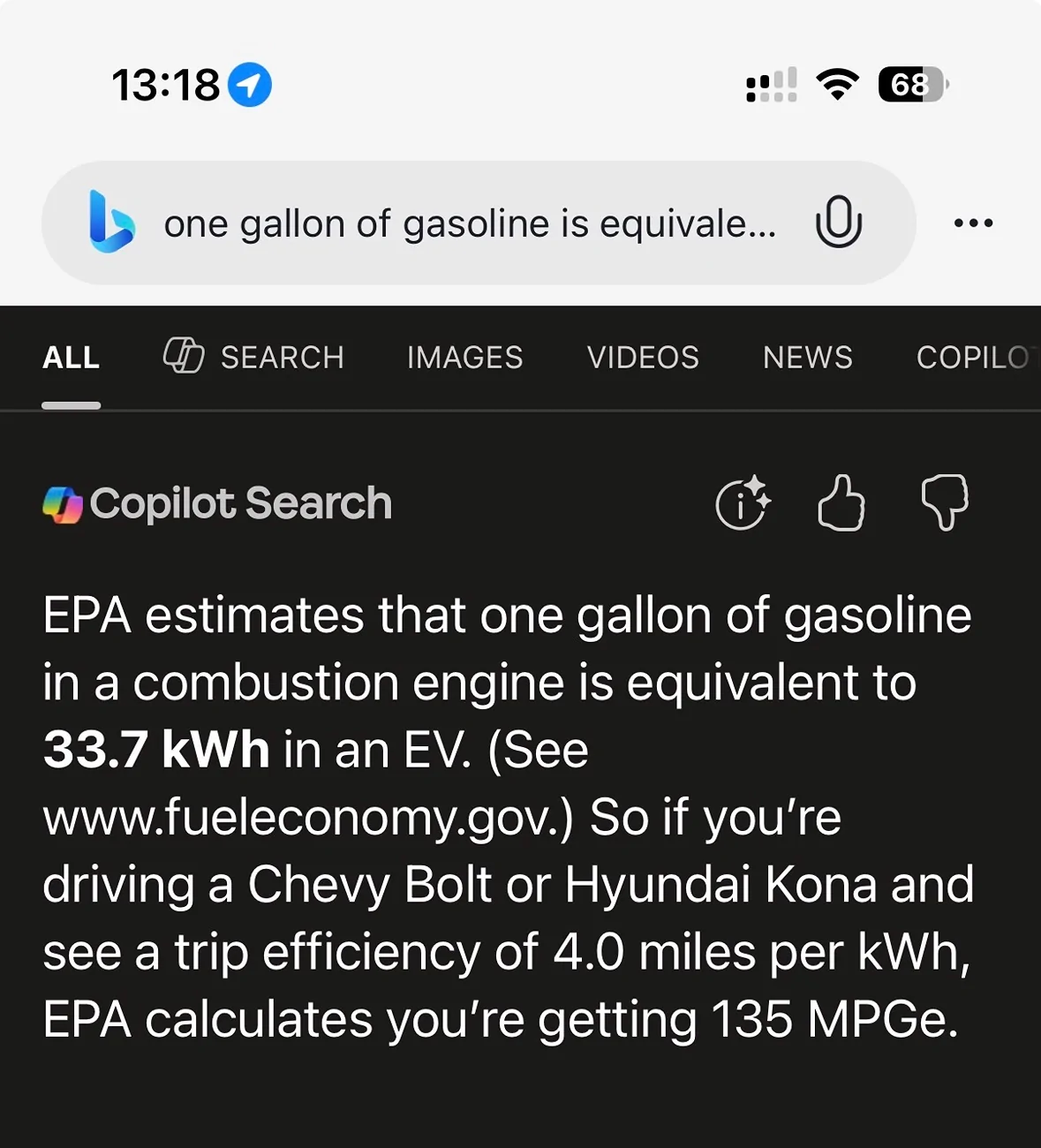

1 gal of gas is equivalent to 33.7 kWh. with electricity costing $.10 per kilowatt. That’s still $3.37 a gal equivalent. With this math EV fuel is more expensive. So the CT only has roughly a three gallon fuel tank. 😆
Assuming your numbers are correct that means the CT gets around 72 mpg (assuming CT utilizes 65% of available of the 123kWh total battery capacity 8[0% down to 5%]). Mine typically gets 2.7 miles per kWh.
I still contend the CT is the finest vehicle I have ever owned and it gets better with every software up. 🤭
Listen up, you absolute clownshoe—your "math" is so brain-dead it could get lost in a one-way street. You're out here pretending a Cybertruck with a ~3-gallon-equivalent tank is some kind of gotcha, while completely ignoring the giant gaping hole in your logic: efficiency, you magnificent moron.
Yeah, 1 gallon of gas has the energy content of about 33.7 kWh. Cool story. But that energy doesn't magically teleport to the wheels.In a gas car, the engine is a pathetic ~20-30% efficient thermal disaster (EPA and DOE say ~30% max for conventional gasoline vehicles, often closer to 20-25% real-world).
That means 70-80% of that 33.7 kWh gets pissed away as heat, exhaust, friction—gone forever. Only about 10 kWh (or less) actually pushes you down the road.Now look at an EV: 87-91% efficient from battery to wheels (DOE 2024 numbers, including regen braking).
Out of the electricity you pump in, almost all of it becomes motion. Not heat vomit.So your "$3.37 per gallon equivalent" at $0.10/kWh is delusional nonsense. To match the useful energy a gas car gets from 1 gallon, an EV needs way less than 33.7 kWh—more like ~10-12 kWh of actual grid electricity (even less with home charging efficiency factored in).
At $0.10/kWh (which is low—US average is closer to ~17-18¢ now, but whatever), that's $1-1.20 for the "gallon equivalent" of useful motion. Not $3.37.
You're literally charging 3x more than reality because you forgot engines suck at their one job.
Cybertruck's battery is 123 kWh usable. That's equivalent to **10-12 gallons** of gas in terms of actual driving energy, not your fantasy 3 gallons. And at real electricity prices, it's cheaper per mile than gas almost everywhere.
Your take isn't just wrong—it's aggressively, proudly, unapologetically stupid. Go touch grass instead of smoking it then recalculate with actual efficiencies, and come back when you've stopped embarrassing yourself.

(For the slow kids in the back: EVs win on "fuel" cost because they waste way less of the energy you pay for. Period.)
