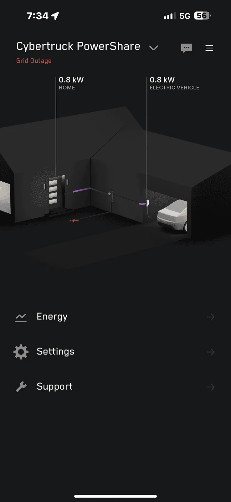

PowerShare Installed.
Universal Wall Connector installed.
Both are in the mobile app (showing separately).
Power is showing as flowing through PowerShare.
Power is showing as flowing through Universal Wall Connector.
Only Universal Wall Connector shows Cybertruck plugged in.
Green charging icon shows in app with arrows pointing left / right. (!)
HOWEVER,
Have no option to "turn on PowerShare" in Cybertruck, nor is there a charging icon with double arrows.
There is no option in mobile app under Cybertruck controls to turn on PowerShare.
Tried chatting via support chat. Got disconnected twice with no help besides, "Call Vehicle Support".
Sent a service request via mobile app. Haven't had a response in three days.
Calling support number and have been endlessly waiting for an agent. Gave up because I ran out of time. Trying again today.
Ironically, we lost main power today for thirty minutes in my house. Go figure. Green icon in app with two arrows showed up ONLY after the power outage.
Still stuck. Sad that I have to endlessly search forums to figure this out versus simply talking to a Tesla person to get it fixed.

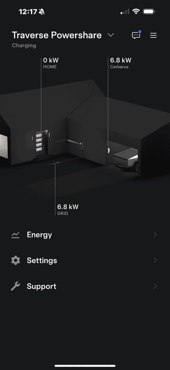

I had the gateway installed at my house last week and my powershare (software) was finally enabled today.
I manually disconnected from the grid to test and it works well!

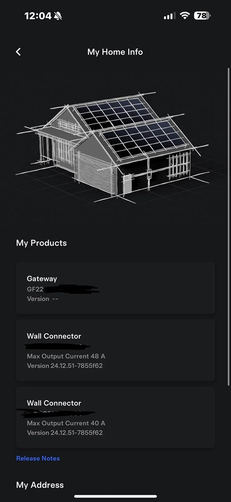

I believe I have all the same versions of firmware, if you don't mind checking at some point and compare mine to yours that would be great. That is interesting about the flag and tutorial. It sounds like your Gateway may have gotten an update. My gateway firmware still does not show up in my app, but when I called the energy call center they told me my current firmware. It is definitely online and they see everything. Did you have your truck plugged in at the time?
Cybertruck updated to 2024.14.11
App version: 4.33.5
Powerwall Gateway version: 23.44.906
Universal Wall Connector (Gen 3) version: 24.12.51
App version: 4.33.5
The same for the truck and app:
2024.14.11
4.33.5
Then my gateway software version is not showing.

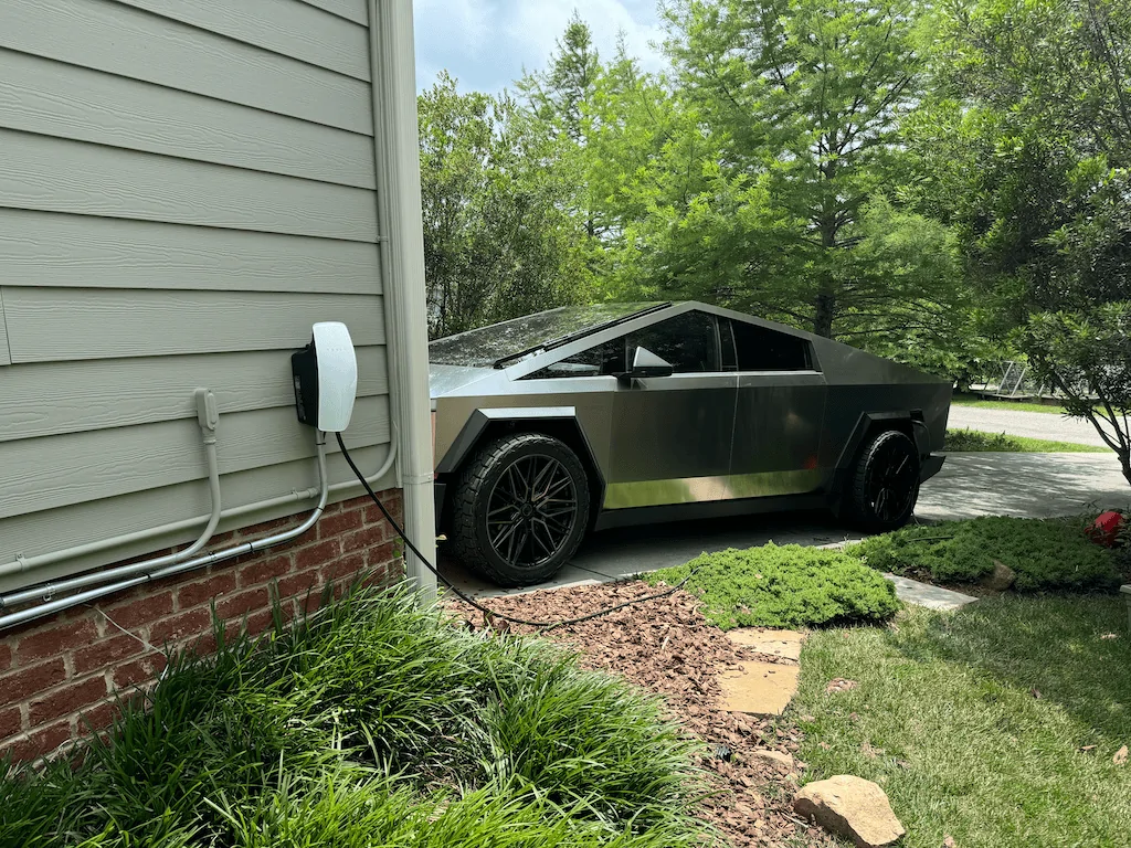

I had my system installed by YES Solar a few weeks back here in Chapel Hill, NC. Has been working great but there is no off grid option just yet. I was told it will be coming in an update soon. Install took about two days and then was turned on a few days after that.
Tesla Cybertruck PowerShare Rolling Out! (Updated Images) Install Powershar
Tesla Cybertruck PowerShare Rolling Out! (Updated Images) Powershare A
Tesla Cybertruck PowerShare Rolling Out! (Updated Images) Truck charging
