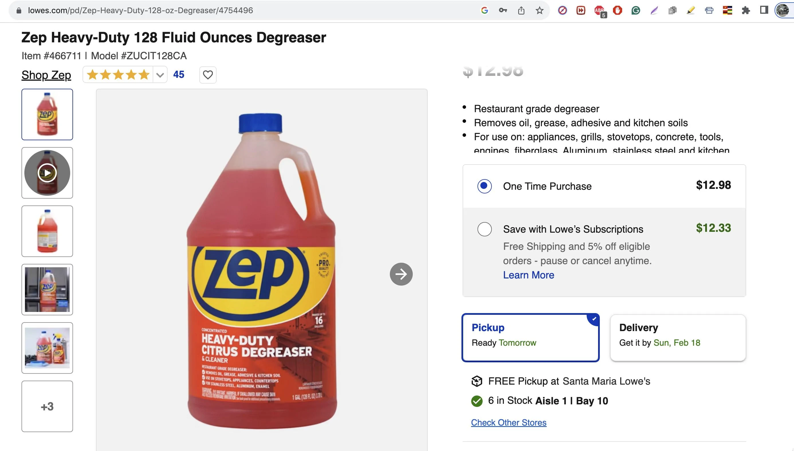

I would try a product similar to this one first if such condition of SS has some corrosion.
Tesla Cybertruck Rust Spots/Corrosion is the Norm Zep Heavy-Duty 128 Fluid Ounces Degreaser in the Degreasers department at Lowes.com 2024-02-1

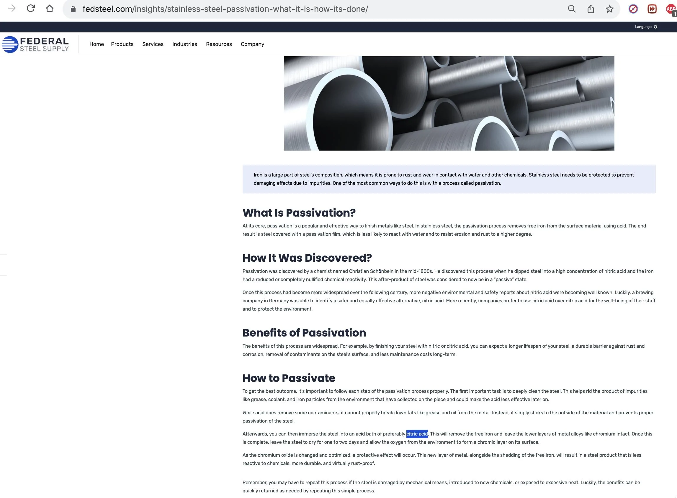

Tesla Cybertruck Rust Spots/Corrosion is the Norm Stainless Steel Passivation:
