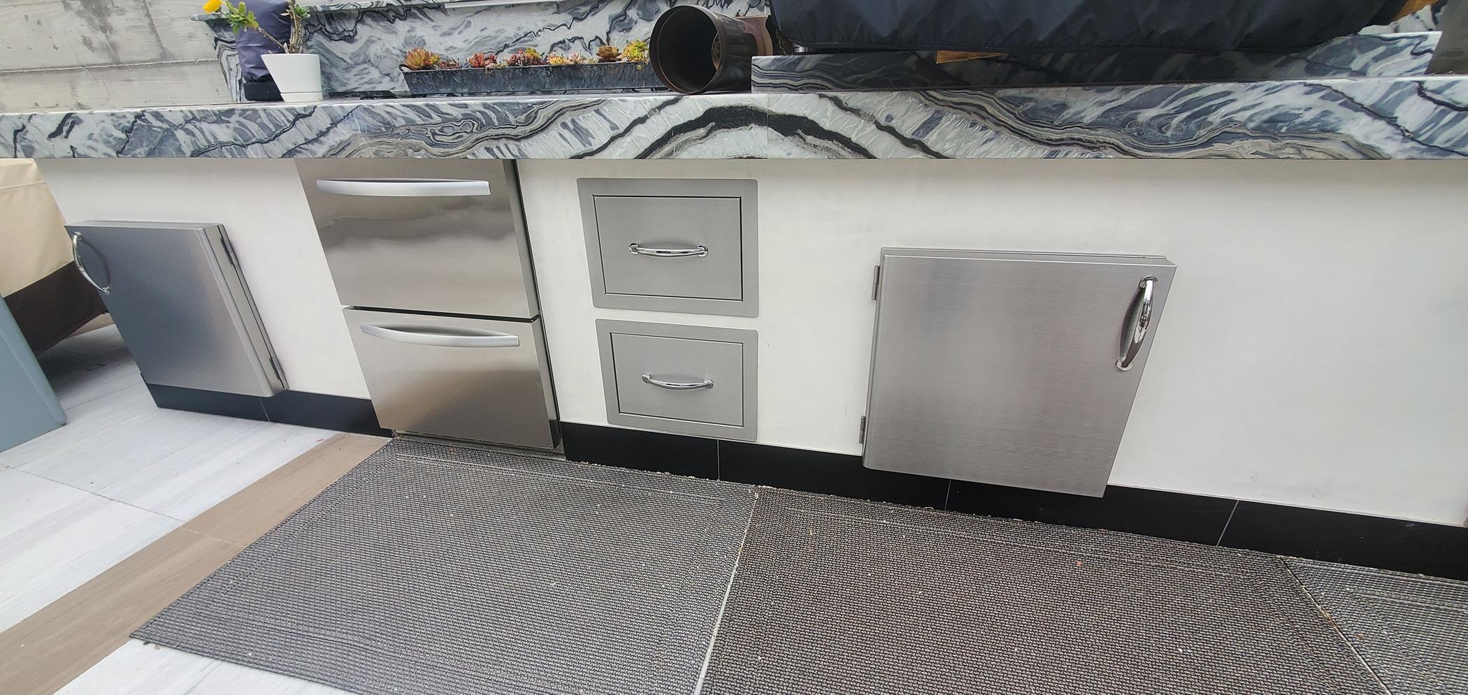

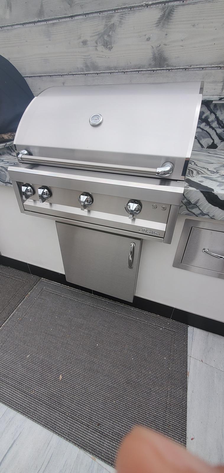

Take a look at the ProtectaClear instructions as it applies to prepping the truck before the final application. I bought a kit and tested ProtectaClear on my outdoor kitchen for practice as I wait for delivery later this month ( stainless steel cabinets/drawers, BBQ etc.) the results are fantastic. My stainless steel BBQ and other components have never looked this good and the metal feels smooth too. The application method is easy but takes a bit of discipline and patience and the instructions with the kit are quit detailed.
Can you put that on high temp applications like a BBQ or did you just do the accessories?
Mind sharing a pic, my outdoor kitchen has a ton of SS and housekeeper hates keeping it clean.
I've used the BBQ once after ProtectaClear application. No problems with heat yet. I did also apply to drawers, fridge and cabinets too. This stuff works so good I'm going to do this to the fridge and d/w inside too since housekeepers never get it right. I thought it was weird posting BBQ pics to a CT forum but here you go. I mostly wanted to practice with how this product goes on before wiping it on the truck.

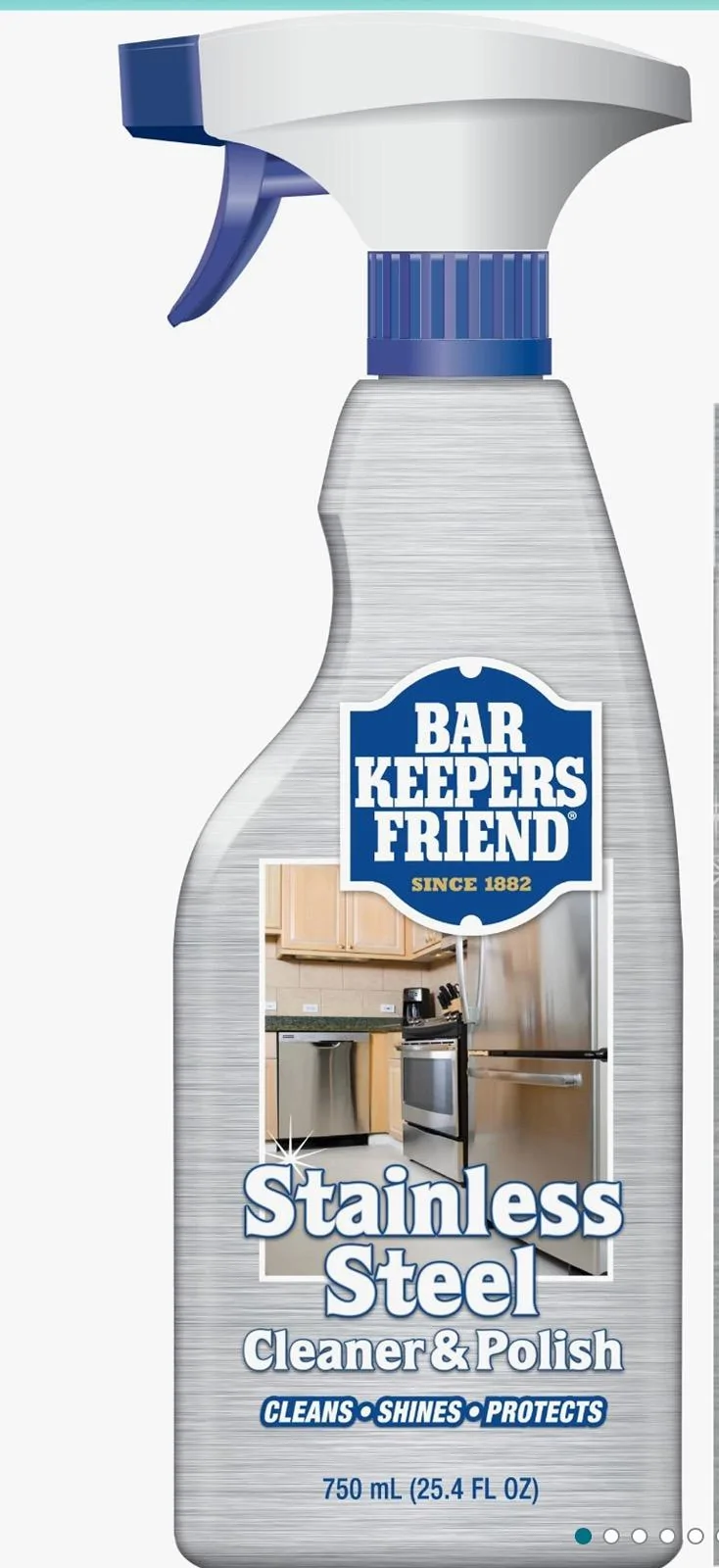

Is this the Bar Keeper spray you used?
