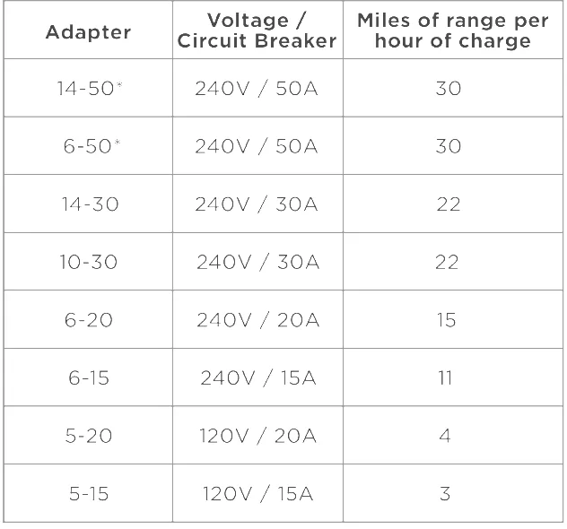

I'm just wondering what I'll be using to charge the CT with at home. I have two 240v 50amp circuits setup and I have two NEMA 14-50 outlets at my garage. Hopefully this will suffice.
The beauty of Teslas is that, with the appropriate mobile charger connector, you can plug into multiple sources (other than Superchargers). I frequently top off mine when I travel by plugging the mobile charger into a simple 110V outlet. The rate of charge will, of course, be impacted by the amperage supported by the plug, but if you have NEMA 14-50s you should be good to go.
No doubt one NEMA 14-50 is what it would take.
Or their 44 MPH Wall Connector
"Wall Connector is compatible with Model S, Model 3, Model X and Model Y and is capable of providing up to 44 miles of range per hour of charge, with up to 11.5 kW / 48 amp output, depending on model."
Depending on the CT battery size and efficiency those 30 and 44 miles of range per hour will change ... but multiple 10 hrs of overnight charging and that is a LOT of daily miles (plus on the job site V2L help).

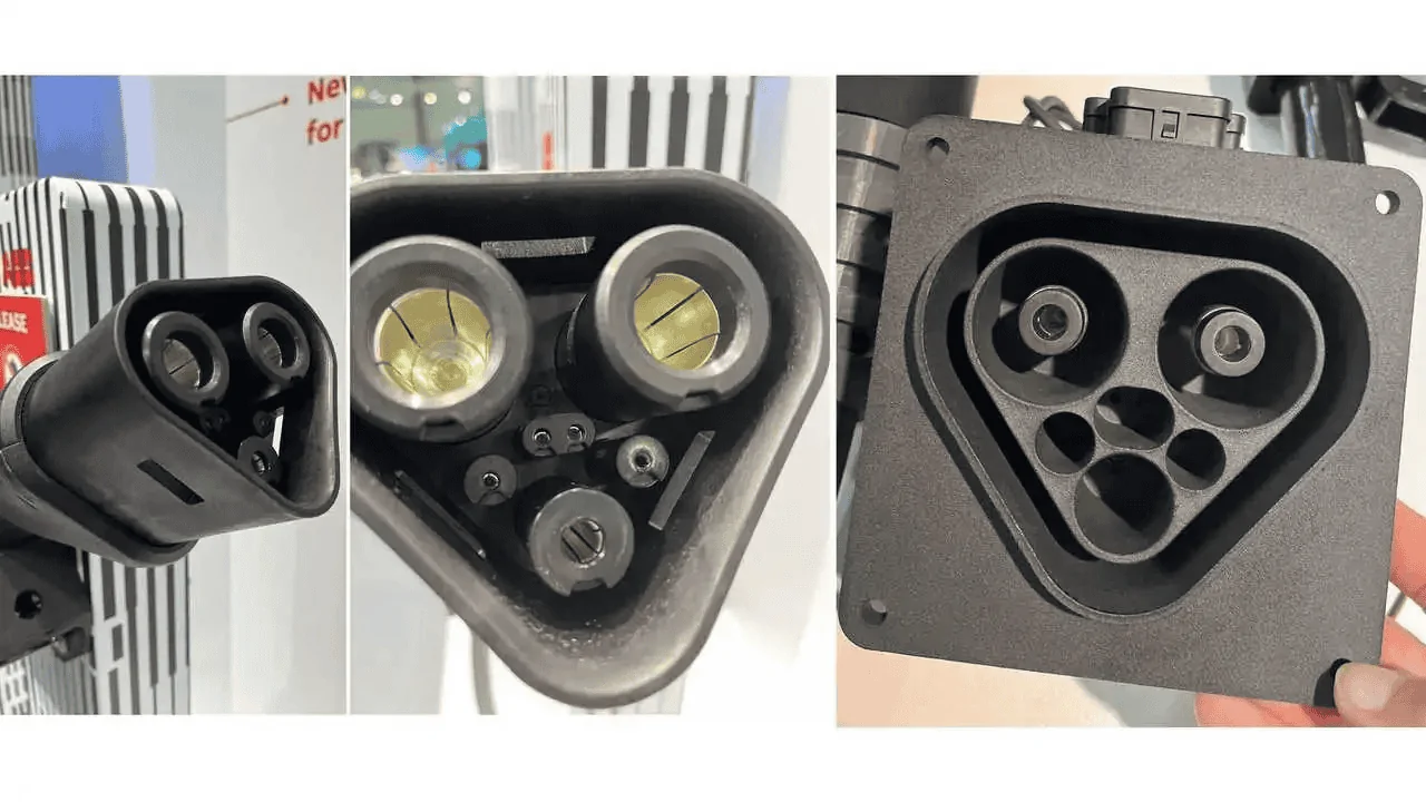

For those of you who have asked, Tesla is adopting MCS for Semi (maybe CT?). From what I recall though, the updated connector is triangular as shown:
Tesla Cybertruck Cybertruck Megacharger compatibility possible? After Megacharger stall for smaller vehicles spotted 1690476746182
The square one is V2 while triangular is V3.
As far as CT is concerned, the inlet is a lot smaller and maybe could fit where we're seeing the NACS inlet on the left-rear fender.
