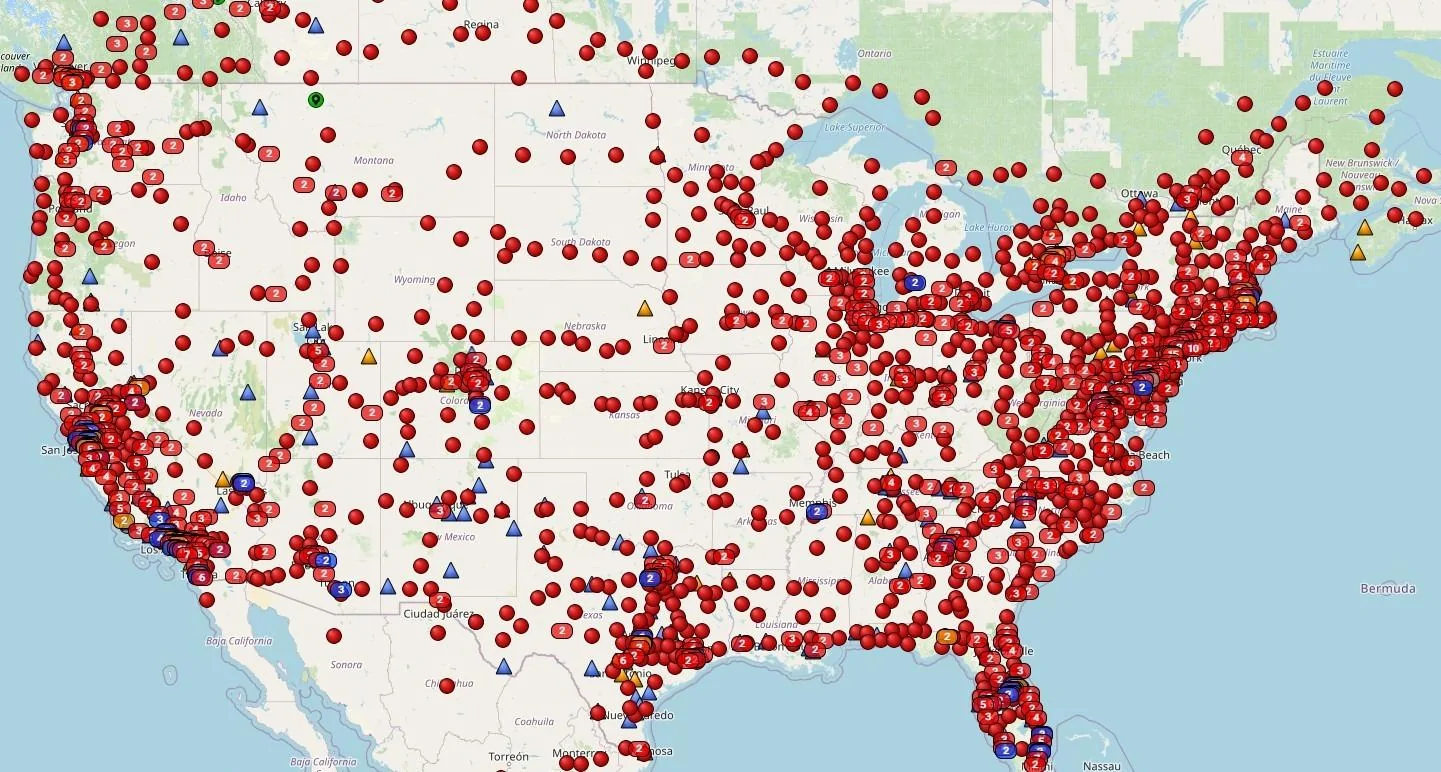

If you try to extend your distance between charges, the charging time increases dramatically. Not very comfortable for road tripping.
We often try to get our SOC fairly low at our lunch charging spot as we will stay there a little longer to eat and chill. Otherwise, if we drop below 100 kW, I evaluate if I can skip the next charger with just a little extra and if not then off we go.
Routes over the past few years have really come along so much I just start picking the amenities and such around them because there are so many.
Especially if you consider v2 Superchargers still (if driving a Tesla, otherwise v3+ soon).
I totally agree, it makes a huge difference in trip time. A Model 3 or Model Y (or any other Tesla that isn't charge limited) when plugged into a V3 350 kW Supercharger and properly conditioned, can add about 100 miles in 5 minutes, if below 5%. That's a third of a battery!
Wait for 10-15 minutes and you are at 50%. Go any further and the times just get longer.
It just happens that @scottf200's 100 kW represents the charge at about 50% charge.
Supercharges are generally every 50 miles. There are stretched in the Midwest where it goes to 100 miles, and those dots where you can't see daylight are usually 25 miles or closer.
My wife was coming home this evening on a 250 mile trip. She did the trip up this morning and with a little driving around, she pulled into the charger at under 5%. She spent about 10 minutes at her start, and another 15 minutes half-way. She spent a little more time so that she would be around 30% upon arrival.
So 25 minutes to get more than a full battery charge.
As opposed to 40 minutes to do a 20-80% charge.
