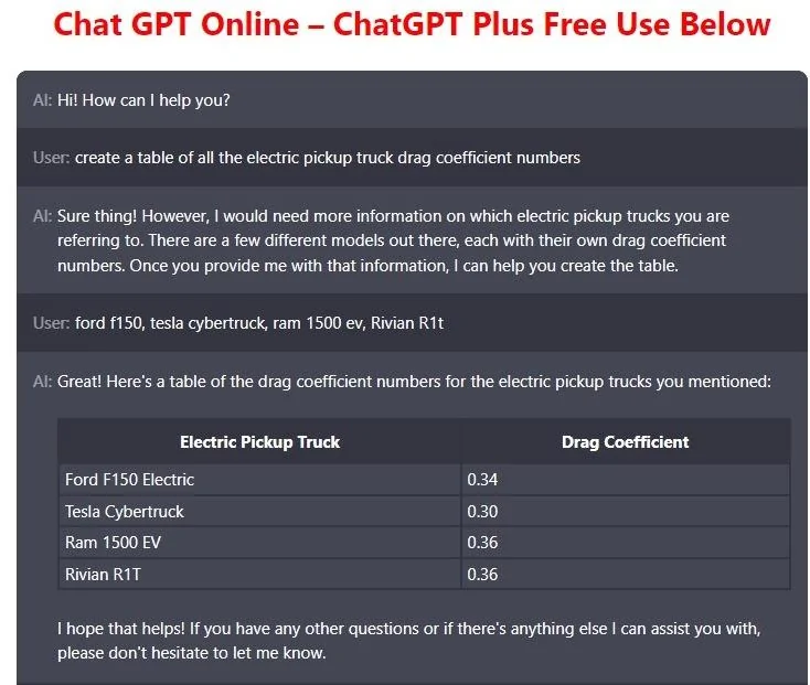

*1 RAM 1500 EV claim is 0.34 drag coefficient.
*2 Rivian says the R1T has a drag coefficient of just 0.30 Cd
*3 Ford F150 Lightning 0.?? coefficient
*4a Elon tweet exact text: "With extreme effort, Cybertruck might hit a 0.30 drag coefficient"
*4b Aleix Lázaro Prat, a CFD Engineer for Numeric Systems: CT drag coefficient of about 0.39 Cd
Tesla Cybertruck Ram 1500 REV - 350 mi (168 kWh)  & 500 mi (229 kWh) FS2iHCf

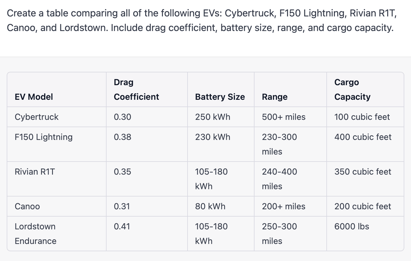

Umm. I guess it’s my day to be picky.
ChatGPT is not an authoritative source for much of anything. It can and will just make shit up if it doesn’t have accurate facts. It’s not even consistent between runs.
If I check ChatGPT, I get this.
Tesla Cybertruck Ram 1500 REV - 350 mi (168 kWh)  & 500 mi (229 kWh) 1680738288969

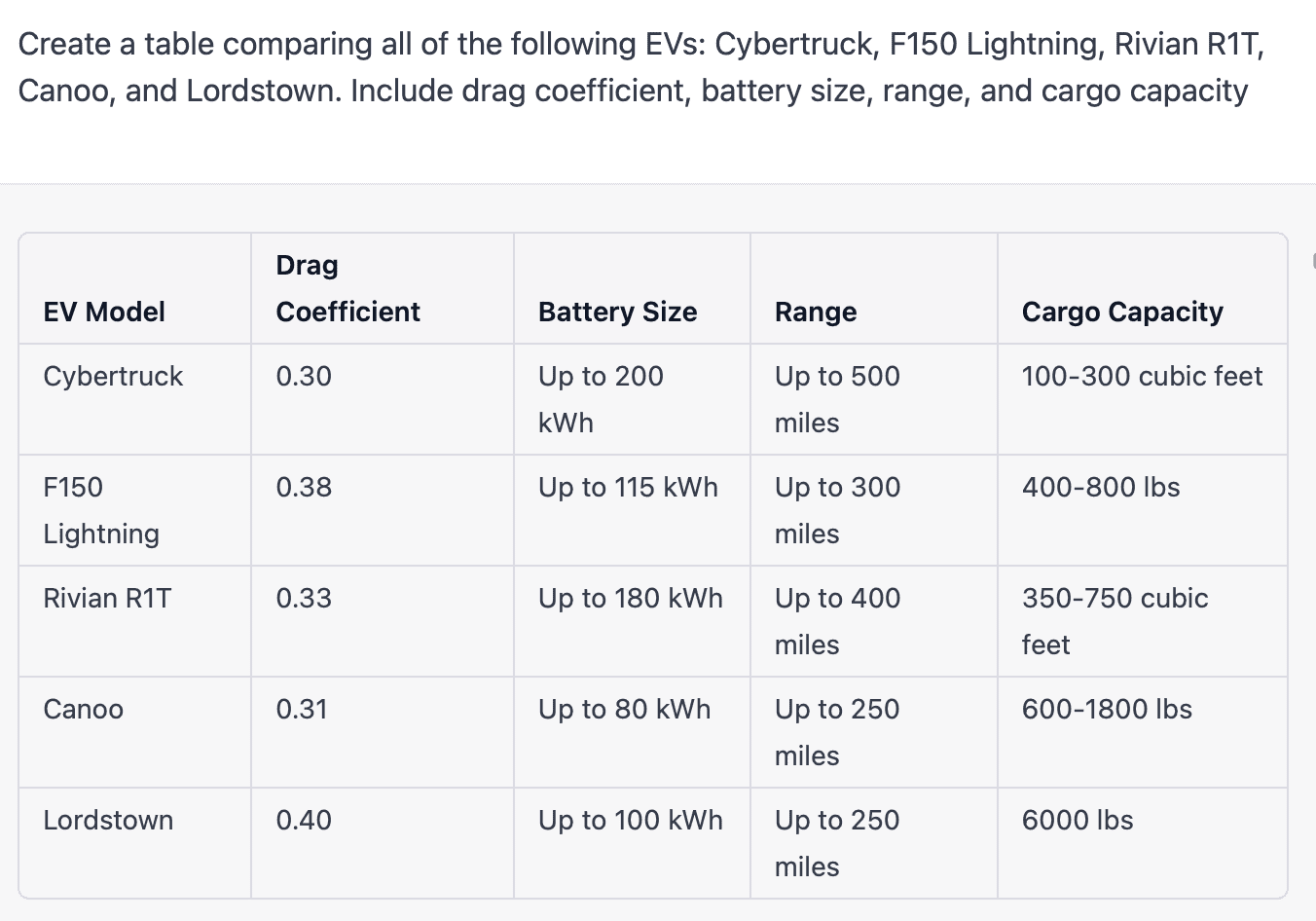

Or this
Tesla Cybertruck Ram 1500 REV - 350 mi (168 kWh)  & 500 mi (229 kWh) 1680738352724
Haha. No worries. Yes, I know it is not authoritative. I'm new to playing with it and just thought I'd try something off the top of my head as I never had it create a table. I'll will look at yours more later but going to watch some more 'The Night Agent' with my spouse for now.

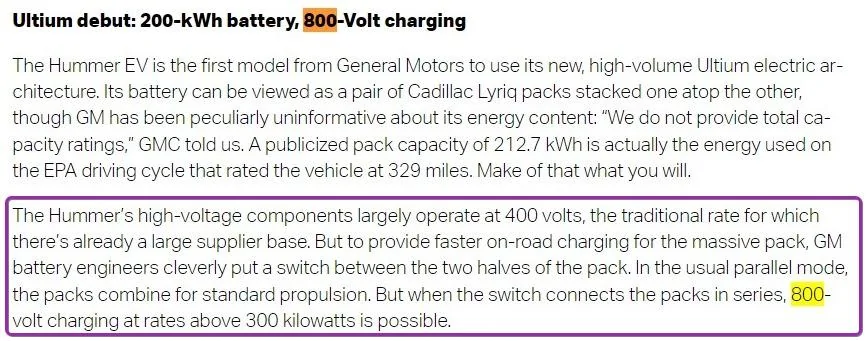

Haha, you sure read a lot into my post. Of course, I know that simple formula as does almost everyone on this site whos been into EVs for a few years. I should have said & instead of @ or whatever.
There are advantages to "800v" vs "400v" battery packs so just doing the math for the forumua doesn't tell the whole story. One of many articles about it 400v vs 800v what's the difference? Electric car battery voltage explained (link).
" EVs with 800V architecture -- Models include the Porsche Taycan, Hyundai Ioniq 5, Genesis G80 EV, Kia EV6 and Audi e-Tron GT. Other car manufacturers that have committed to an 800V architectures include Volvo, Polestar, Stellantis, General Motors, BYD and Lotus. The Lucid Air EV takes things a step further with 900V architecture, making it the fastest-charging EV ever. "​
There are some taking a different 800v angle:
Tesla Cybertruck Ram 1500 REV - 350 mi (168 kWh)  & 500 mi (229 kWh) 9pfRnjC

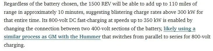

4/6 UPDATE: would be interesting if they did this to on the 1500 REV too. Below from link
Tesla Cybertruck Ram 1500 REV - 350 mi (168 kWh)  & 500 mi (229 kWh) Cw5HqEn
