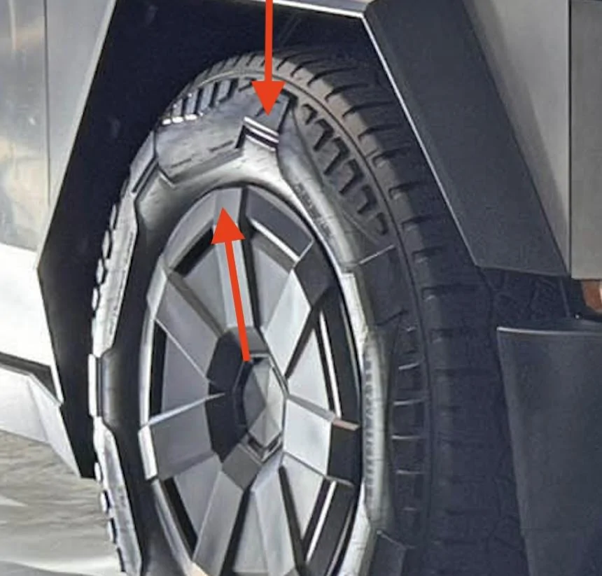

Watching the video, has anyone commented on the fact it looks like the rim has chips / damage at the top of each spoke? Is that from the aero covers? I'm kind of shocked he didn't mention that at all, or at least show if it's dirty vs chipped.
Edit- added pictures
Clamp marks from aero covers

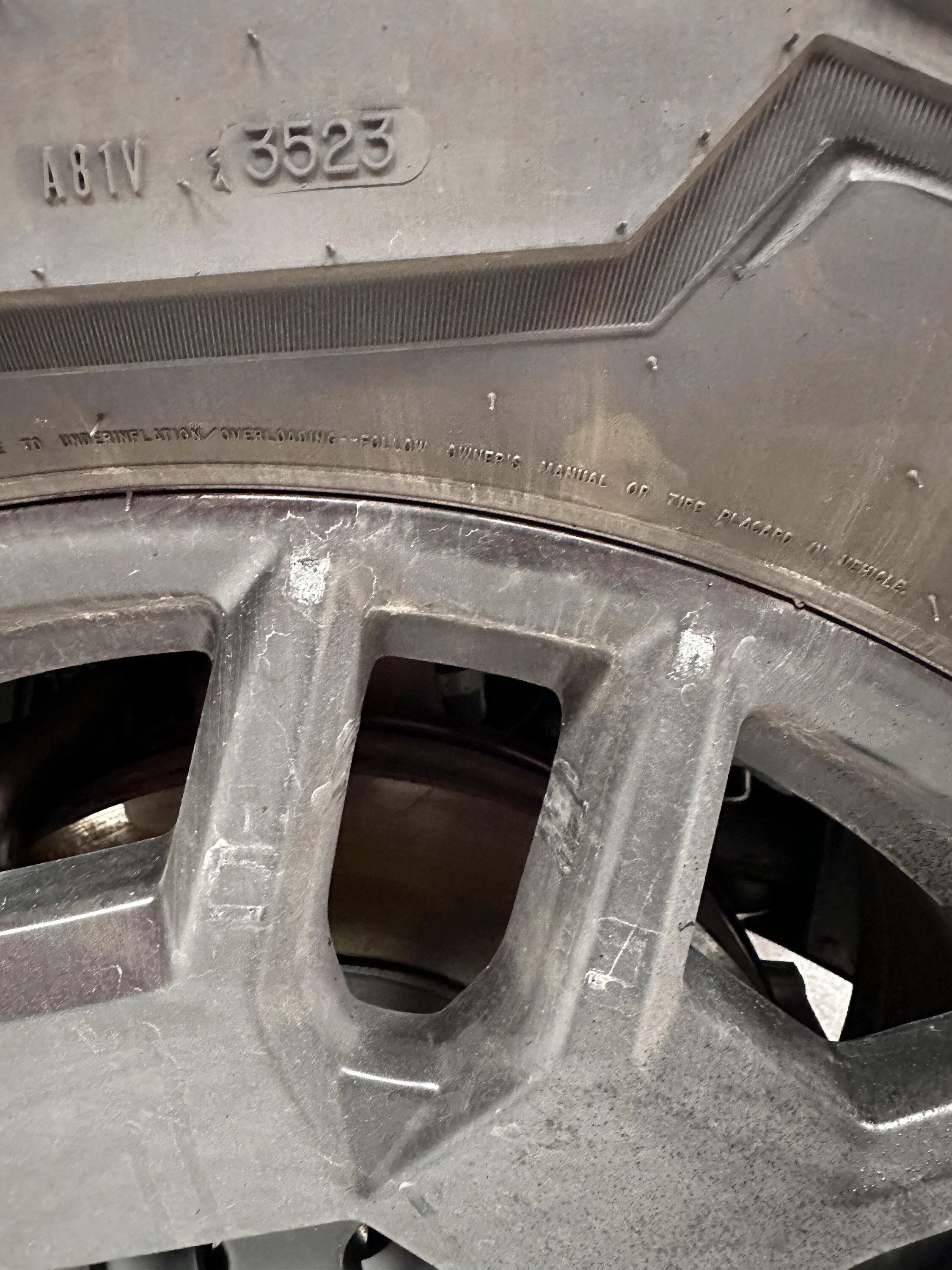

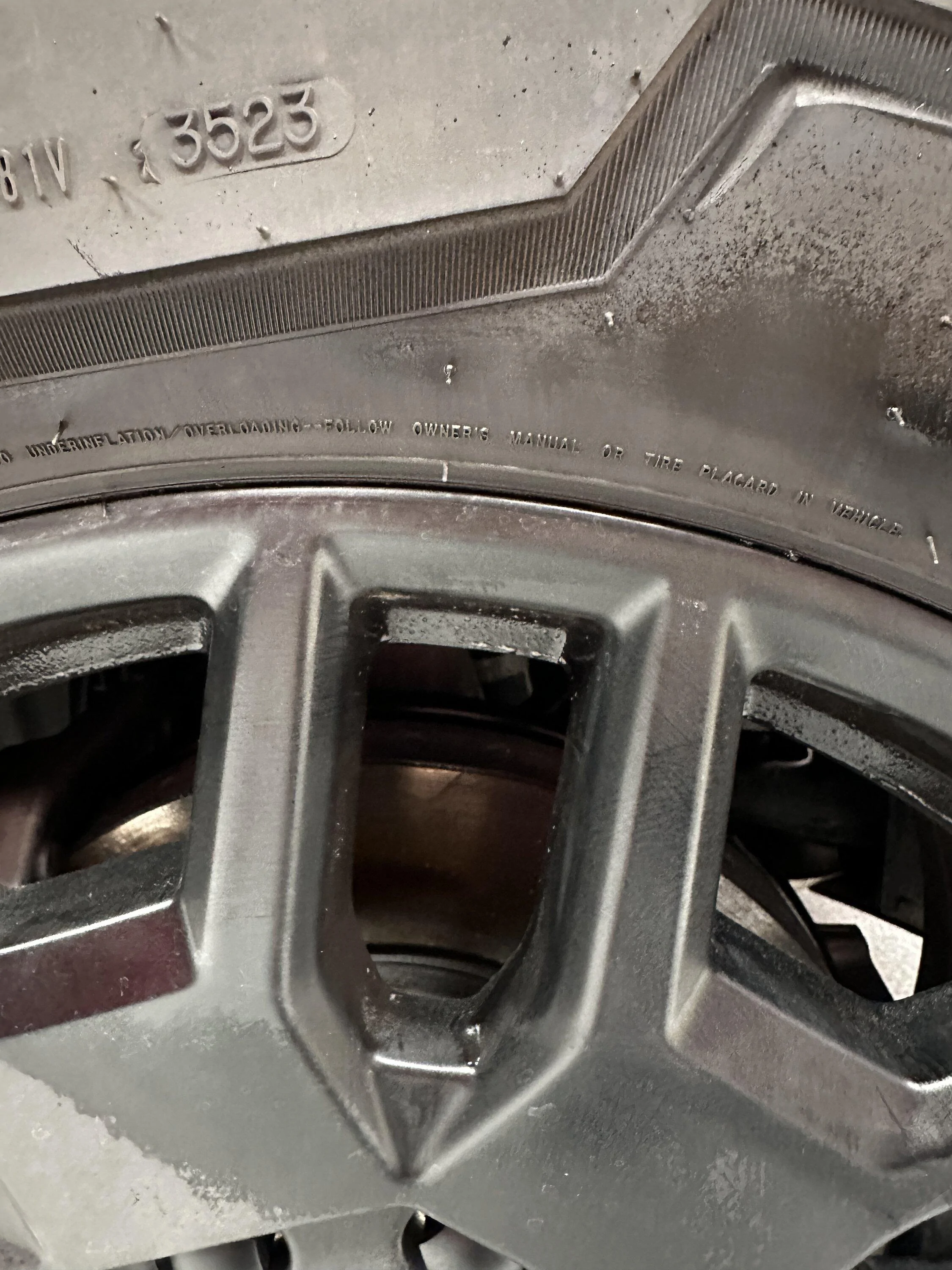

1 - Someone above mentioned 1/4" (.250); to be clear, no - we haven't seen anything deeper than .120" at this point - and nothing into the cords. We've had around 25 trucks come through, varying mileage, varying degee of scuffing (tire inflation and vehicle loading plays a factor too)
2 - Spoke damage from aero covers - It's mostly grime / dirt. Scuffed a bit?, sure. But not as bad as it looked here. Check the photos below, before/after wiping off the road grime. That said, aero covers scuffing/scratching the underlying wheel is nothing new, nor exclusive to Tesla. We see this on Rivians, and all prior Tesla models (3, Y, S). Aero covers are generally going to cause scuffs on the wheels if they are the press on / pull off design and the clamps go on spokes or the contact patch sits on the face of the spoke.
I'd take your covers off for now. Tesla will have a revised cover I am sure. Won't be a big deal moving forward - the issue is already contained to just the initial limited deliveries.

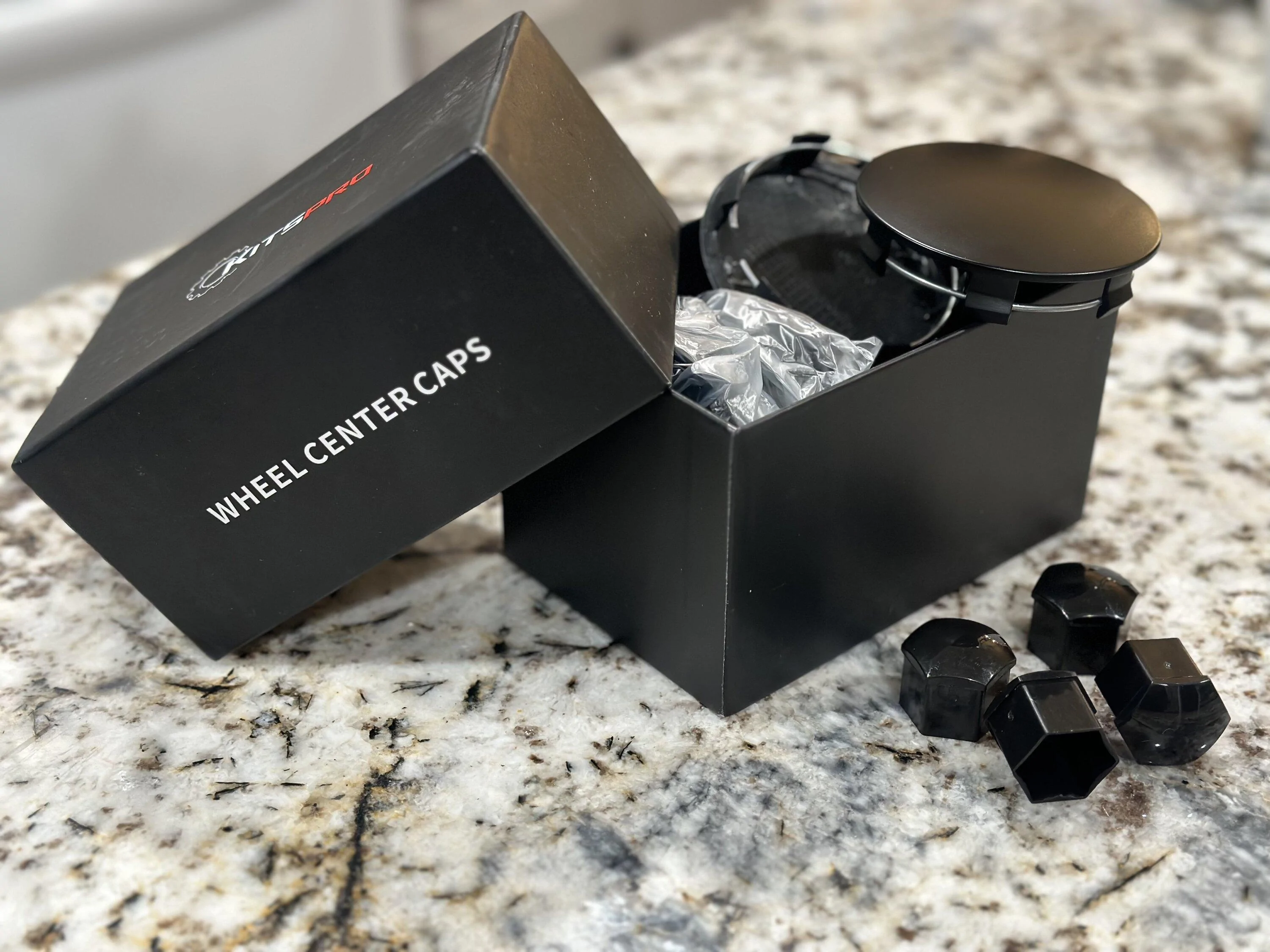

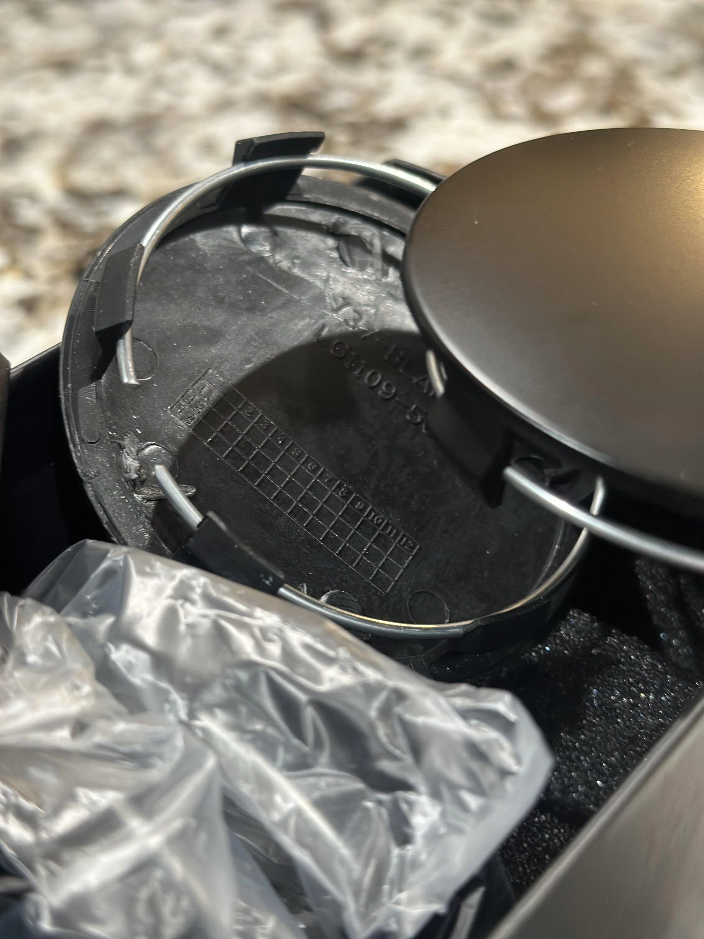

Although I’m nowhere near a delivery date (order placed 01/18), I don’t like the wheel covers WHATSOEVER, so I couldn’t help but order these and they came in today.
Tesla Cybertruck Update: Aero Wheel Cover Recall reason = making contact with tire sidewall, wearing down rubber IMG_7954
Tesla Cybertruck Update: Aero Wheel Cover Recall reason = making contact with tire sidewall, wearing down rubber IMG_7955
The center caps surprised me; although they’re plastic, they have a metal overlay. They look and feel great.
The lug covers are a hard, cheap feeling shiny plastic.
I may look into a flexible vinyl type I’ve used before.

Sure thing!
Yeah, the lug nut covers aren't perfect but they've stayed on so far and they come in a 24-pack. @Eddyrelik shared these in a different thread that might fit the matte aesthetic better but require buying two sets: https://www.amazon.com/gp/product/B071PD23MW/

Really appreciate this, definitely clears up that it's not as bad as it looked. Given that you have experience seeing cover wear on other vehicles, and the Cybertruck has some at 2k miles, do you anticipate then it's on par with the others, and would still be acceptable after 10k, 25k, 50k, etc.? I've never owned a vehicle with covers/caps personally.
