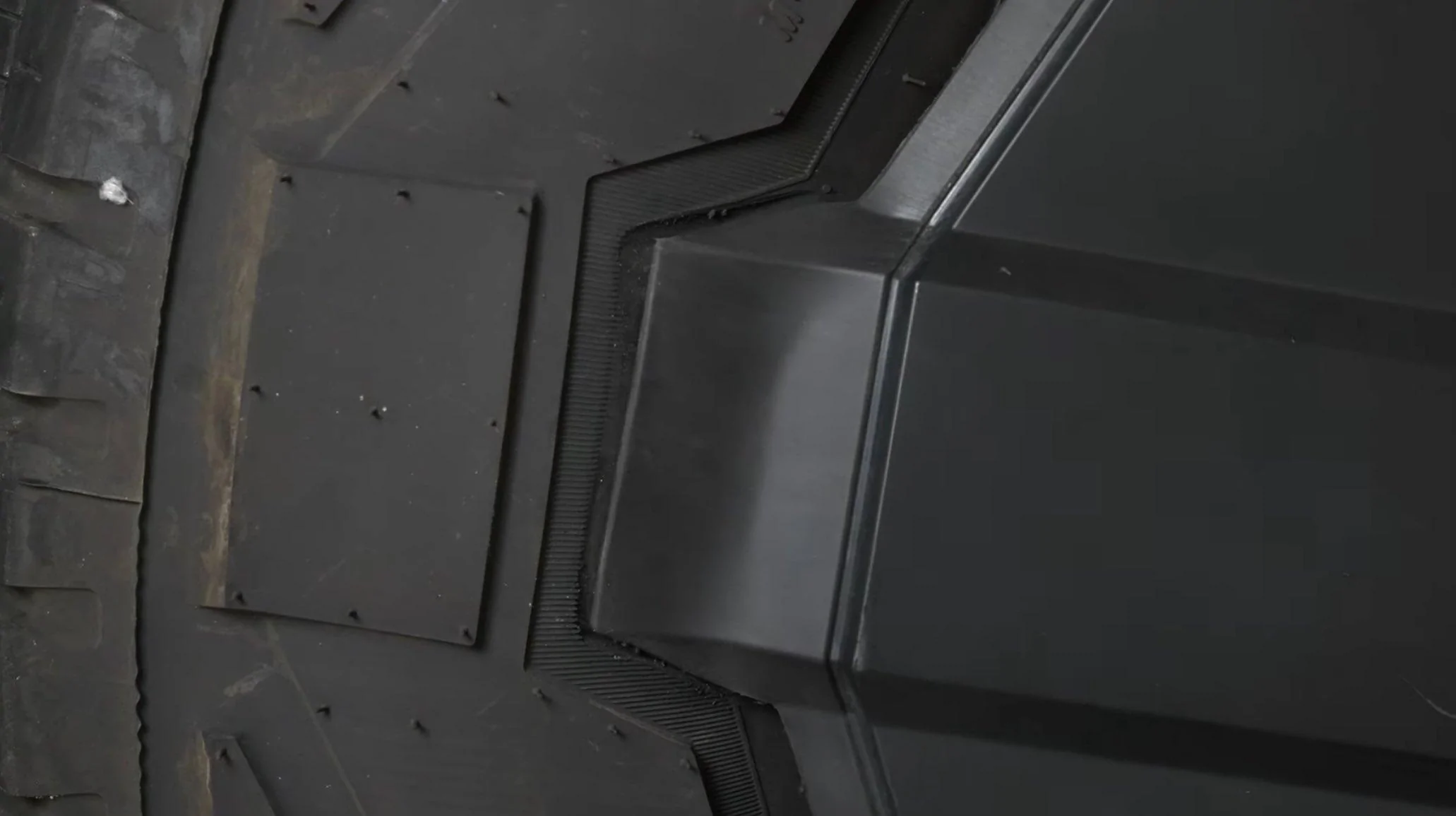

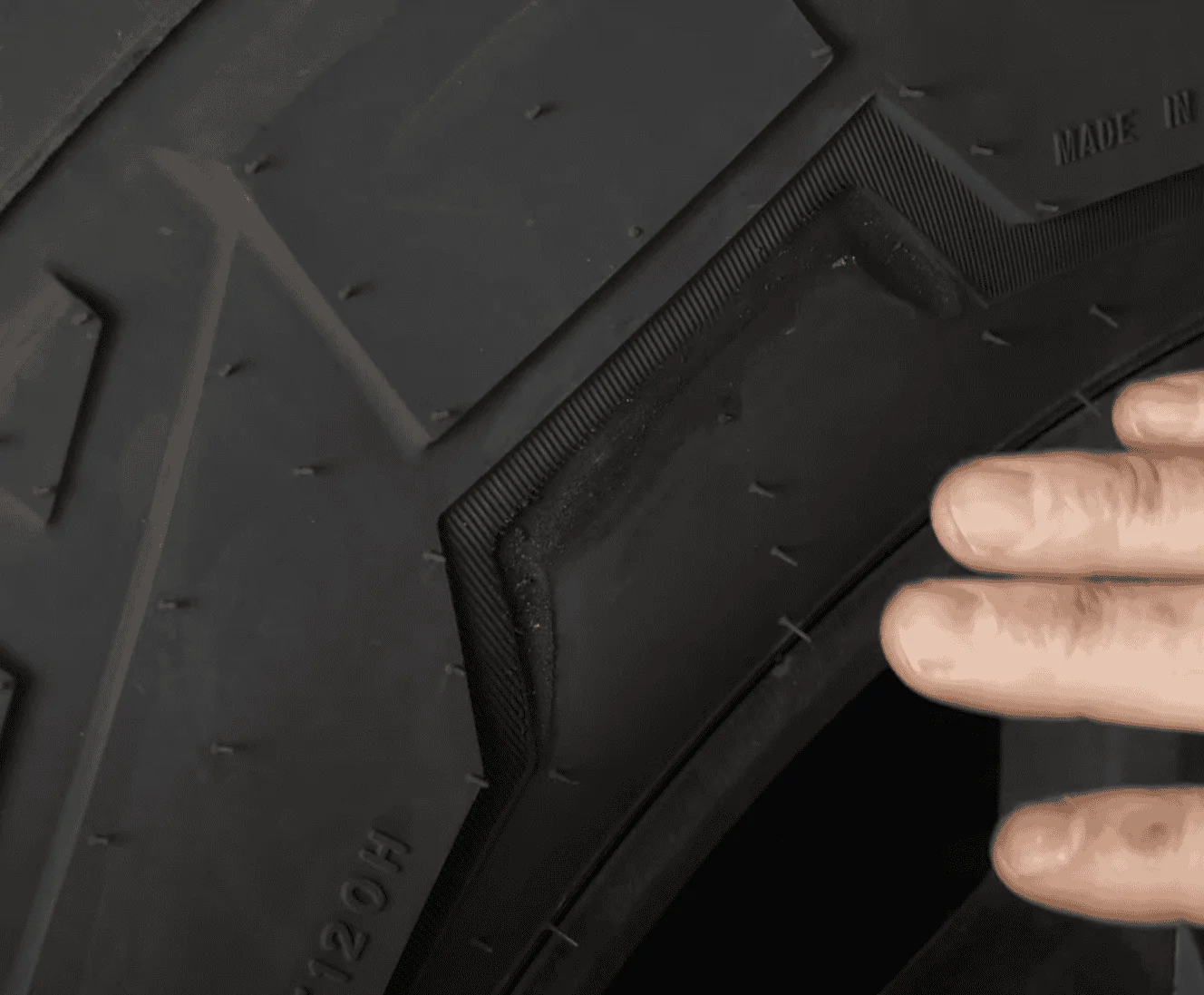

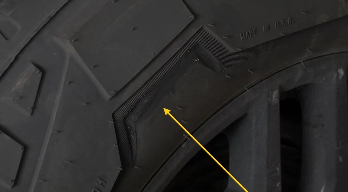

Probably why they are not coming with recent deliveries.
Wheel cap tips rubbing tire, wearing it down.
Cybertrucks wheel caps are being recalled, and if you have a Cybertruck currently with them installed, I’d advise removing them till a new iteration is released sometime in March.
The reason being, the rubber end tips of the cap are making direct contact with the sidewall of the tire as it bulges on the contact patch; thus wearing it down. Tesla is currently in the process of redesigning the rubber end tips so they do not come in contact with the tire as it rotates. That’s why some owners have been taking delivery of their CT’s without them.

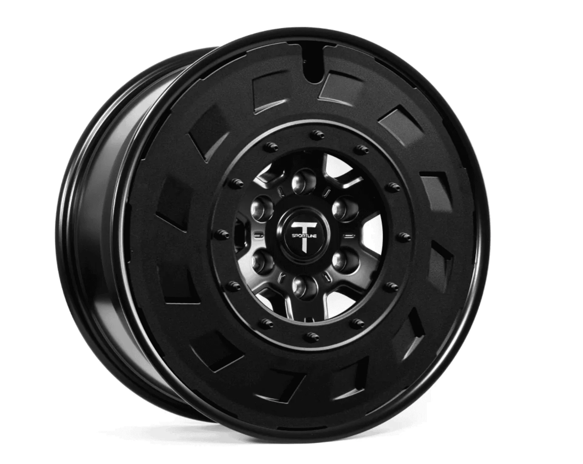

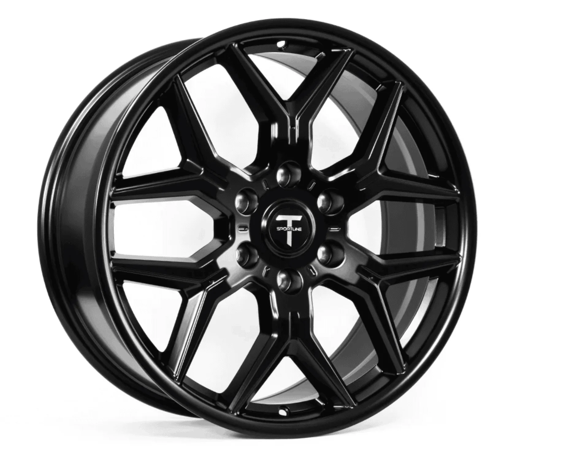

To limit wind drag, can't they design a flat insert installed from inside the wheel?!??
Our aero covers fit inside the wheel, not over the tires:
